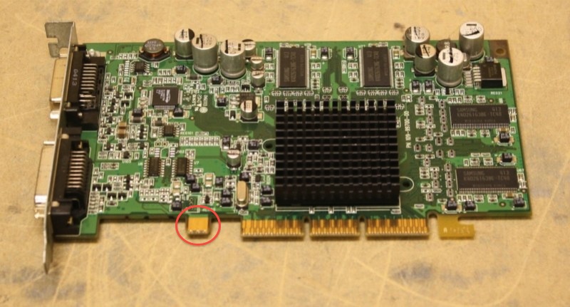

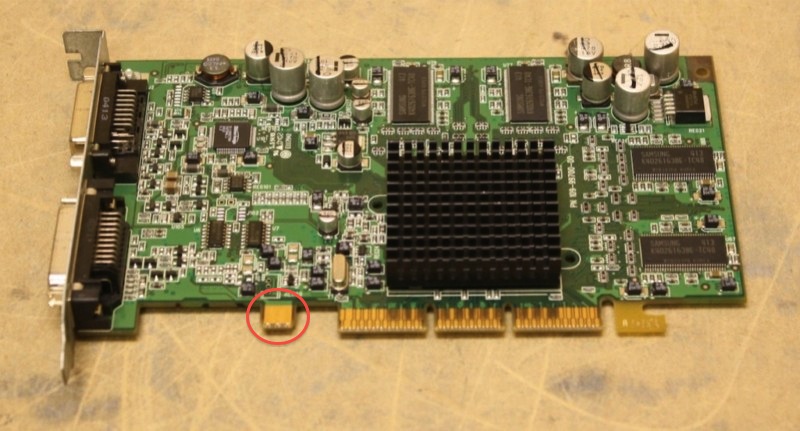

In the picture below I highlighted the extra leg in red on an PowerMac G4 ADC card:

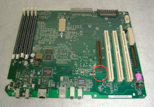

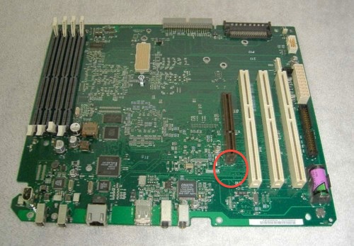

In the picture below is a Sawtooth logicboard and it is missing this extra slot:
