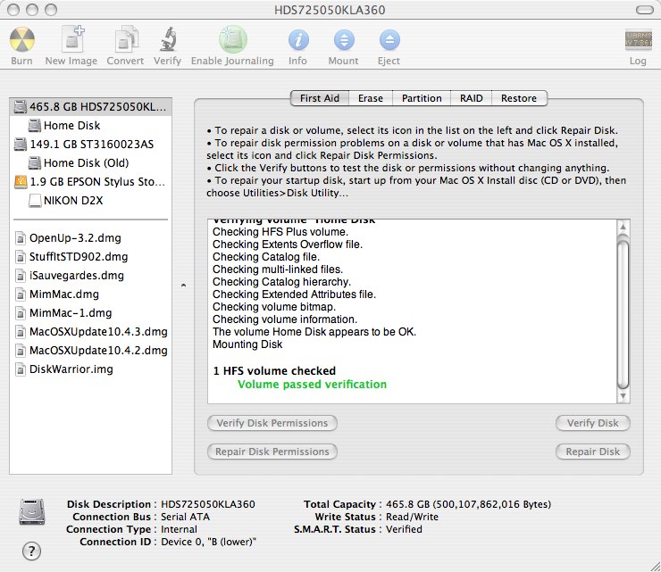

thats a big HDD you have there -
if none of the normal stuff has not worked then yes try re-installing the OS on it.
nothing to do with the size i wonder ? mmm
i will look it up on apples support site

God, i love macrumors.
But I feel like the solution is so simple and so close, as the drive appears to be OK. Reinstalling the OS is my last resort here.
Edit: I've been using this HD flawlessly for the past few months. I don't think the size should be an issue...
