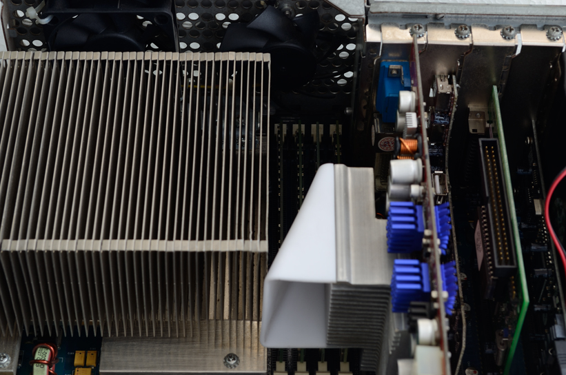

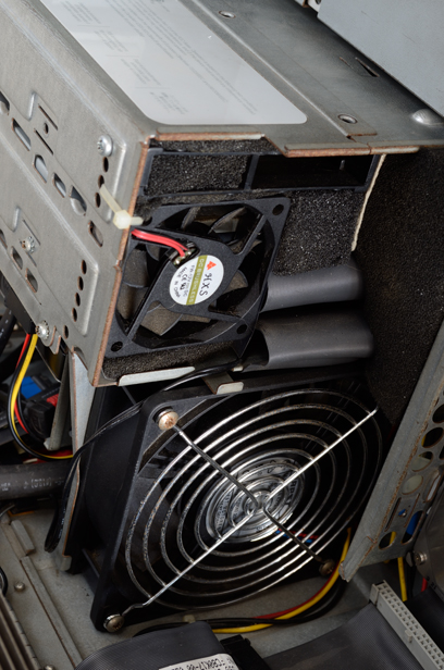

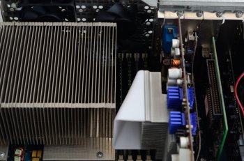

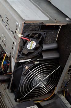

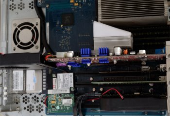

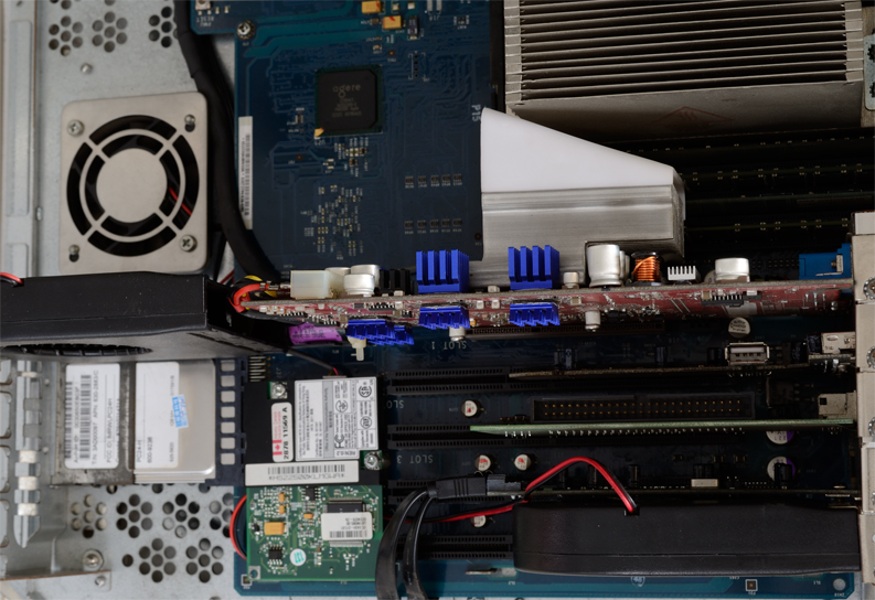

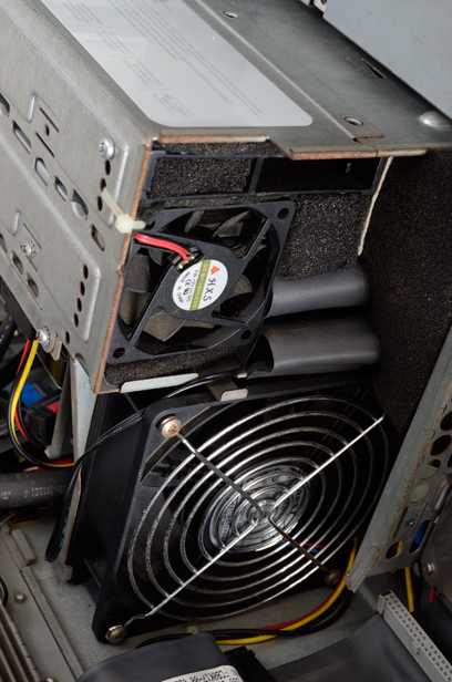

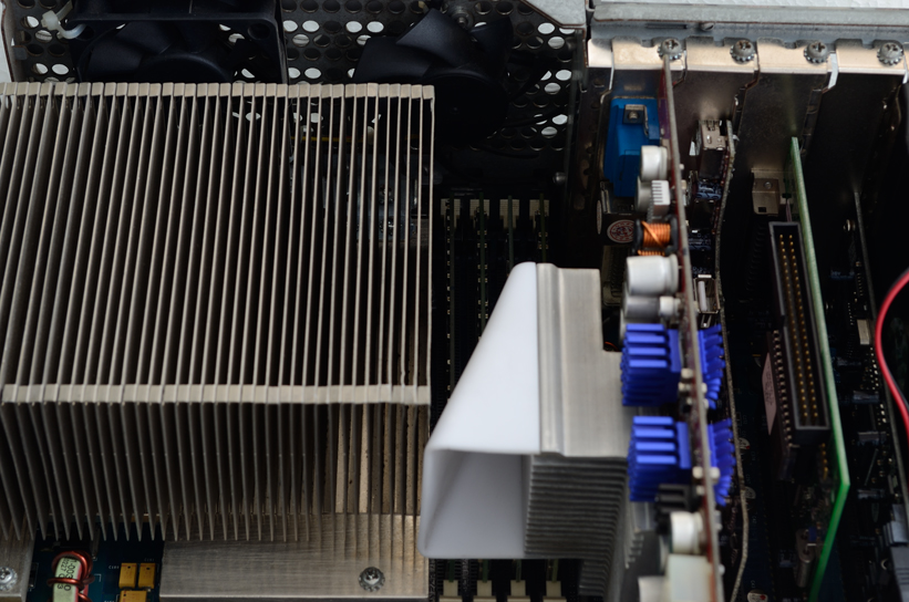

Because the AGP slot is right over the CPU heat sink. And the optical drives cage made it lack of enough space to install a decent GPU cooler. After it killed a Radeon 9800 Pro (already equipped with a Vantec ICEBERQ 4). I figured I had to do some mod since video cards for it were discontinued and would be tough to find.

Hehe, actually MDDs have another nick name: video card killer.

I don't know if the 4Ti need a better cooler in the MDD.
But I've seen people remove the optical drive cage to make space
for a huge cooler like Arctic-Cooling's VGA Silencer.
