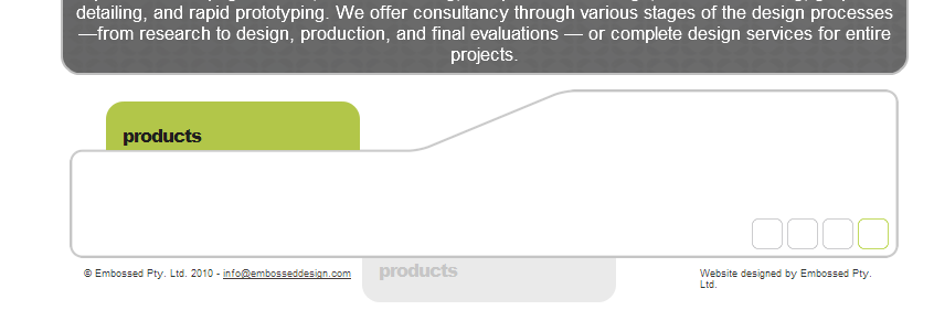

Well, here's one solution, though i don't know the best way to implement it in iWeb as I hate it, but most of it deals with adjusting the z-index of the various pieces, which determine the stack layering. I'm attahcing the resulting effect.
  1. Set the top Products tab to a z-index of 2, and also set all those little square buttons to 2 as well.
  2. The big png is already set at z-index of 1.
  3. For the bottom Products tab, set it to z-index of 0.
  4. Lastly, set the height of the top Products tab to 44px (currently 65). This will make seem like it's under the png.
Again, not sure how to tell iWeb to change the z-index level, and I'm not at my Mac to look around.

"Lastly, set the height of the top Products tab to 44px (currently 65). This will make seem like it's under the png."
would you mind expanding on this method, i still dont quite understand how the CSS button will appear to be under the big grey border PNG is it is set to be at the front..
thanks alot
It trims the height of the button, cropping off the bottom portion so it fits flush with the png. This will make it look just like the screen shot I provided. In that screen shot the Products tab is the front most item. So think of adjusting the height as cropping it, so you no longer see the curved border at the bottom of it.
