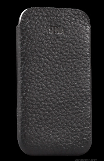

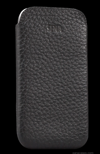

Or, possibly, try this...
What if my phone is not in my pocket but just in the dark?
