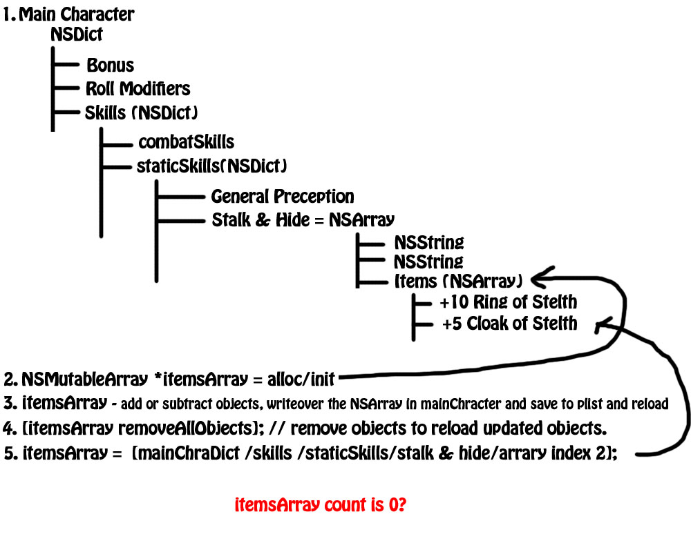

I had a problem this weekend with removing items from a NSMutableDict and reloading items to it. The count was 0 after the reload. I created a image to help better explain. I think my problem is with pointers.
To make things easier to get to I create a new Array in step 2 and go through the mainChracterDict to get to the itemsArray. The users adds and subtracts things from this array and then presses a button to save the current state to a plist and reload data. This replaces the items in the mainCharDict and reloads (refreshes) the mainCharDict.
But when I go to refresh the itemsArray I first say removeAllObjects so I won't add duplicates to the array in other indexes and then do step 4 by reassigning the refreshed items. But my count is now 0 in the itemsArray?
I think because I am working with pointers I am removing the items from the original array since my second array (itemsArray) is just pointing to the objects already in memory? So when I reload the count is 0.

That makes total scenes and I get that. 2 pointers that point to the same object. Like when I bought my new car with 2 car keys. So when the wife uses the car she changes the seat position, radio station. Then when I access the car those settings have been changed.
So that explains my original problem with the image I showed up top. I tried to create a shortcut to an array that was deep inside an NSMutableDict. So when I removed the objects from myShortCutArray it removed the objects from the array that was in the NSMutableDict.
It sounds like if I want to do it this way I need to make a mutableCopy of those objects to work with in a new array. When I am finished working with the copy then just replace the array in my NSMutableDict with the copy that I was working with.
