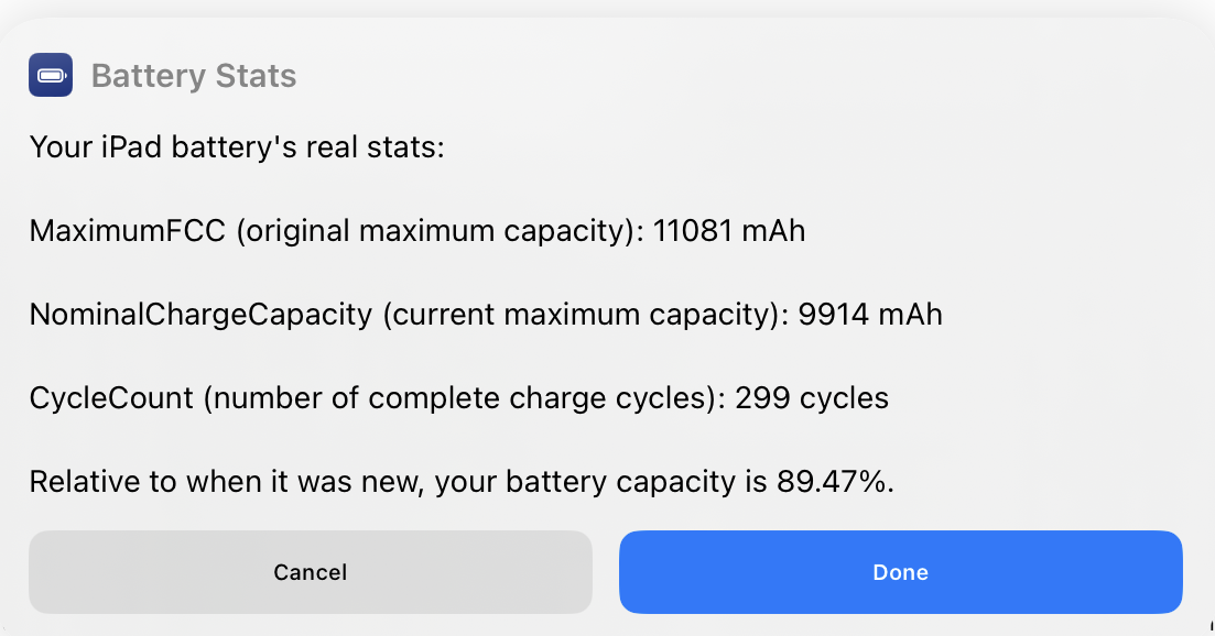

There's my iPad Pro 5th Gen stats from launch day 2021.
Reactions: dawnrazor

92%, decent. Do you have the stats for your 10.5-inch iPad Pro?
Ohhh lord. No, but I'll have to check. That one isn't faring so well. :X
My iPad Mini 5 is at 92.3%, but a few years ago, I did a warranty claim and they sent a refurb, so that was back to 100% again.
