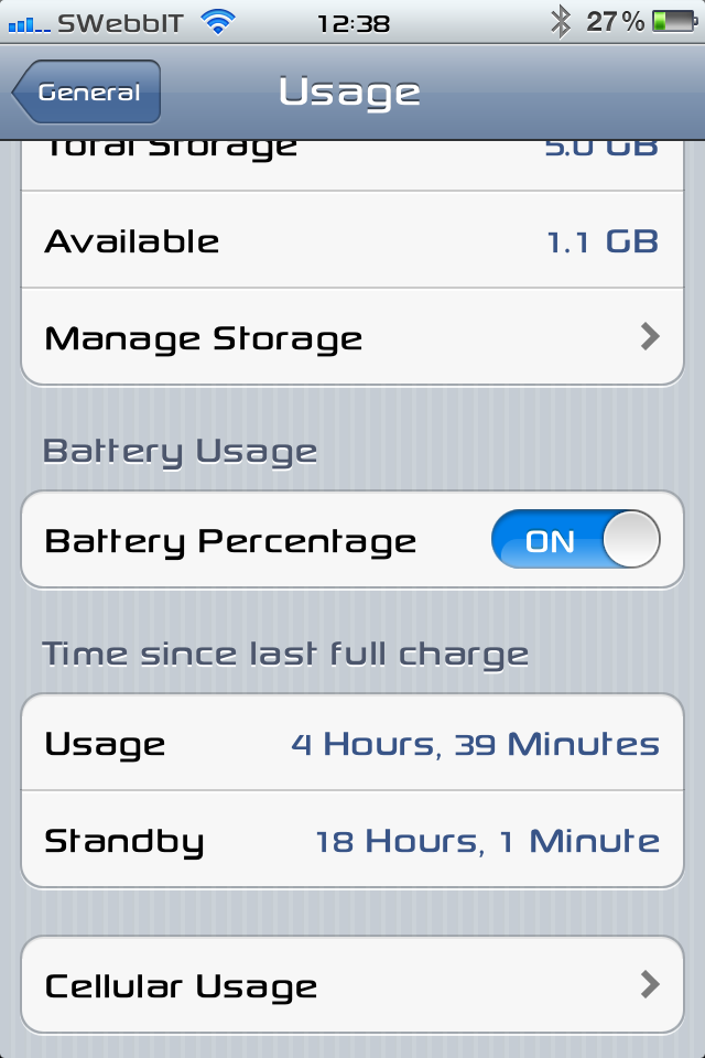

I've been testing this for the last 3 or 4 days and its improved my battery life so i thought id share this with you guys.
It looks like looks like the "Setting Time Zone" Location Service has a bug in it which cause it to be active all the time. Once i disabled this my battery life improved
Settings
Location Services
System Services
Setting Time Zone
Turn off.
I have every other services on and my current usage is.

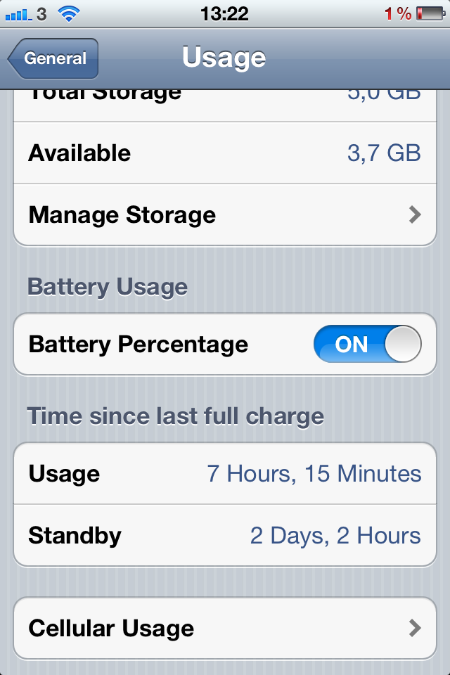

I turned mine off a while back and it helped alot. I also turned off the raise to speak option in SIRI.
5.0.1 with everything else on. E-mail push, wifi, 3G
