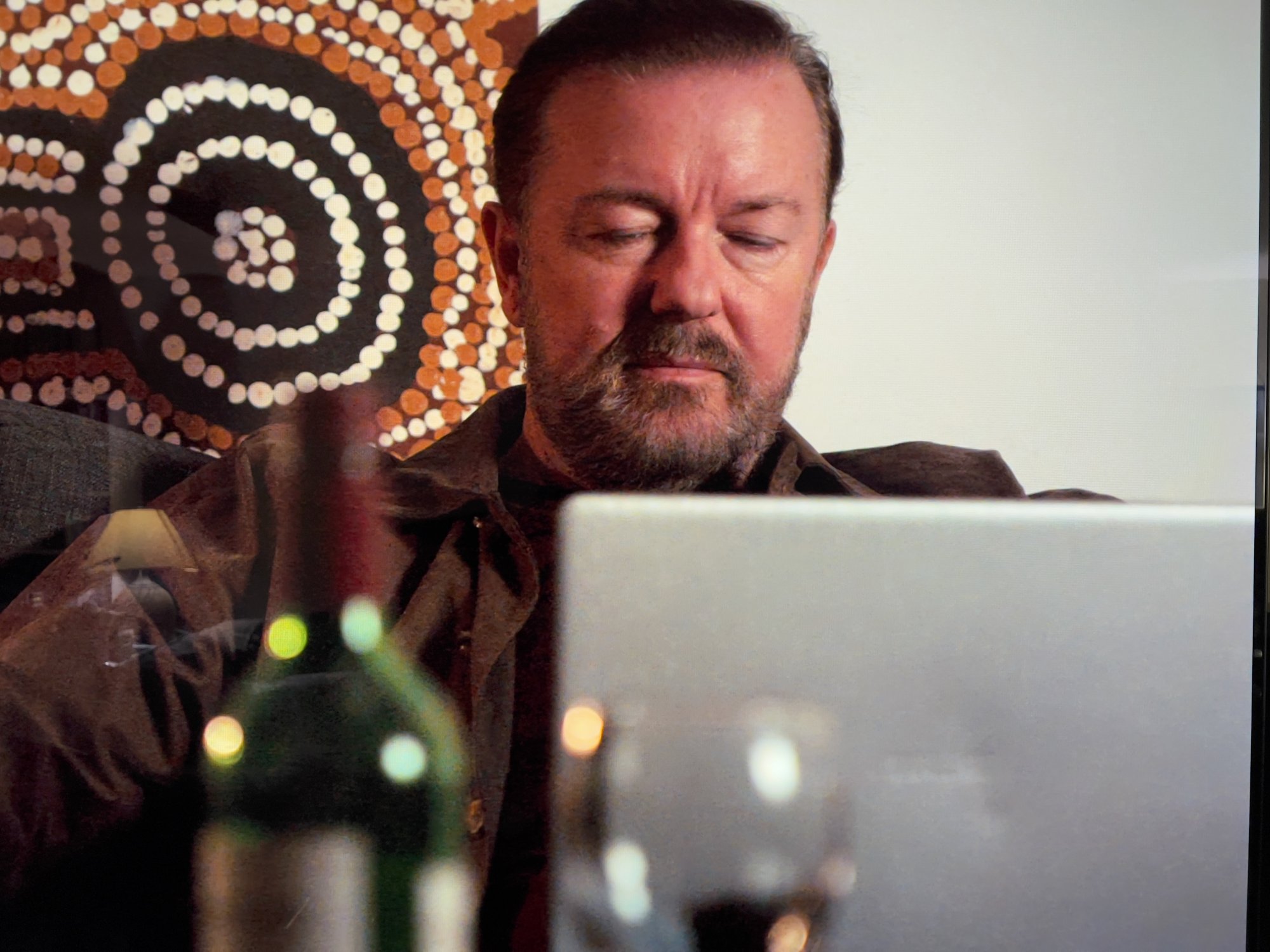

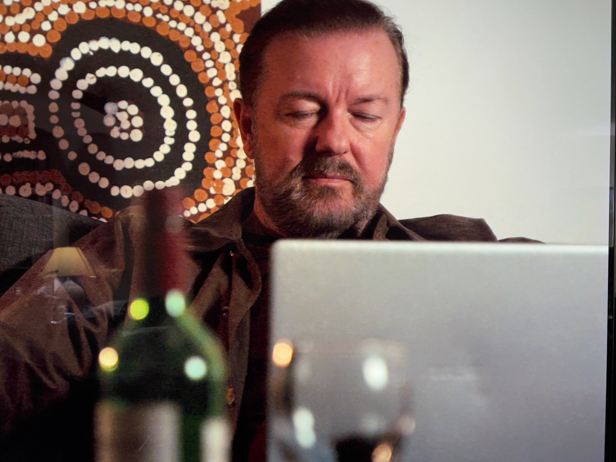

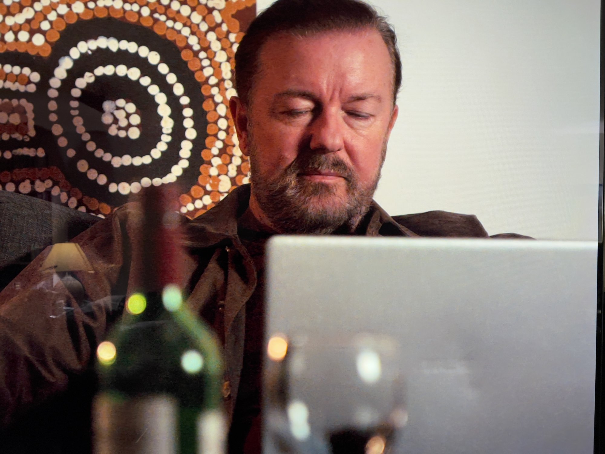

Here's another example of how bad the output from the Apple TV 4K box is, when compared with the same sequence played from the native TV app. In this case it's the last sequence at the end of season 3, ep5 of After Life on Netflix, at about the 25'12" mark:
I've deliberately framed the bottom corner of the image and used a brighter exposure than normal to highlight the difference. Both are using identical Dolby Vision Dark picture settings, but the noise on the ATV version is shocking, particularly on the transition as it pans left from behind the sofa.
No amount of switching off/settings reset/HDMI checks etc make any difference.

I'm not seeing it on my Apple TV 4K-2:

That's good to know, thanks.
It's definitely something specific to the Panasonic GX800 TV. I've since tried my ATV 4K box on a different model of TV and the output is fine, similar to what you have shown.
I've gone back to Panasonic and they're allegedly now looking into it and will hopefully get back to me.
Your clip looks like 8-bit video at low bitrate.
Yup. That's why it's so weird. Both are playing full bitrate 2160P. Hard-wired into the router with a solid 74Mbps download speed according to the Netflix network check tool.
The extreme pixellation only occurs on dark parts of the frame, mainly on Netflix and Disney+ content. Brighter content looks OK. It's actually not as bad on higher bit-rate content such as iTunes movies, they play OK in Dolby Vision.
It's some kind of incompatibility with the codec Netflix uses and my model of TV I reckon.
