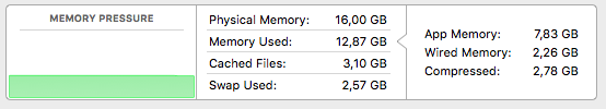

As for RAM: which numbers should I look at in "Activity monitor" to figure out if insufficient memory is/is part of the problem?
It's got 350GB (out of 500GB) unused disk space, so that can't be the issue.
- The memory pressure graph. It should be all green under normal use.

As for Activity monitor's memory pressure graph: mine's green like yours, so it appears most likely to be something with the hard drive. Are my symptoms typical of those for a damaged SATA cable, or is it hard to tell as they could be the same as for a soon to be failing hard drive as well?
- Indeed. Upgrading RAM is unlikely to do all that much for you, but will still be beneficial, I would say.
