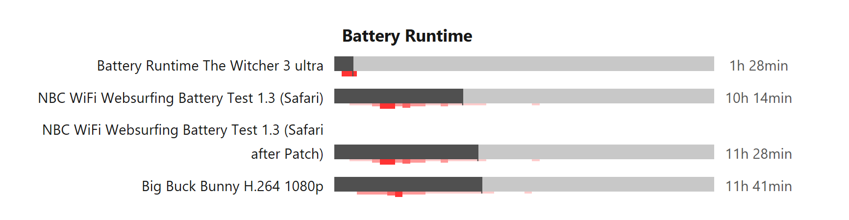

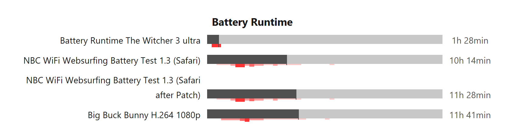

Independant testing (this is notebookcheck.net but I've seen others) show pretty much 10 hours or more in various tests, including browser tests. I think there may be some background process going on, or the unlikely scenario that there is a problem with OP's machine.
This machine actually has decent battery life (unlike the 13" TBP 🙁).
Exactly the point I was making. Notebook Check shows you can achieve 10 hours of web surfing NBC in Safari at around 50% brighness. I am pretty sure that is not how most people spend the day using their laptops. I find those kinds of tests rather useless 🙂
