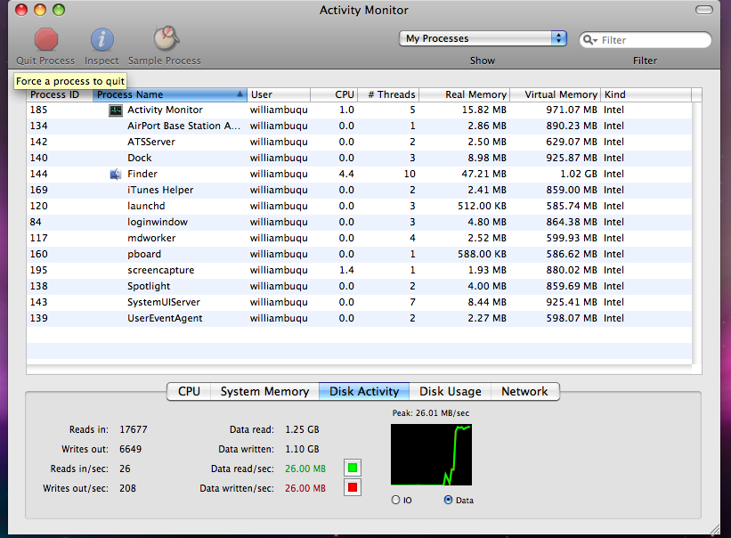

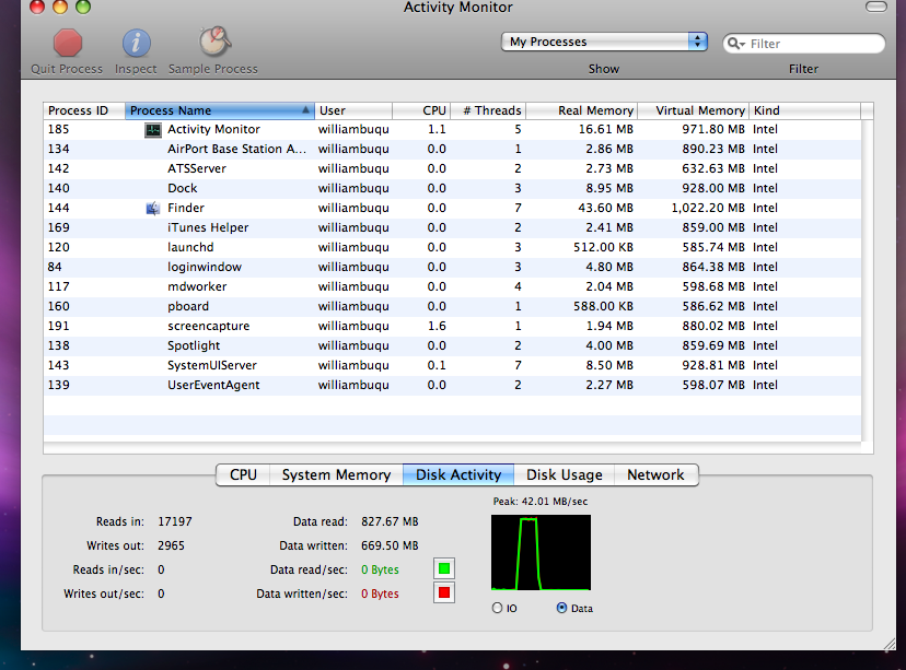

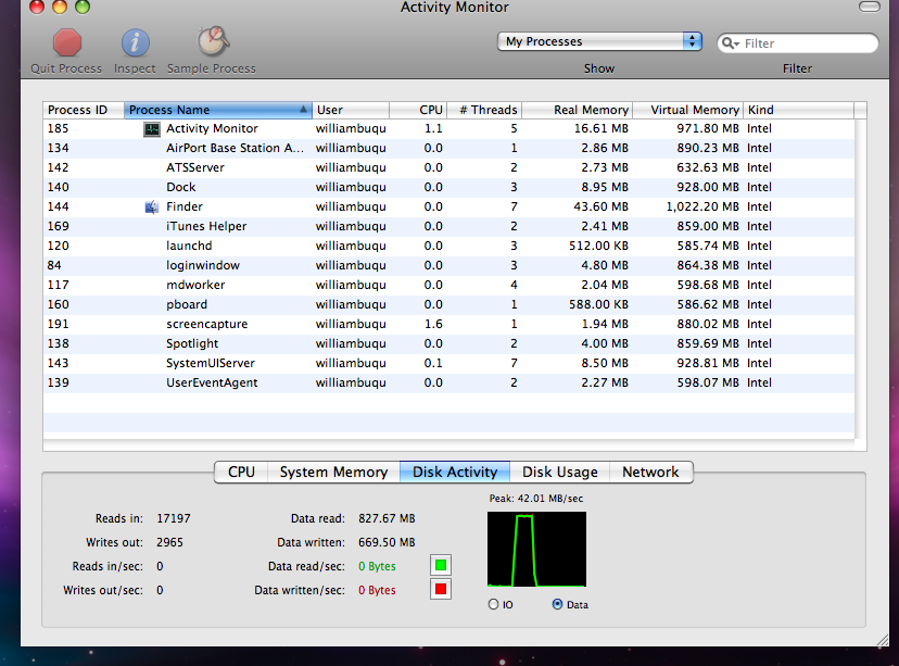

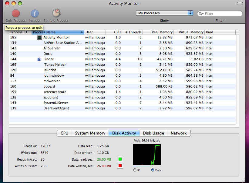

Update: Just tried 2 on each hub, and got a performance of 33MB/s write from my internal HDD, and 45MB/s read from the USB raid to the internal HDD. not so bad I guess. It feels alot peppier now that I moved across the 2 diff hubs.
Back on 1 hub with all 4 sticks, and performance is Read from RAID 42MB/s and write is 26MB/s. so minimally faster on the read, and definitely faster on the write. What can I expect if I run 4 more sticks on the other hub?

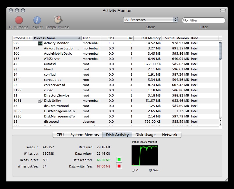

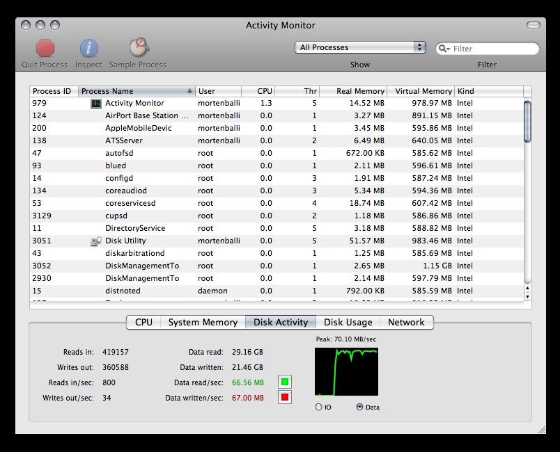

The new sticks haven't arrived yet, but i tried the 6 I have with another setup on the busses. I have now reached 70 MB/s! I personally haven't seen anything faster on usb 🙂 Anyways boys (and girls?), beat this:

Update: 75 MB/s from USB Memory Sticks
I've received enough sticks from A-data to perform a test with 8x8 GB in raid0. The sticks are PD7 200x 8 GB. They are mounted via two Trust HU-5770 USB Hubs each connected to one separate USB bus on my iMac.
It's getting more difficult to benchmark this because the raid is so fast that the disk I'm writing to is the bottleneck, so I tried to playback a HD 1080 uncompressed TGA sequence form the raid using Framecycler.
The results are promising. 75 MB/s! 🙂 That's possibly the most data pulled through usb on an iMac ever! Write is about 50 MB/s. To compare that, playing back the same sequence from a 2 TB Raid0 running on the FW800 port gives me about 53 MB/s read speed, wich means that the flash raid is about 41% faster!!! Not bad 😎
