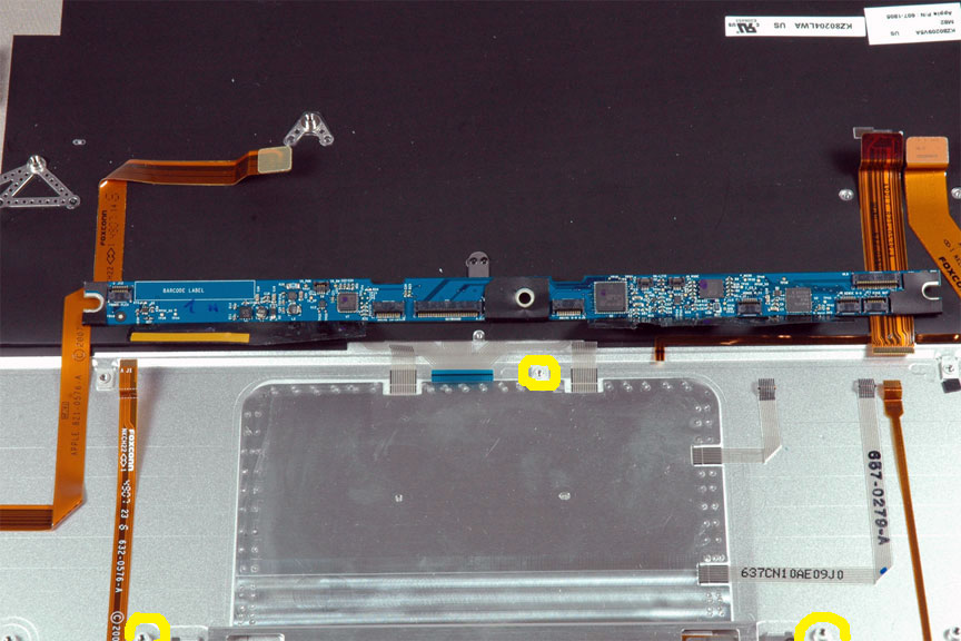

These are not screws? See yellow. [photo credit: ifixit]
Have not seen MBA inside but the fix works with PowerBook or MBP.

Good idea to be talking about an MBA when you are...
It is a good idea to be talking about an MBA when you are talking about an MBA!!!! NO SCREWS holding the trackpad, sheeess!!
