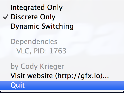

Not true... Quit VLC media player or any other applications that are dependent on the discrete graphics.. Once closed use gfxCardStatus to set it to intergrated and from then on it'll work..
If something is open you'll see it in that list, just quit it and change it.. As an example..
