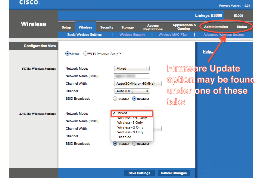

Check whether the router has wireless N, as well as G and B enabled at the same time. Check for firmware updates to your router.
I'm not sure where in D-Link router settings it is but it should look like this: (Just type in http://192.168.1.1 into your browser address bar and that should take you to your router settings menu.)
