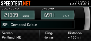

I have a Linksys wrt 150N wireless router that is about a year old. My Rev B MBA is not performing with the speed I had anticipated moving to Wireless N. I was working with Linksys tech support yesterday and pretty much exhausted all options to get speed and range acceptable. I have Comcast cable and my iMac is seeing download speeds shown below hardwired directly into the router:
Using my MBA right next to the router I am barely getting 10% of that throughput. Before I replace the router I was considering a Time Capsule instead of a straight router. Is there anything I can do on the MBA side to remedy this? Is anyone using Time Capsule and getting good results?
One final note I did re flash the firmware on the router and when I reset the router on the first try I get very good speed (14,000KBPS) and thereafter it drops back down to 1200KBPS or so. I am thinking the router is the problem not the Air, but if anyone out there has any suggestions I would appreciate it.
