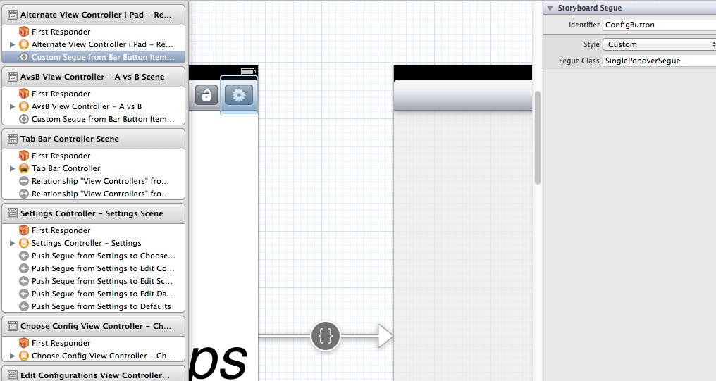

A little more background. I'm not entirely sure popover segues work, and I couldn't find a simple way of doing a popover segue that would operate in the way I needed it to without building a custom UIStoryboardSegue subclass. This subclass doesn't do a lot, really, except REUSE your popover controller AND allow toggling.
Given that it became a custom subclass, I also couldn't get any custom information into it from the storyboard, so I put that code into the prepareForSegue: handler in the view controller.
This is what it looks like in Xcode:
What that picture shows is a custom segue going from a bar button item to a navigation controller. It's a navigation controller because there's a sequence of table view controllers under that popover, but it can be any subclass of UIViewController.
Here's the code:

So you can see from the code in prepareForSegue: that I can't get enough information into the segue in IB, so I have to do it here. In particular, I can't get (or find) the "source" element, the place from which the popover originates, which is an important aspect of a UIPopoverController.
