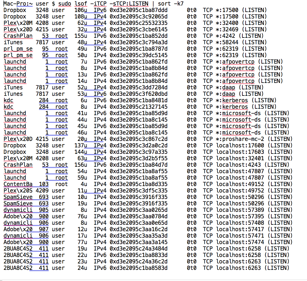

Try opening up a terminal window and typing:
sudo lsof -iTCP -sTCP:LISTEN | sort -k7
If you see a match in the node name this will the give you the PID which you can look up in activity monitor.
Here is an example:
Reactions: aplnub
