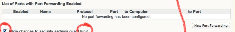

I'm not familiar with that router, but in the second photo it says "No port forwarding has been enabled". Instead of trying the UPnP setup, try creating a new port forwarding to see if that will fix your problem.

I think checking the box that says "Allow changes to security settings over UPnP" still doesn't forward the port in the first place: it would just accept the incoming connection without question. Again, I'm not familiar with the modem, but that's my interpretation.
As far as you manually setting the port forwarding, your photo states otherwise. I'm suggesting forwarding the ports here:

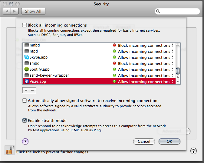

I thought for sure that would fix it. The only other thing I can think of is to check that it isn't being block by your mac's firewall.
System Prefs>Security>Firewall tab
If Transmission shows block all incoming connections click it to accept and hopefully that will fix it.

The native firewall isn't enabled. I see no point in it!

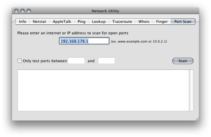

Have you tried a Port Scan? Are you using IPv6 for anything? If not turn it off on your Mac.
Port Scan states that the TCP for 53558 is open, when I make it scan my IP (192.168.178.33) for open ports.
However, when I scan (192.168.178.1) the router, it doesn't even find the the port. I'm not sure if that plays any role though.

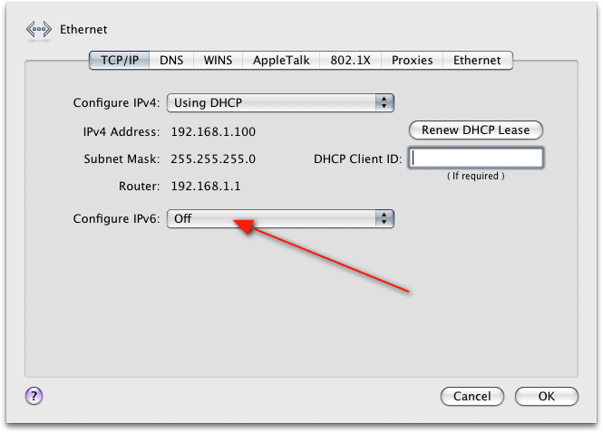

How can I disable IPv6 on my mac without having to shut it down on the router?
You can turn it off on the mac without having to shut it down on the router. Don't know if this will help but it doesn't hurt to try. You can allways turn it on again.
