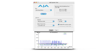

To benchmark your HDD write and read speed use Aja System Test or XBench.
AJA System Test
