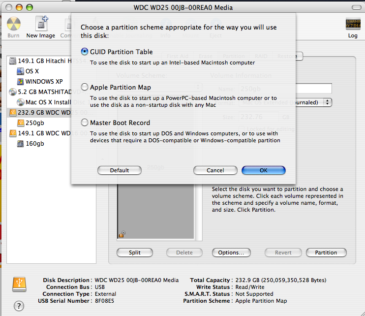

okay I seem to be having an issue (getting an error)
first: I erase the hard drive
after that I click on "partition tab" and click options and select GUID:
then it looks like it's working but then I get this error:
any ideas what I may be doing incorrectly?
thanks again for the help!
Hopefully the disk isn't wrecked. 😱
Maybe try formatting it with the OS 9 driver box unchecked.

okay i'll try - now do I need to erase it first - then click partition and repartition it to 1 partition with GUID selected? is there a way to select the GUID selection first? because it always seems to format to Apple Partition Map..
the disk should be fine - it runs otherwise perfectly...
yeah - same error? any ideas? I clicked for the hell of it "master boot record" and that partition fine - so does the apple partition map....just the GUID one does not? Could it be that it is currently plugged in via USB (I lost my firewire cable...)?
