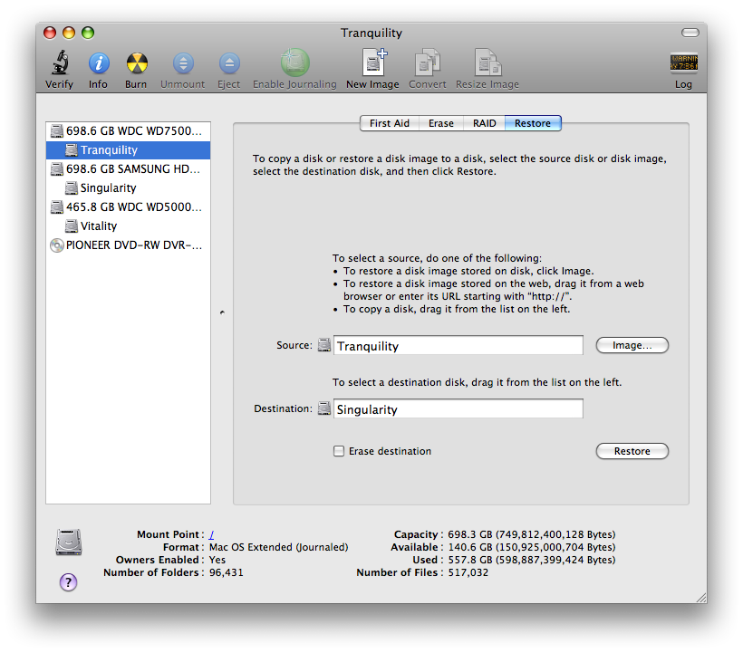

I'd suggest using Disk Utility to duplicate the drive - it's very easy and no additional software is needed. As you can see in the picture below, I've set Disk Utility to 'Restore' one drive to another. This will clone it exactly as it is to that other drive. 🙂
  • Source:destination.png
