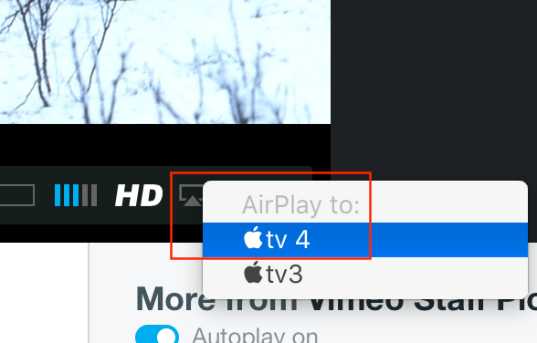

What about, lets say I stream a soccer game on a website, would it be possible to stream that to the Apple TV without any lag at all?
Yes. But it depends on your home network and the equipment you are using.
I think on compatible sites the video player (at least in Safari), shows the AirPlay icon. Using that one should just redirect the video stream to aTV, but without transcoding. It should be like a file copy action.

AirPlay and AirPlay Mirroring are 2 different things, despite similar name and underlying transport.
iTunes uses still AirPlay.
Safari AirPlay icon has the same effect playing from iTunes would (sends just the stream coming from the website), not the AirPlay Mirroring.
For some time now, iTunes has been clever enough to read your AirPlay connection status on the menubar. If you have AirPlay mirroring enabled but start to play a movie from library, it will still just AirPlay it to aTV, and not do the Mirroring part.
