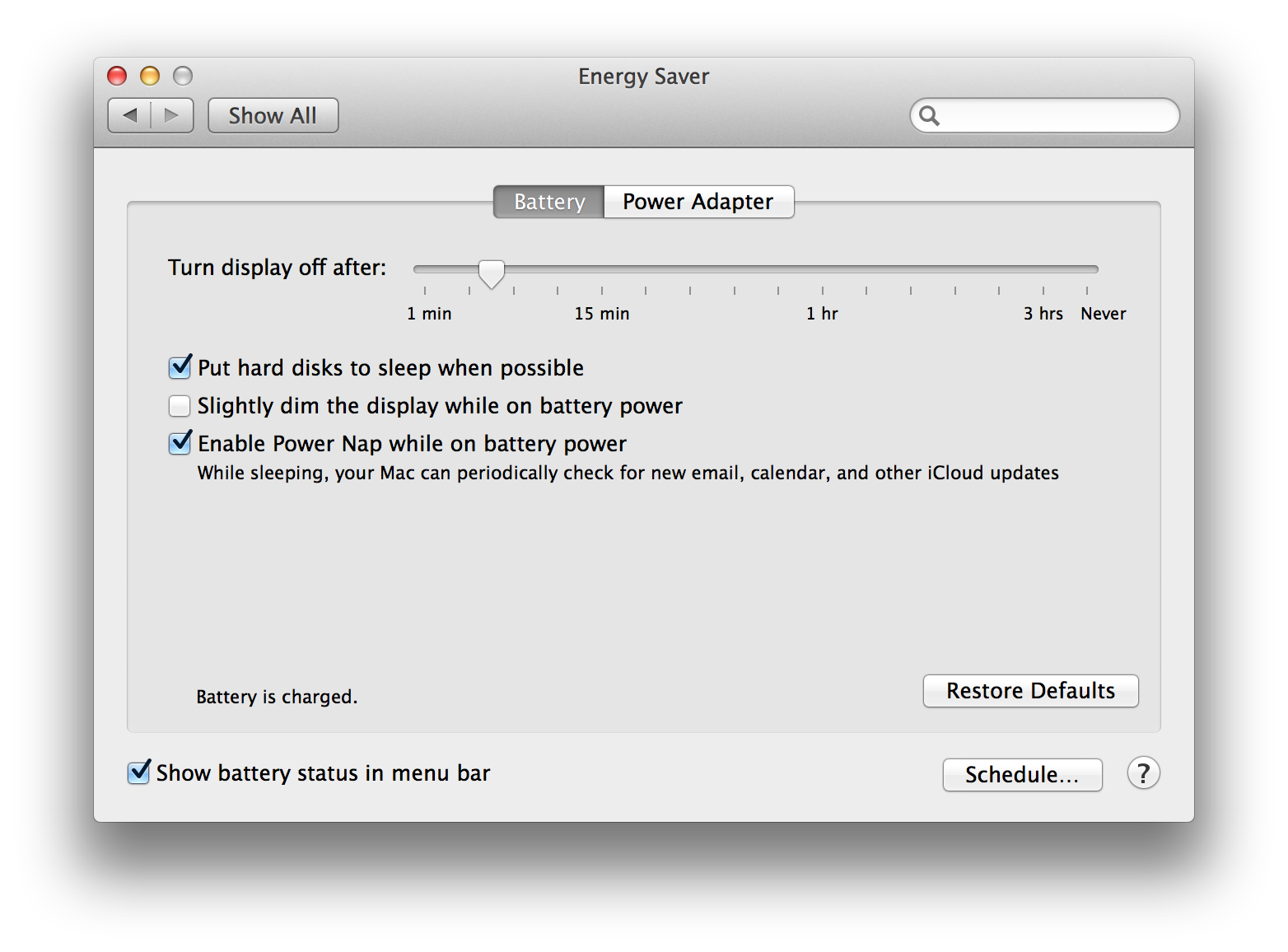

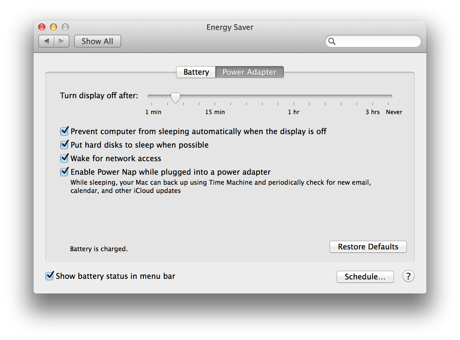

Most of you probably know this already. But in the "Energy Saver" settings, you can set the computer to start up after a power loss once the power cord is attached. And if for some reason you shut it down, you can also schedule it to start back up at a certain time with the power cord attached. I have just revived my 2007 macbook with the pin jump method and have just verified that the above settings are not affected by the loss of the power button🙂))
It doesn't appear anywhere in mine:
