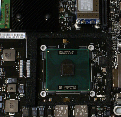

    When you say epoxy, do you mean Apple actually puts a goop of glue and sticks it on there?

    Kind of...
    [​IMG]
    Here's the Mac mini's processor.
  12. Sun Baked

    You'll note that the glue stick came about (more widespread) the time of the XBox and Nvidia GPU problems... just another layer of reducing the shifting of the chip during thermal cycles.
