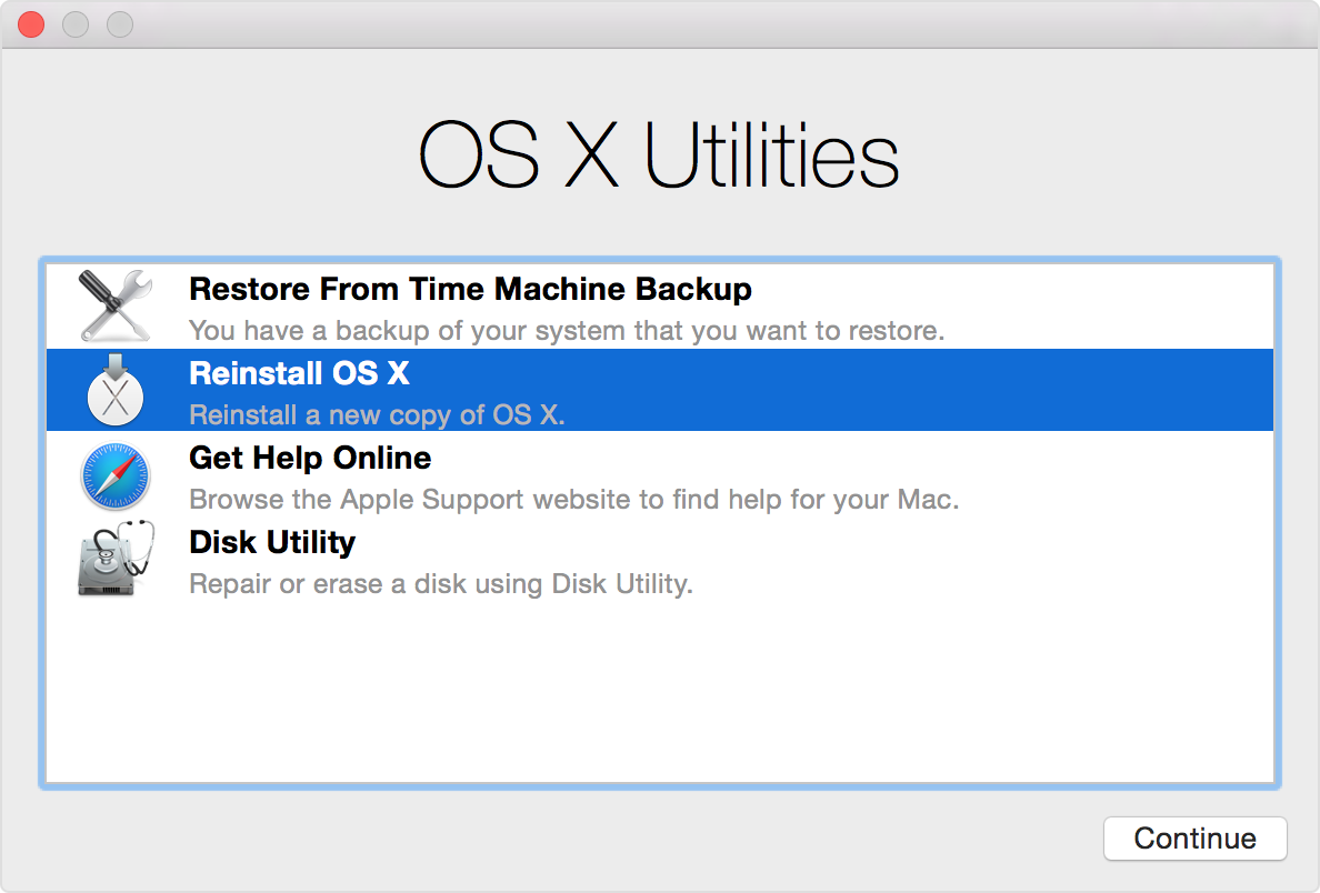

Still the 2012 model you mentioned here?
If so, that model has Internet recovery in firmware and can download the OS over the Internet. Install the drive then hold command-option-r at boot (all three at once). Once you enter your wifi info you will see a spinning globe while the recovery utility downloads. Once that is done you will see a screen similar to this. Start Disk Utility and in the left column pick the new drive. Now go to the erase tab and format the drive to Mac OS Extended (Journaled). Then quit Disk Utility and click Reinstall OS X.
That will download the ~6GB OS over the Internet and install it. This will be the OS X version that came with it from the factory. Once that is done and you have made your account and logged in you can update to El Capitan if you like.
