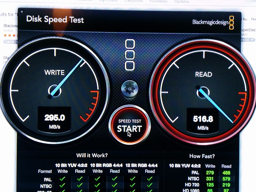

Anyway, all sorted now. Fusion drive tested. Speed of the Angelbird Wrk for Mac seems good and can confirm TRIM is enabled.
