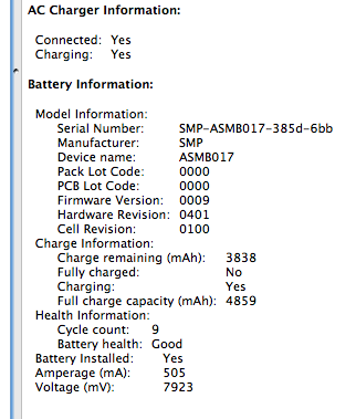

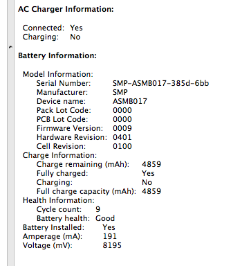

Takes to long to charge from zero
Ours seams to take to long to recharge from zero.
Any advise? Thanks!
