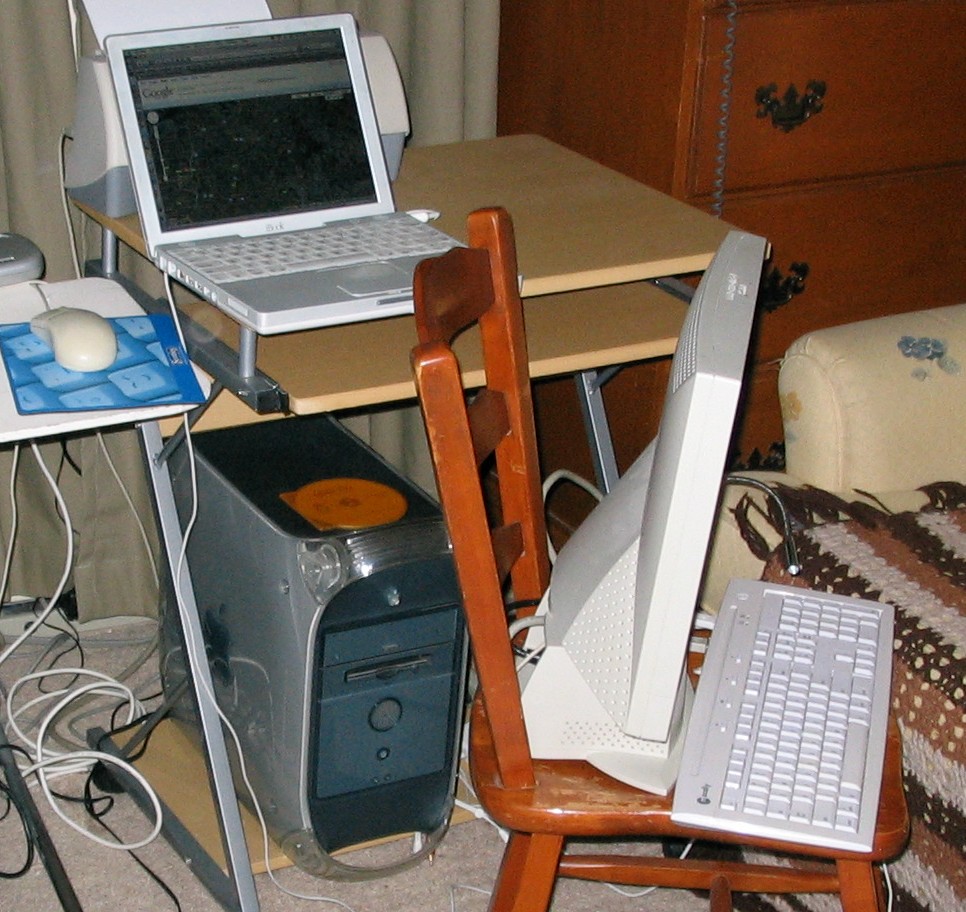

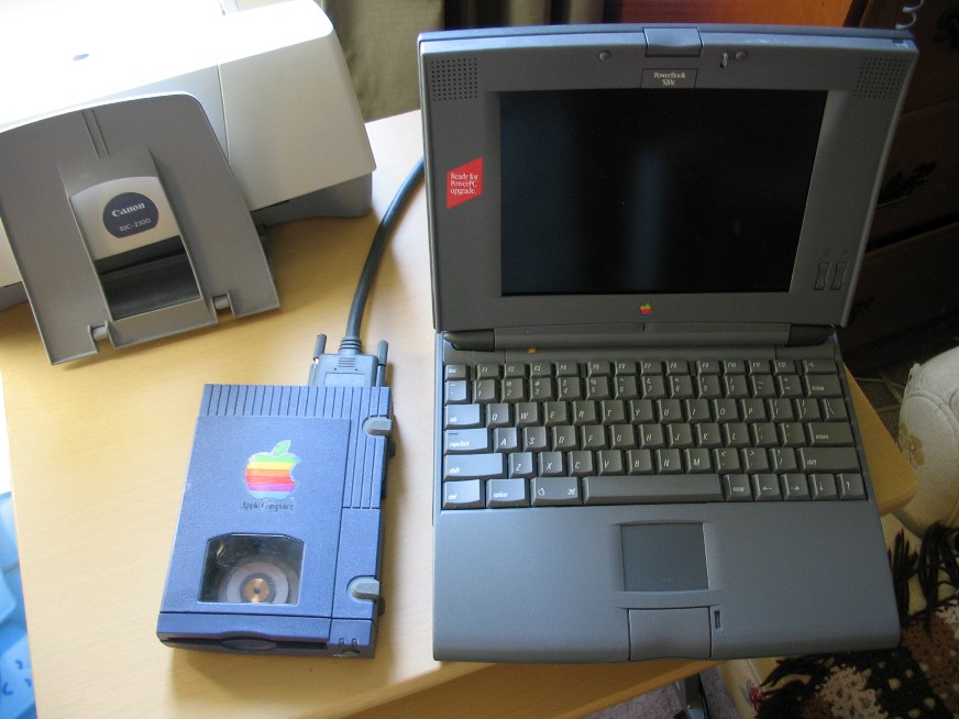

520C PB , 600mhz G3 iBook and 1Ghz Power Mac G4:

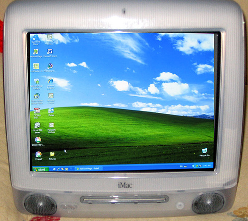

Alright, that covers the why.:p But my real question is; how exactly is that machine able to do that? I know there's emulation software, but I wouldn't think an iMac G3 could handle it.

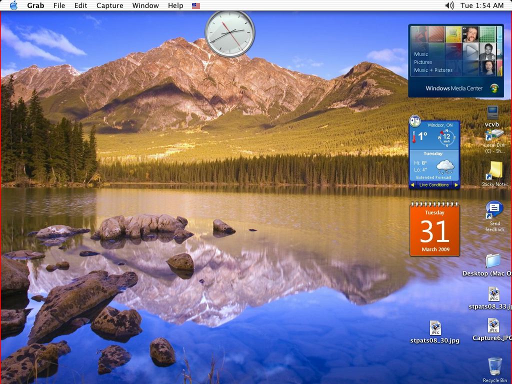

Here's one I just did. It's a screen capture of a Windows 7 desktop from one of the other computers used as a desktop background.
The other one was Photoshop.
Those are WONDERFUL pics, do you have any in high-res versions?
I want them too!
