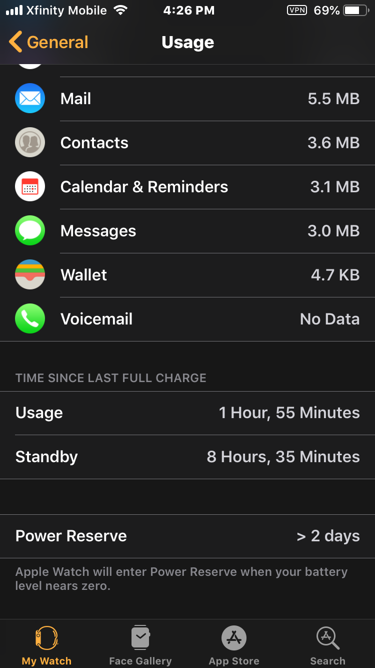

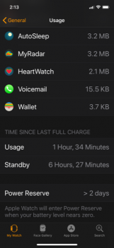

Is it just me or is the Series 4 battery life almost the same as a Series 2? The battery starts draining soon after I take it off the charger. And the usage is almost 1/4th that of Standby even when I wasn't active. I use the Siri watch face by the way on a Nike+ Series 4 44mm.
At 1 day 6 hours it was at 20% already which was almost the same as I had with my Series 2 42MM.
It's at 88% already with the below usage.

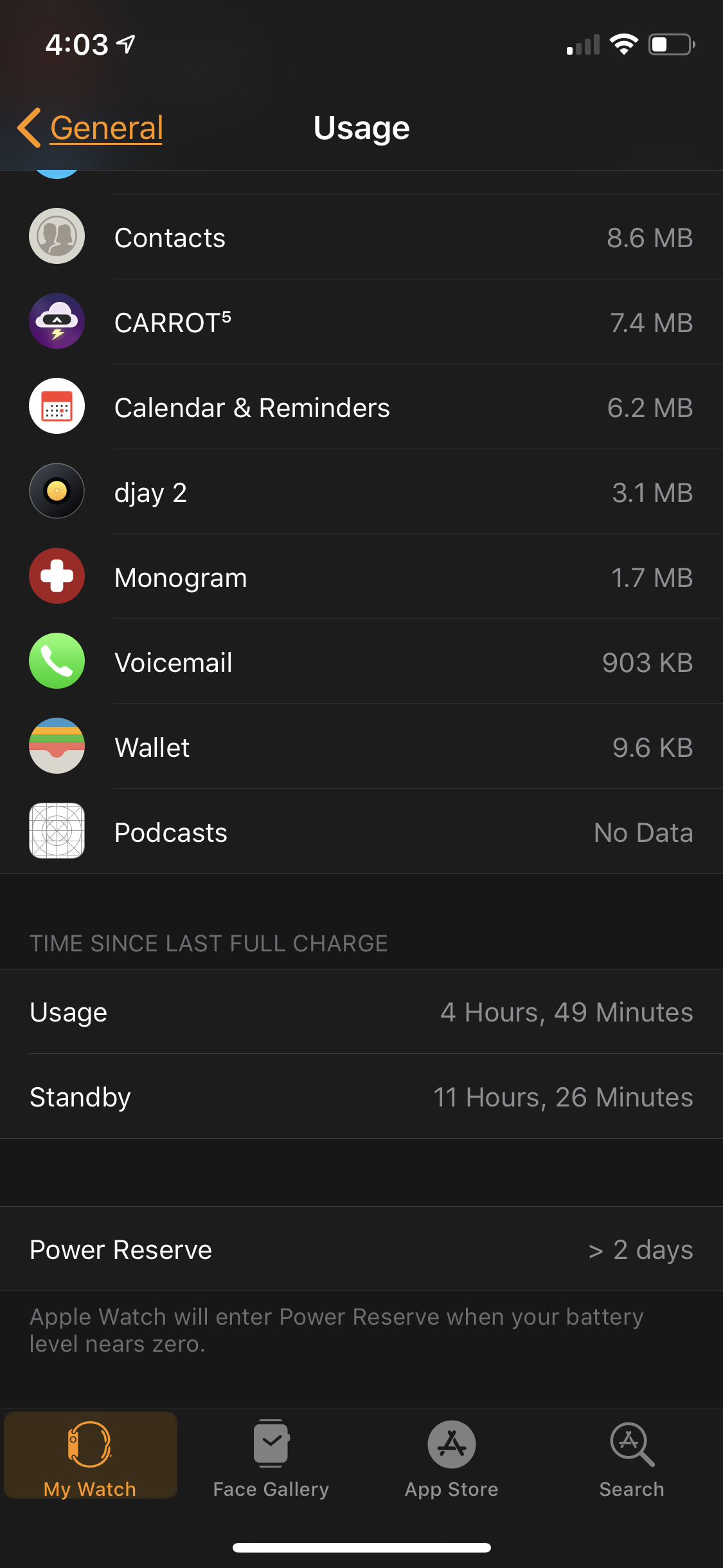

I’ll post mine later as my S4 has been off the charger for almost 3 hours with no notifications barely coming through to it. I’m already at 93% battery.
Days I go to work I take it off around 12 and by the time works over around 11 it’s around 50%. My wrist moves a lot so perhaps that’s why. Days off work it can last around a day and a half and be at 50%

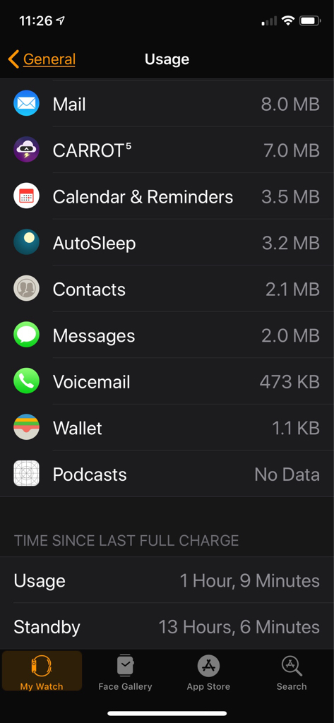

Took my watch off of the charger at 5:30am for work. Ran a 10K after work then washed the car. Battery at 65%.
That doesn’t seem too bad considering the Watch would be at full brightness when it’s outside during the wash.

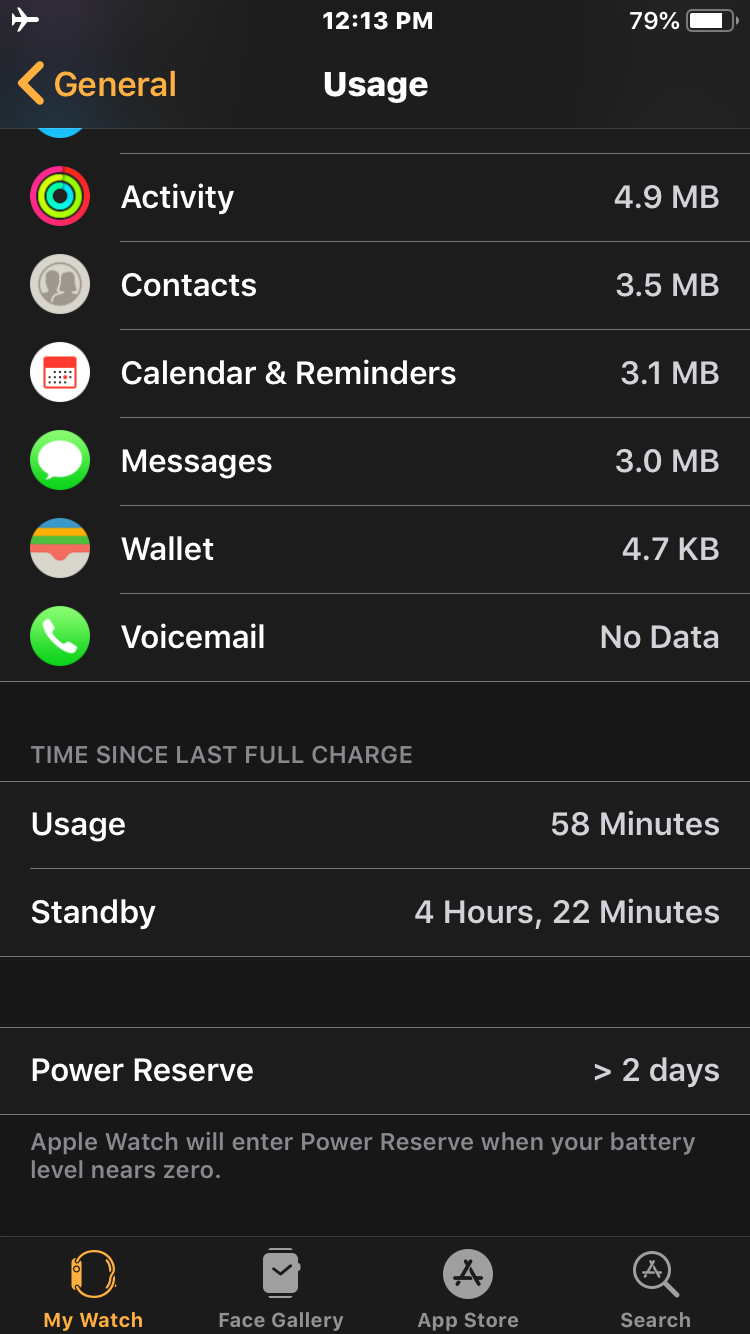

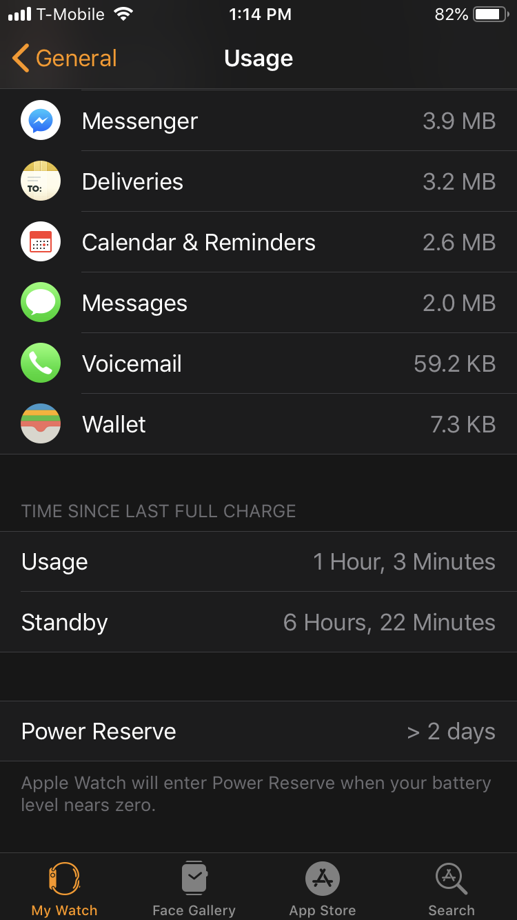

That’s what I’m talking about. Like your usage to standby ratio is about 1:6 while mine is like 1:4 consistently. Now it’s at 78%

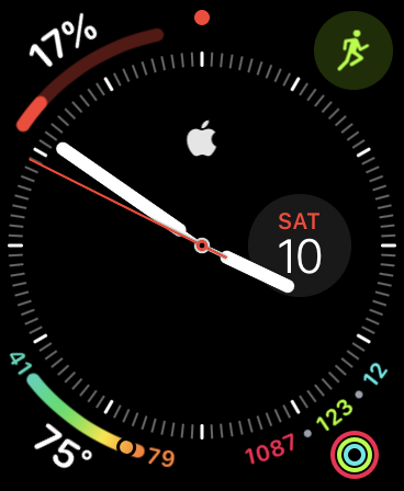

I’m good for 2 days and usually am between 5 and 20% left, took it off charge yesterday around 5am, currently 7hrs 39min usage and 1day 11hrs standby, showing17% remaining which will bring me thru the rest of the day.
I get text, personal and work email and calendar notifications and this is my watch face, not a whole lot of complications

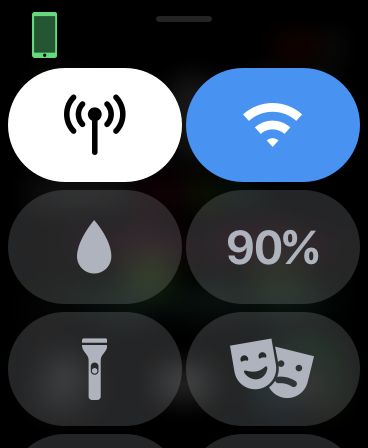

I’ve been trying to turn the WiFi off since I have cellular activated on my watch.
You need to turn it off in settings not in control center otherwise WiFi will try to reconnect again.
