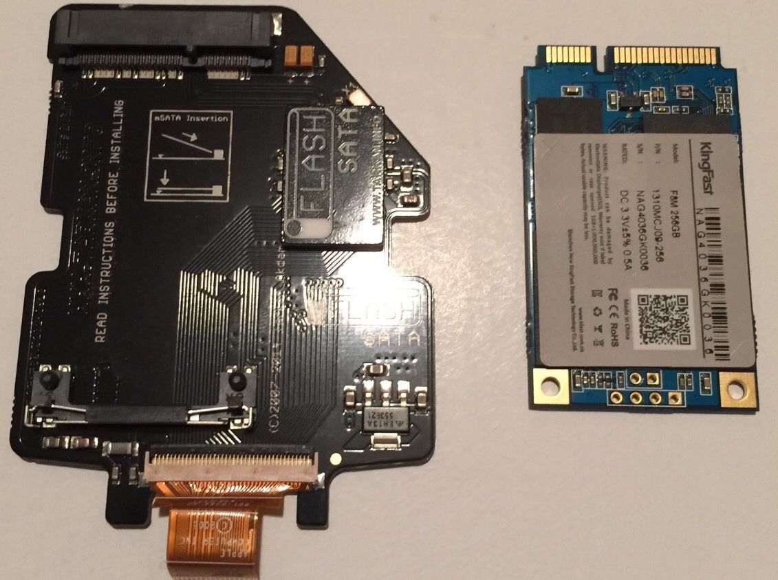

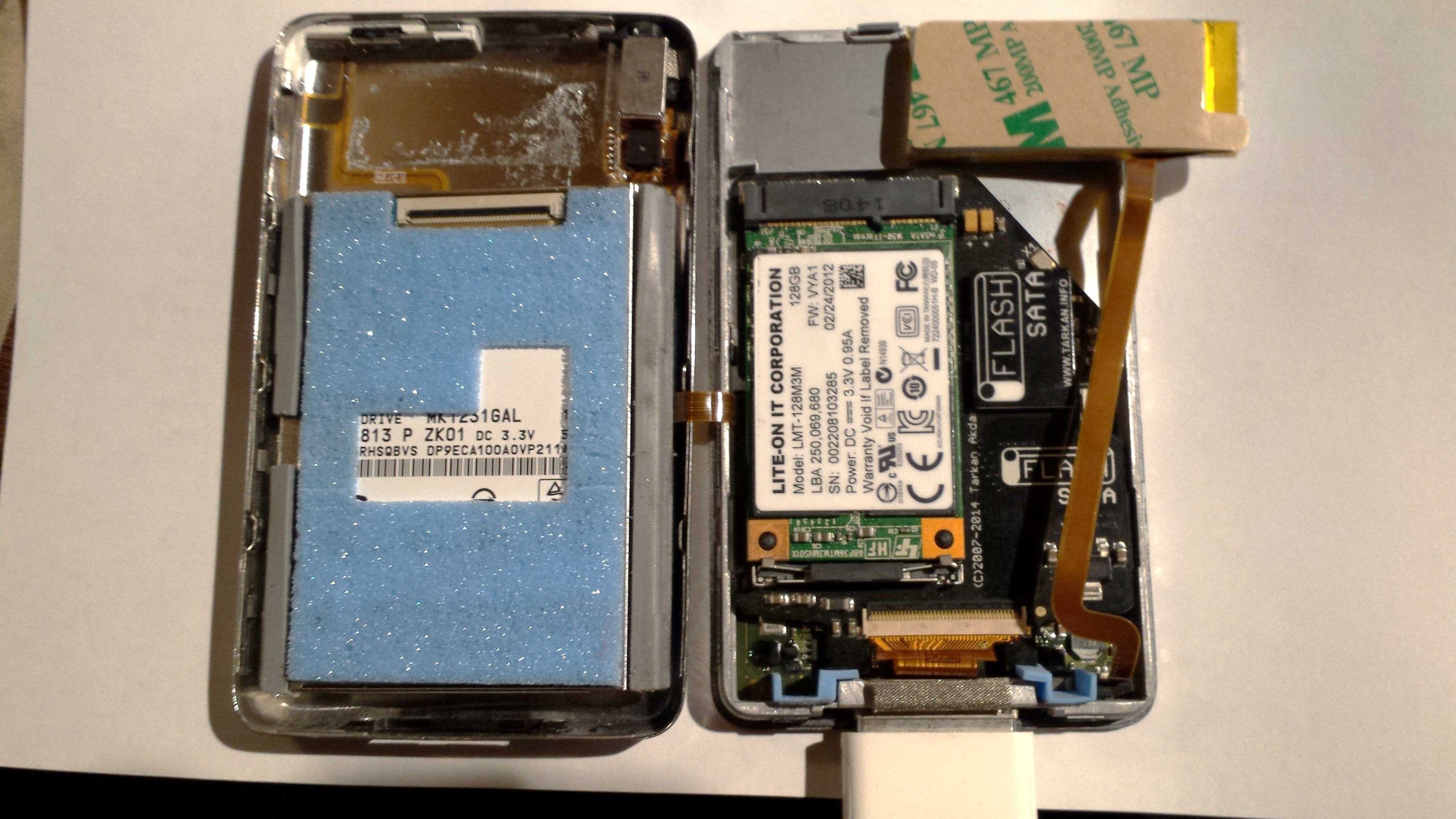

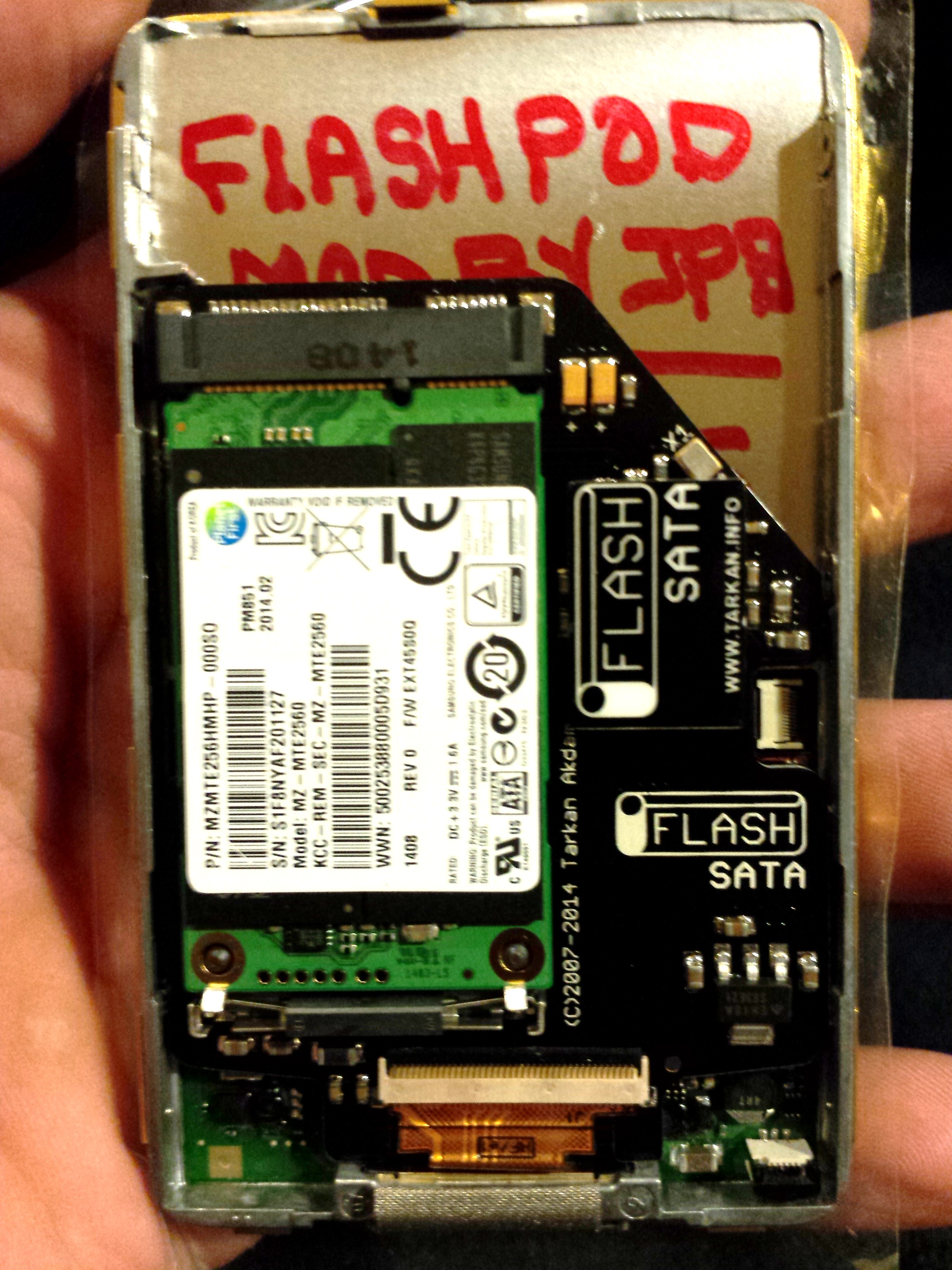

I'll also post a pic of said ipod. On the left is the old hard drive. On the right side you'll
see the new hardware: iFlash adapter board, SSD card installed onto adapter board and
the new battery. I reused his old backplate and headphone jack.
[doublepost=1483780005][/doublepost]Here is the pic:
Left side is the old hard drive sitting inside the back plate.
Right side is new iFlash Sata adapter board with SSD already installed on it, along
with new 850mah battery. What you see is the backside of the battery. The brown
label peels off to reveal 2 way tape, to stick battery right to the backplate on left
side. If you look at top part of backplate you'll see the remnants of tape from old battery.
Oh, and I mentioned that I used a Samsung SSD, I take that back, it was a Lite-On branded
SSD drive, which is basically made by Toshiba. These are the 3 that I have used with
absolutely no issues whatsoever. Samsung. Toshiba or Lite-on. All 3 are great boards to
use for this type of application.

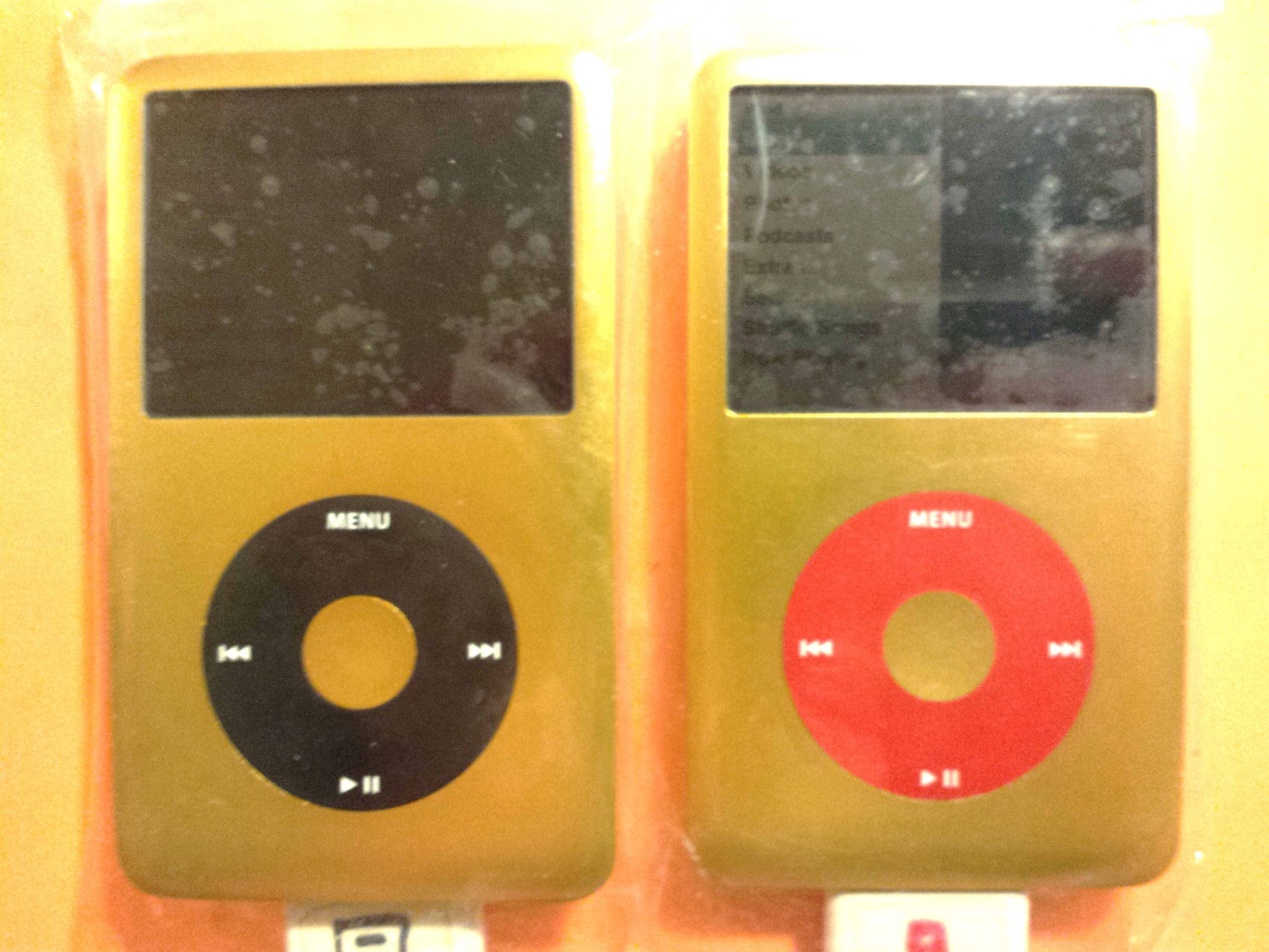

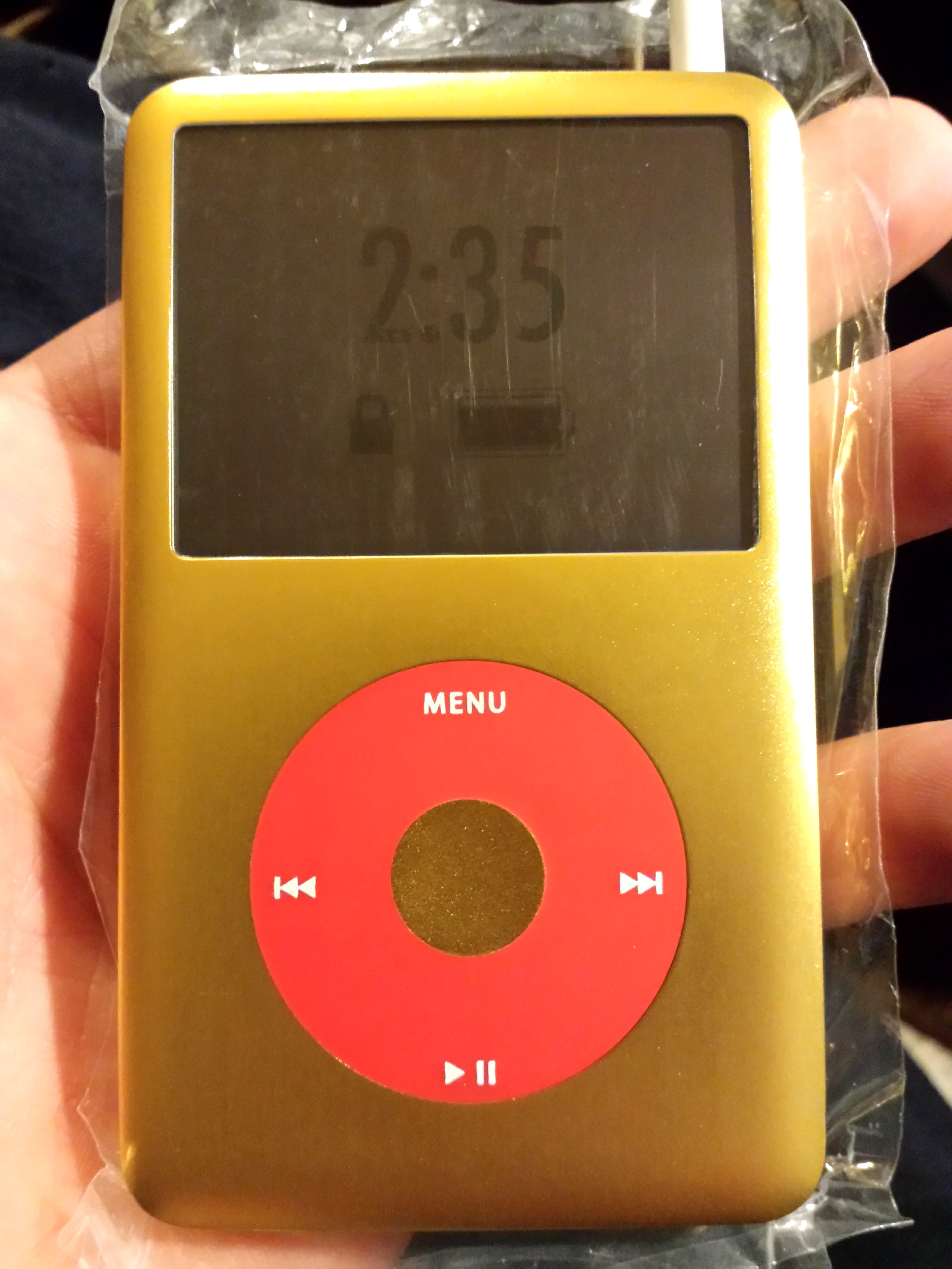

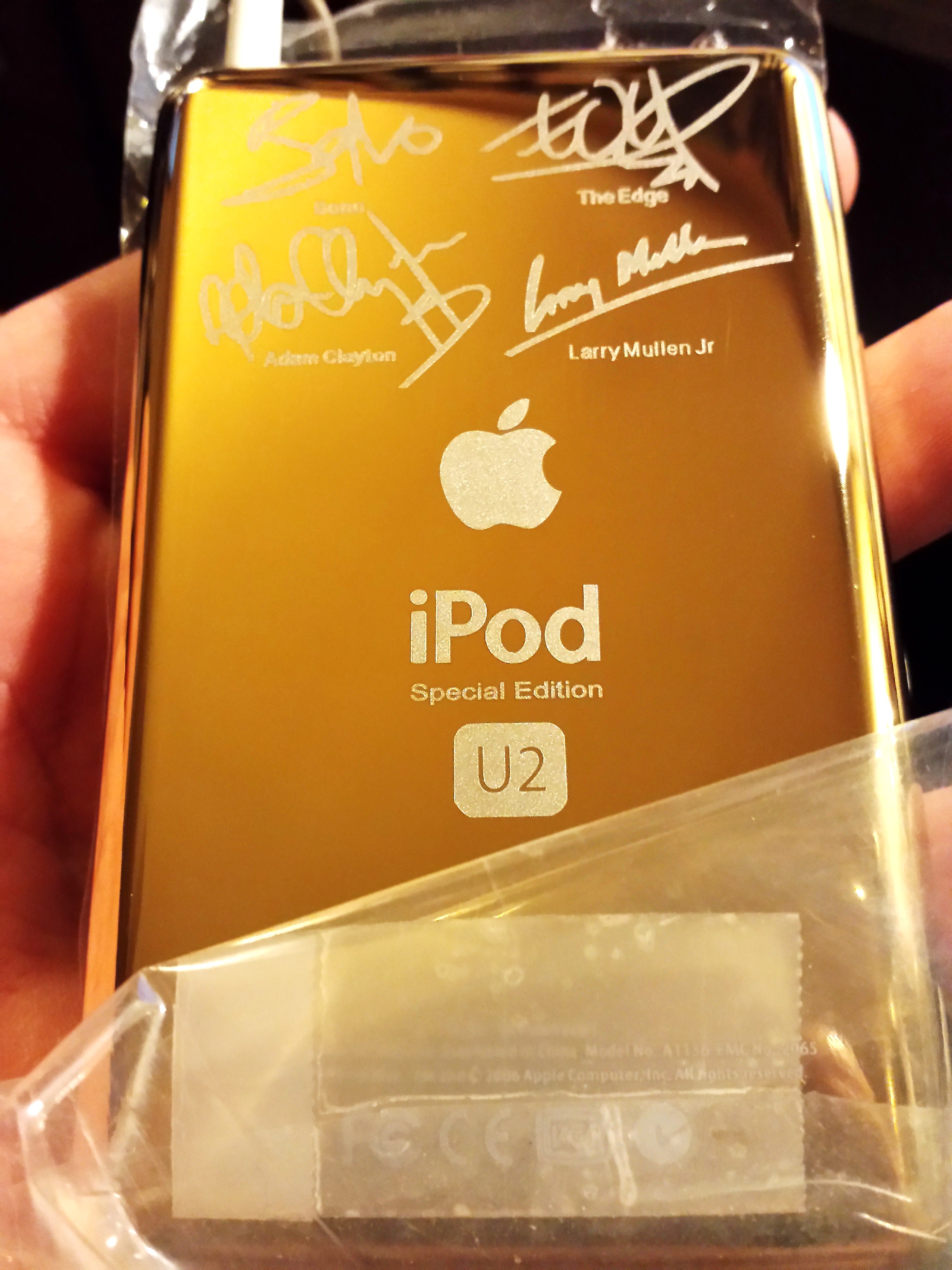

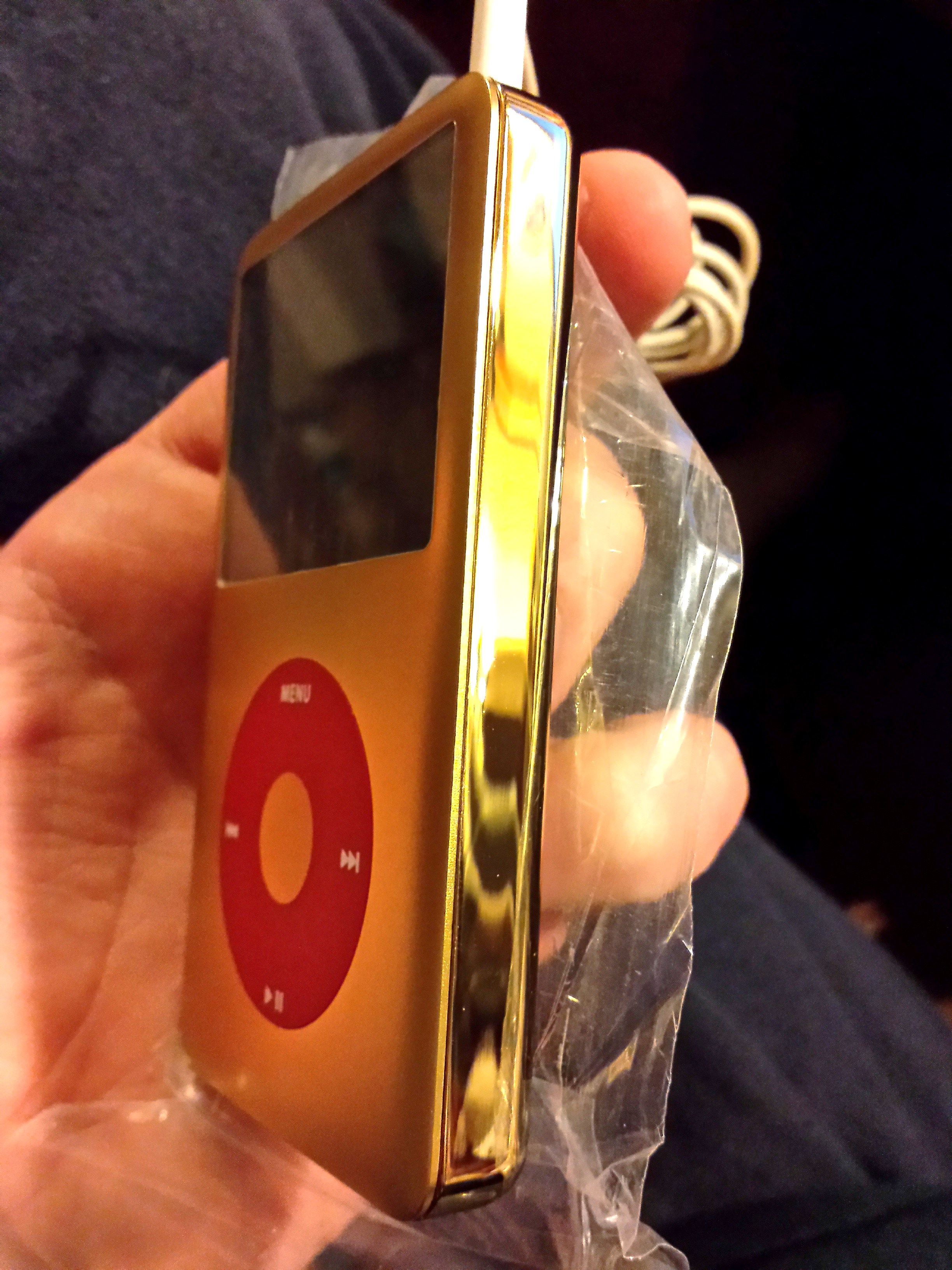

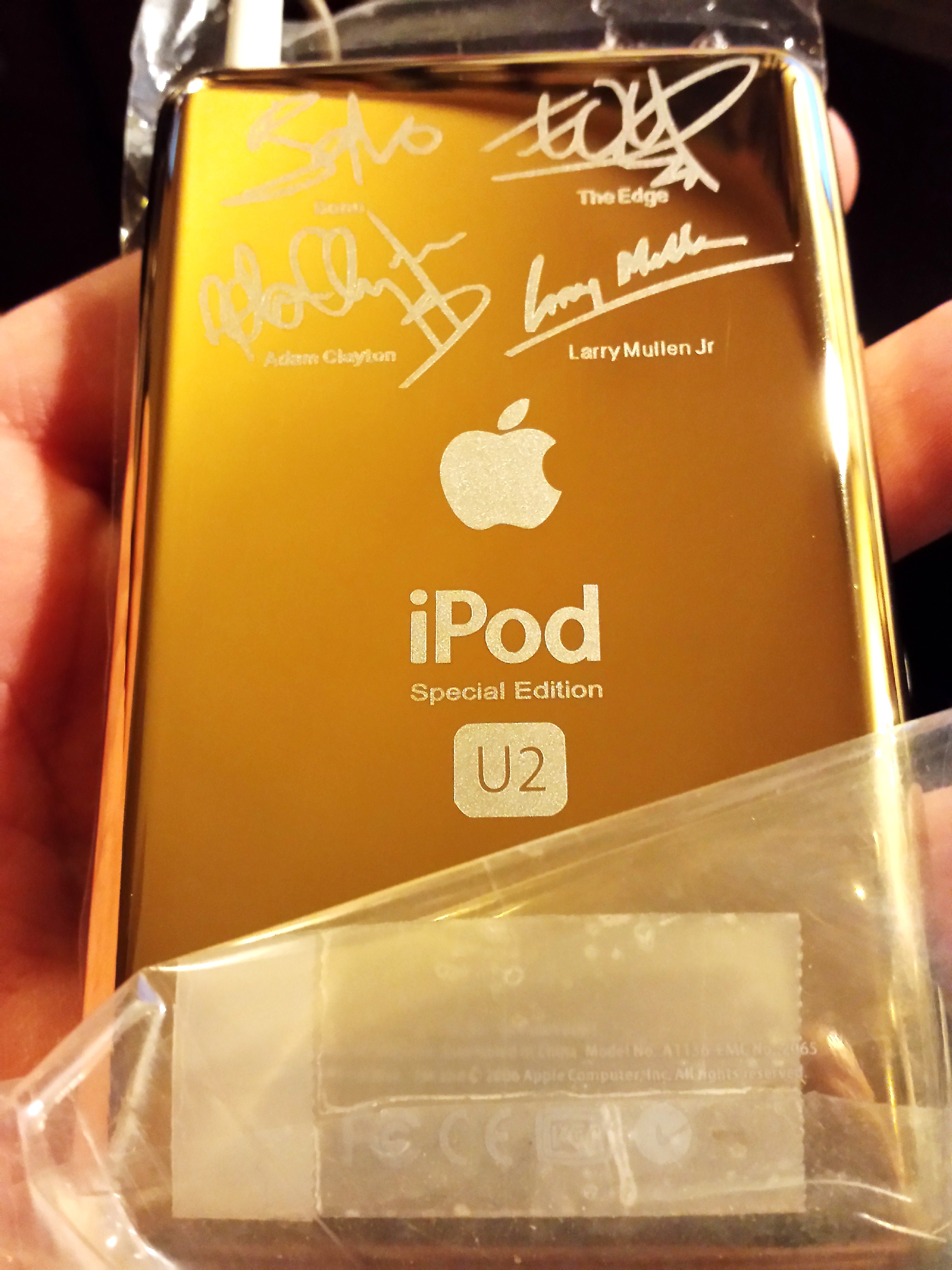

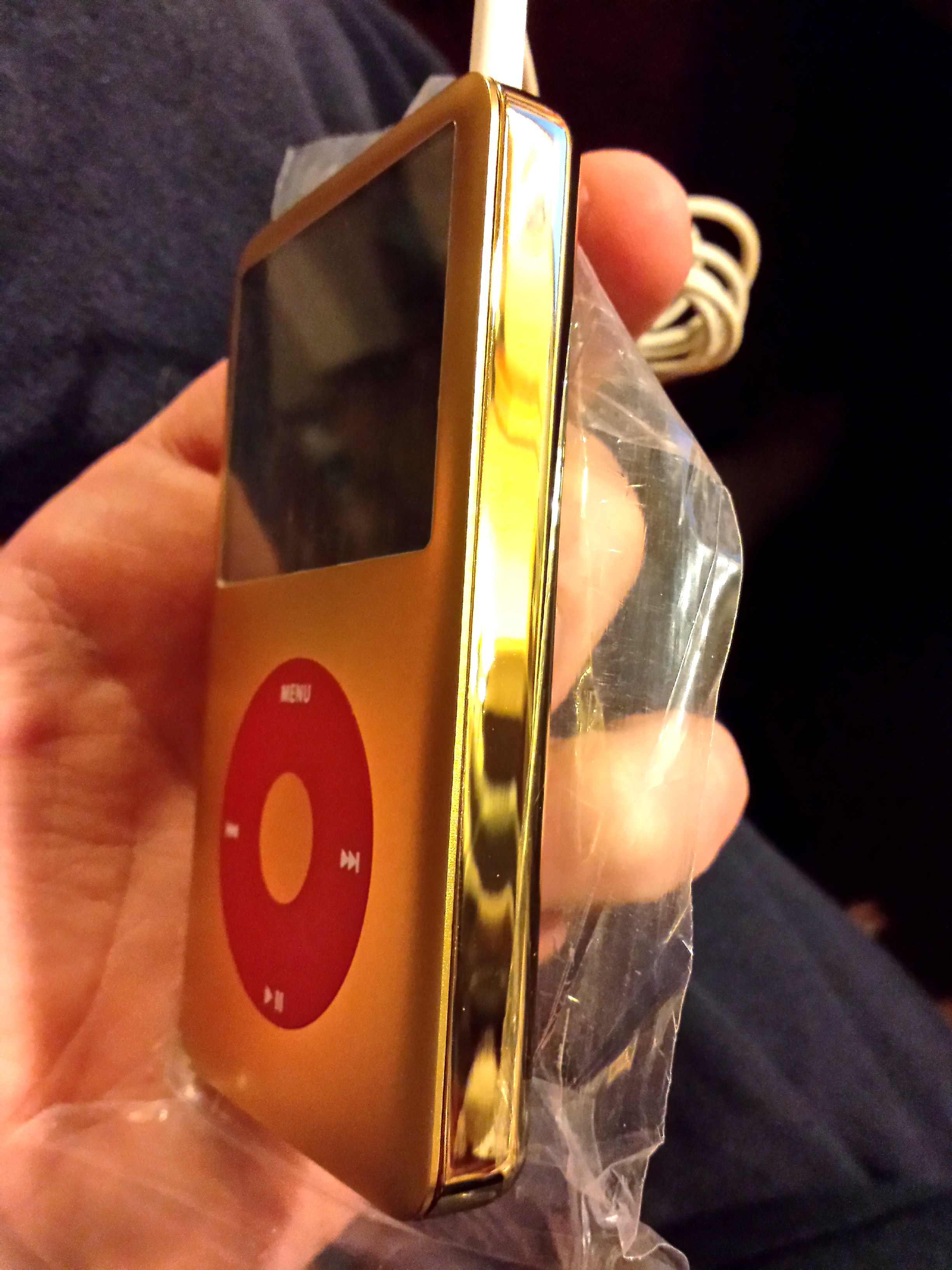

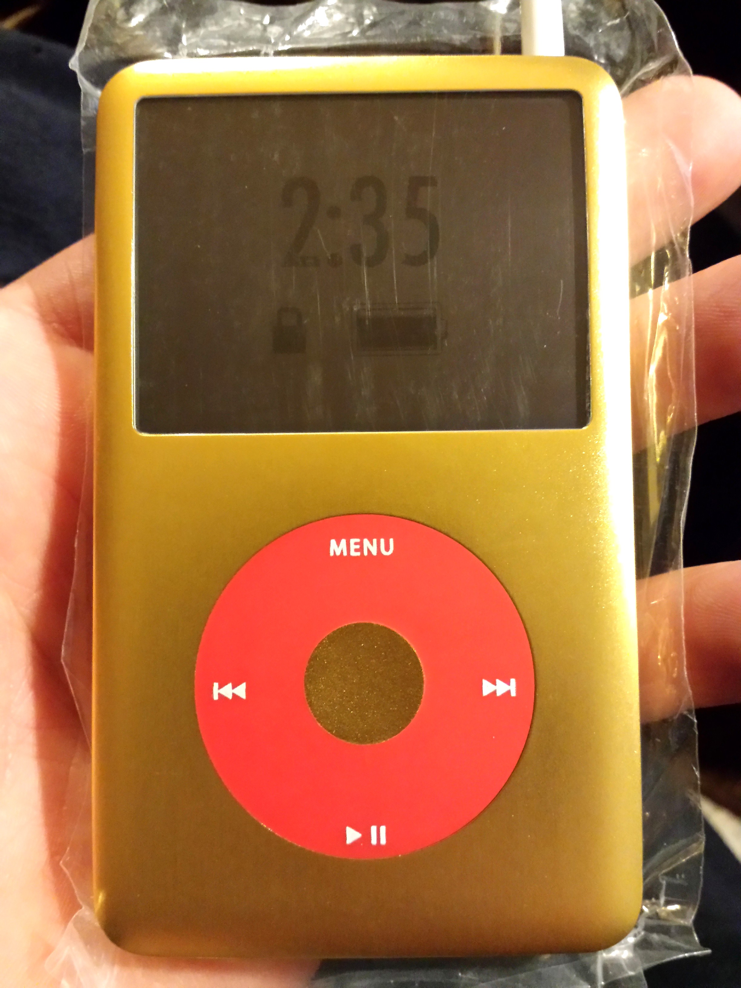

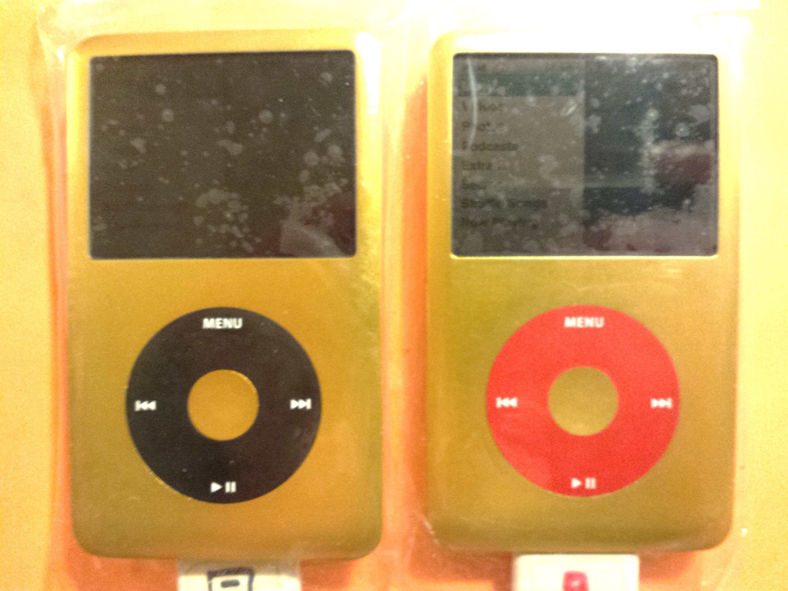

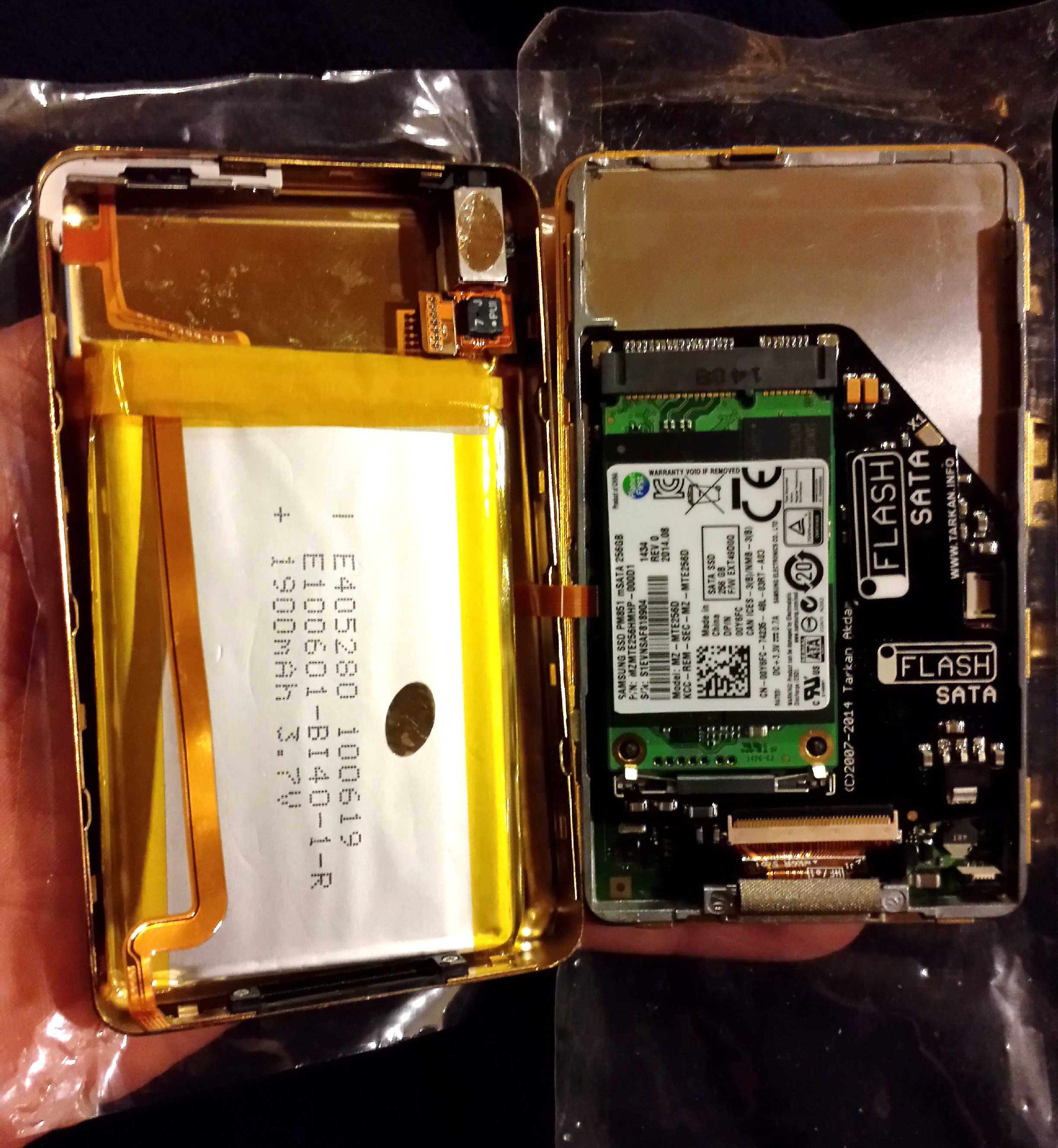

Here's some more pics to possibly tickle your fancy. I don't know if you like any of the gold colored
faceplates/backplates they have available, but here's a couple I built a couple years ago now.
I originally wanted to do gold faceplate/backplate style ipods with a red clickwheel and gold center
button, so I built around 10 of those. I opted to use a thick style gold backplate to accommodate
a 2000mah battery, powering a 256gb Samsung SSD connected to a Tarken iFlash SSD adapter
board.

If you went the SSD route, (I personally also prefer) you simply cannot go wrong with a
Tarken iFlash SSD adapter board. I've never had a problem with any of them. I've used
around 40 of them so far from him.
SSD boards that I've used without issue, in this order: Samsung, Toshiba, Lite-on (Toshiba)
Depending on how much memory you'd like to get with it, here's what I've done thus far
using Tarken's adapter boards. If you were only looking at 64gb or 128gb worth of memory
you can use a thin backplate with a 850mah battery that'll give you around 12 hours playtime.
If you wanted to 256gb or higher, you'd most definitely want one that has a thick backplate
with at least a 1900mah battery. If you were to build one yourself, make sure that you get
a thick backplate headphone jack/hold switch to go with it. It's longer for the thicker case.
The higher you go in memory the more chips/memory banks you have on the SSD to "fire up",
thus requiring more power, which is especially important when it comes to syncing the ipod.

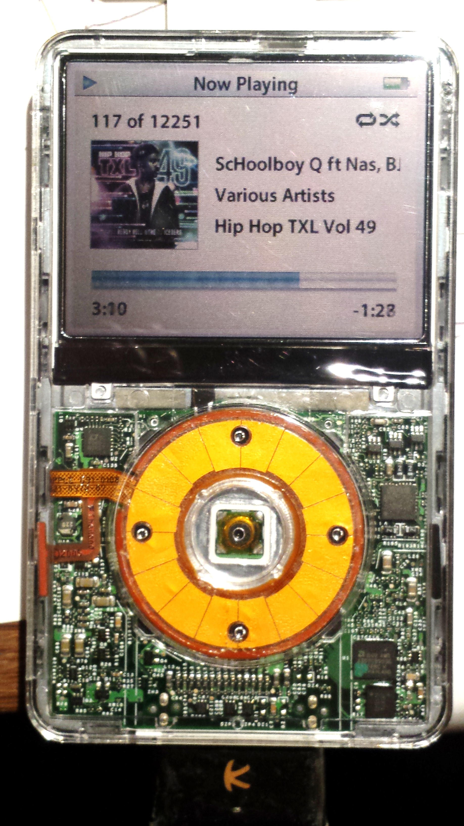

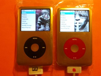

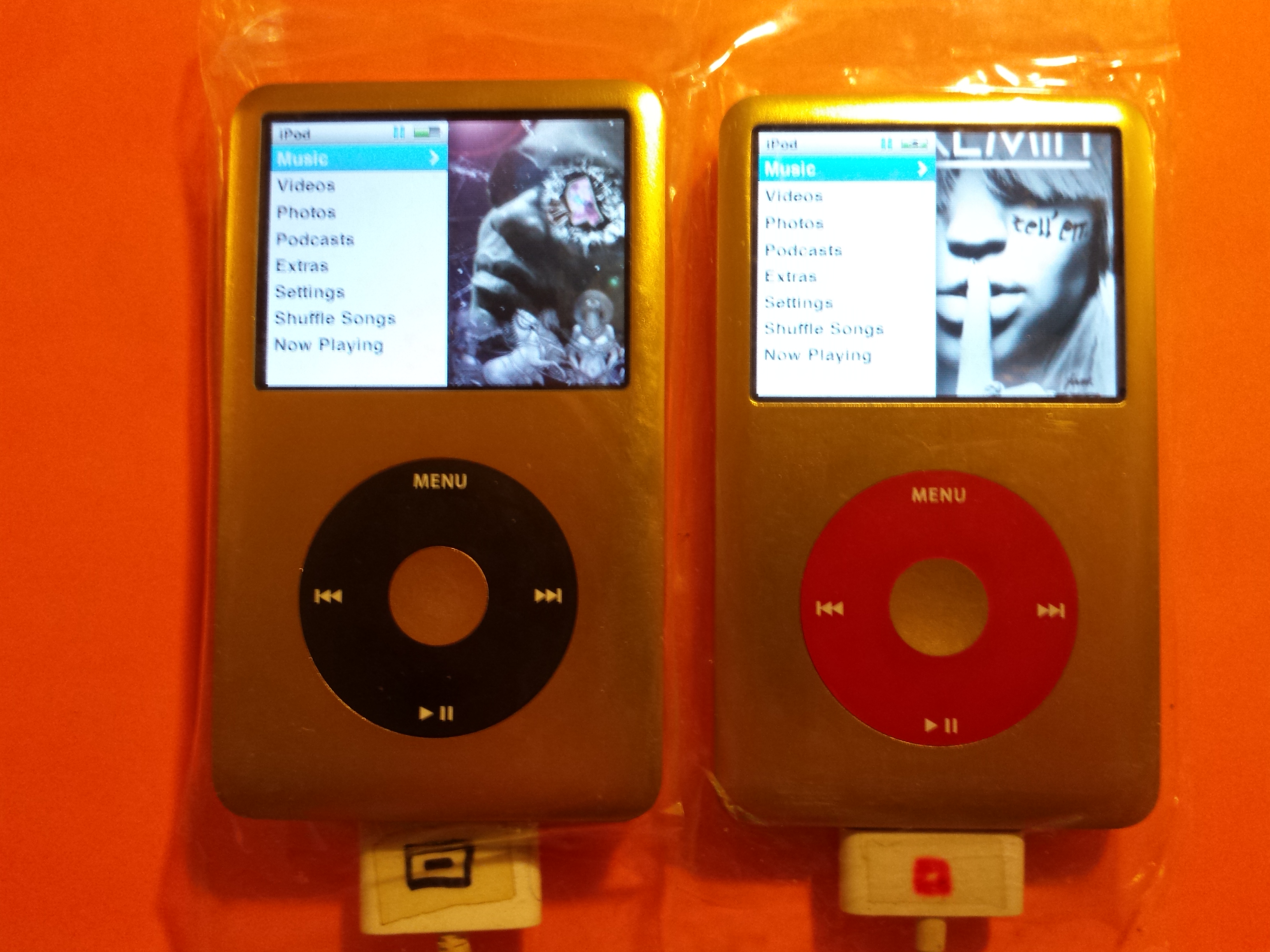

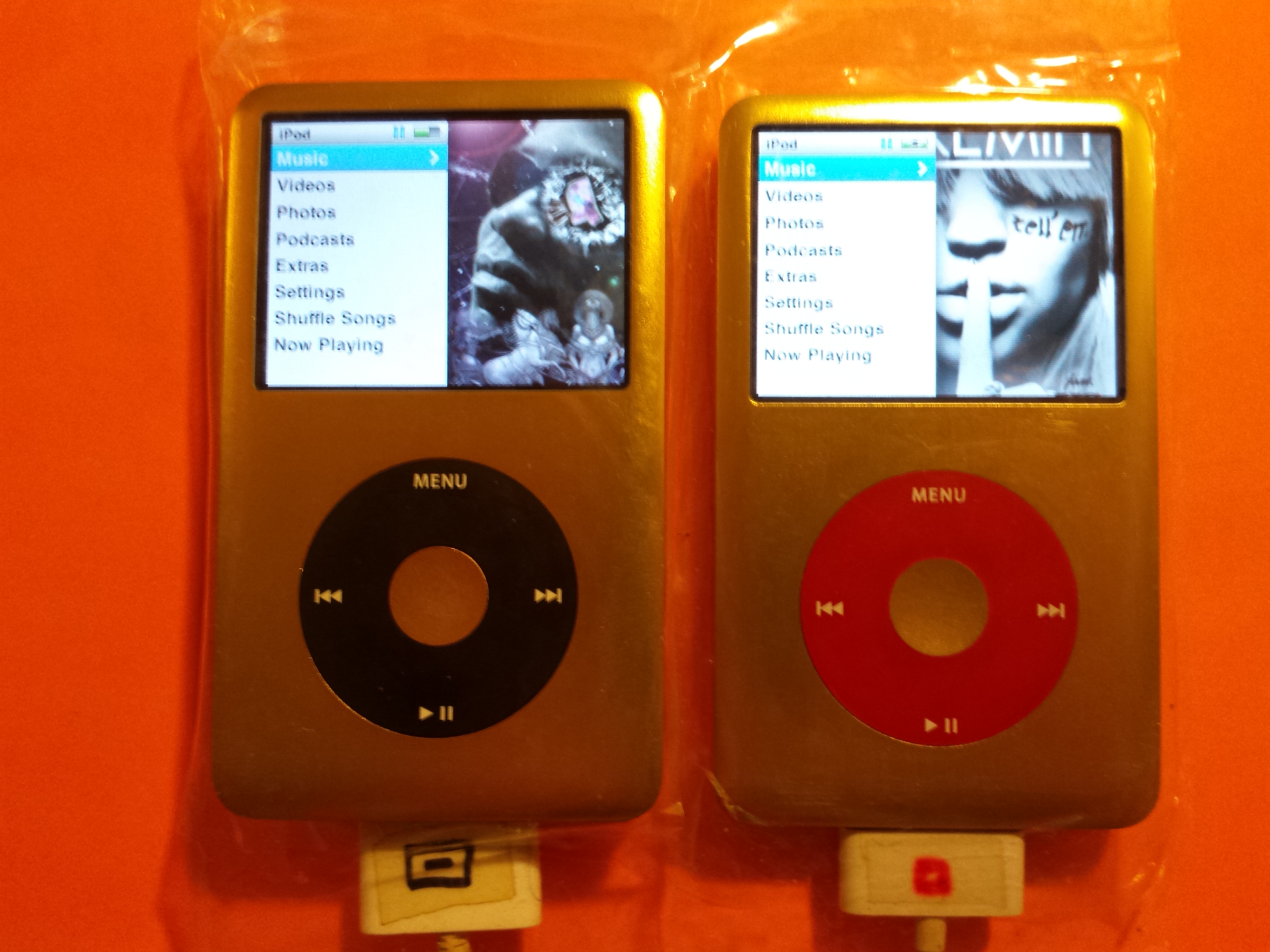

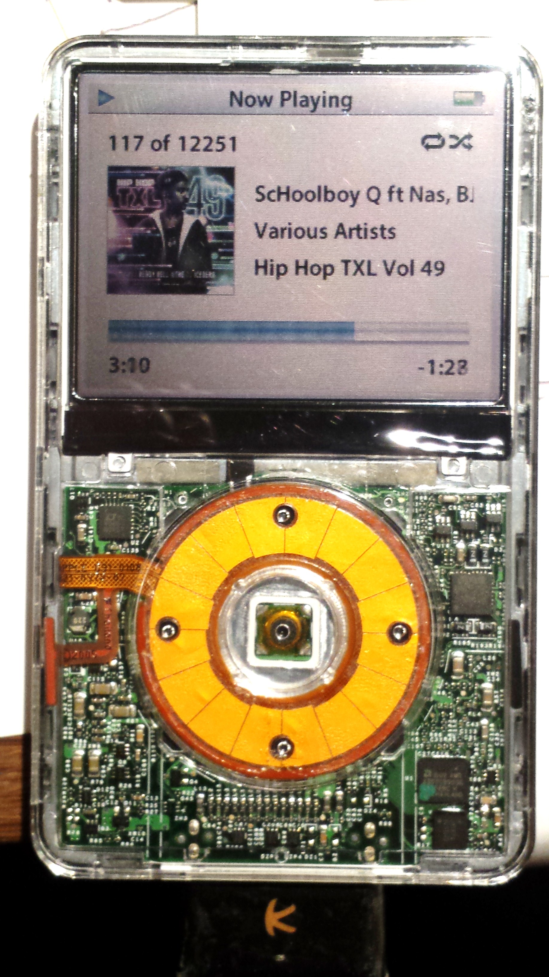

Alright, sorry for the book. Here's some pics to check out if you'd like. I'm currently using
the see-through model. It's originally an 80gb 5.5 gen motherboard that I have modded,
but I'm only using a simple (generic) SSD adapter board and a samsung branded drive.
It works great, but the adapter board maintains no memory. It runs like basically booting
up a computer if I shut it off for more than 2 days. I have to wait around 30-40 seconds
for it to load, but other than the boot-up time it's been working flawlessly for around 2
years now too.. I've dropped it twice already though, glad I've had it in a case....

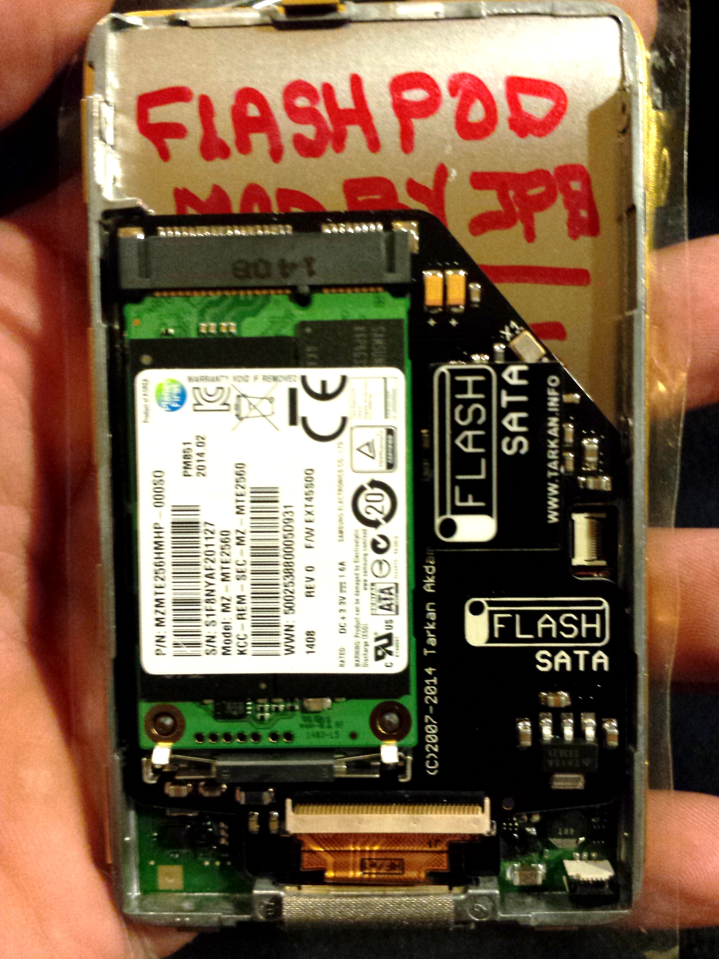

The other classics you'll see are builds that I've done. These are originally 7th gen 160gb
models that have been modded to a Samsung 256 SSD, Tarken iFlash SSD adapter, thick
gold U2 backplate to accommodate a 1900mah battery. All parts I used are brand new
including the front plate, back plate, headphone jack/hold switch, clickwheel and center
button, to name a few. I use the original motherboard (of course) and the LCD screen
if there are no visible blemishes in it.

There is lots of info here on how to tell the different 160gb models apart. Basically the model without the 128gb limitation is thinner (0.41 inches) and lighter (4.9 ounces) than the 6th gen (0.53 inches / 5.7 ounces). The model numbers etched into the back plate are MC293 for the silver one and MC297 for the black one.
SDXC works fine on Mac. Just reformat to FAT32 with disk utility and you're good to go. Cheers!

I would not be against performing any upgrade(s) myself -- though it seems these models are notorious for their difficulty in opening. For that reason, I'm looking at both refurbished models and used.
Good plan. Looks like Ipod Collector 2 has lots of interesting options should you decide to go that way.
I would have helped him in the right direction for the "pry tools" used to open the classics but the
seller on ebay I bought a couple of sets from seems to be sold out of the ones I got, which I'd
recommend to anybody. The backplates are still difficult to open, even with the right tools.
Having plenty of patience while opening them is a must! I've learned this after some time.
I'd most definitely be willing to help barcode out if he ever needed it. I can build them one to
any of their desires and even be able to keep the price competitive in the process. I have a
majority of the parts already in stock to probably make around 20 modded classics right now.
