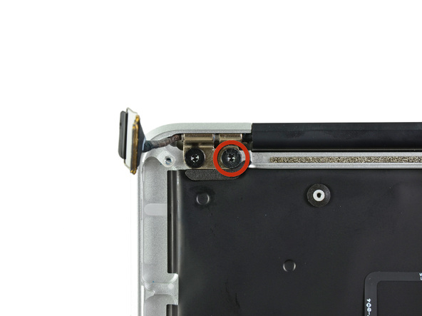

Side note, it's not always possible to "just tighten the hinges" when they loosen up. The hinge itself in most Apple portables isn't truly adjustable, at least not easily for the majority of technicians, myself included. Instead it can be re-tightened down to the top/bottom case. This is needed if the display moves up/down vertically and is a little loose but still holds it's position when opened to 45 degrees or so. Hopefully the picture below, from iFixit's display replacement procedure, gives an idea of this. The two torx screws on either side of the MacBook Air display are what hold the display to the top case, if they loosen up (my theory is from picking your Mac up by it's display) over time then you will usually see the symptoms I just outlined. i.e. not really a loose hinge, but the display's mount to the top case has loosened.
