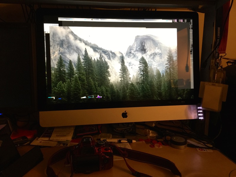

Check this out
This is what I'm getting on my screen if I try to view .NEF files in iPhoto - it totally seems to crash iPhoto and mangles the gui so it won't do anything anymore.
If I view .JPGs from my iPhone or the like, it's fine.
See attached.
