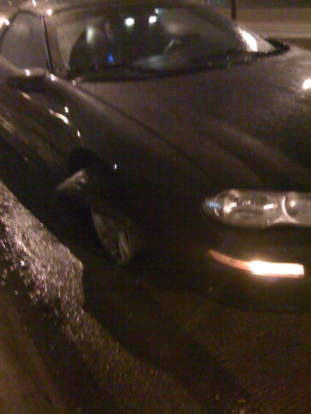

So last night I went to Chicago. Me and 3 others are in the car. We were headed back to the interstate, but about a mile before the exit, we feel and hear this HUGE thump. It was a giant pothole that couldn't miss because A) It had been raining for hours and was covered in water and B) there was a car on the side of me so I couldn't avoid it.
So right after it happens, all the people in the car are like WTF. I notice it is very hard to keep the car straight, as it always wants to go to the right. So anyways, we get out on the interstate, and about 3 minutes later, all I can feel is insane thumping. My tired had pretty much exploded. So i quickly got off to the side and to where it was safe, and had to replace the tire. I never thought I would have to do something like that. It would of been fun without the coldness and the rain. IDOT came. The guy just pointed the flashlight and gave a little advice. I didn't expect him to help me though.

the iPhone picture has the geo tag in it
Yeah the rim has scuffs but no dents. When I felt the tire explode, I probably drove on it for no more than 15 seconds because I had to slow down and cross 3 lanes.

It's pretty common, especially with a tire that has a lower side profile. Replace the tire, have the rim checked out to make sure it wasn't damaged and get the car aligned ASAP. If the suspension has been altered you'll chew off the new tire in no time.
You must get this checked, by a garage (i.e. don't just look it over and decide yourself).
When you drive for some time, your tires warm up and become malleable. If your rim is damaged, it'll cut right though. Alternatively, if the rim is only bent slightly (much harder to see without spinning the wheel and looking 'down' it), it'll put a lot more load on that one point where it's bent - another pothole or hard corner and boom, there goes another tyre (hopefully that doesn't happen on a corner).
Seriously, tell the garage what happened and get it checked. Your wheels are the only thing holding the petrol-propelled ton of metal carrying your body to the road.
