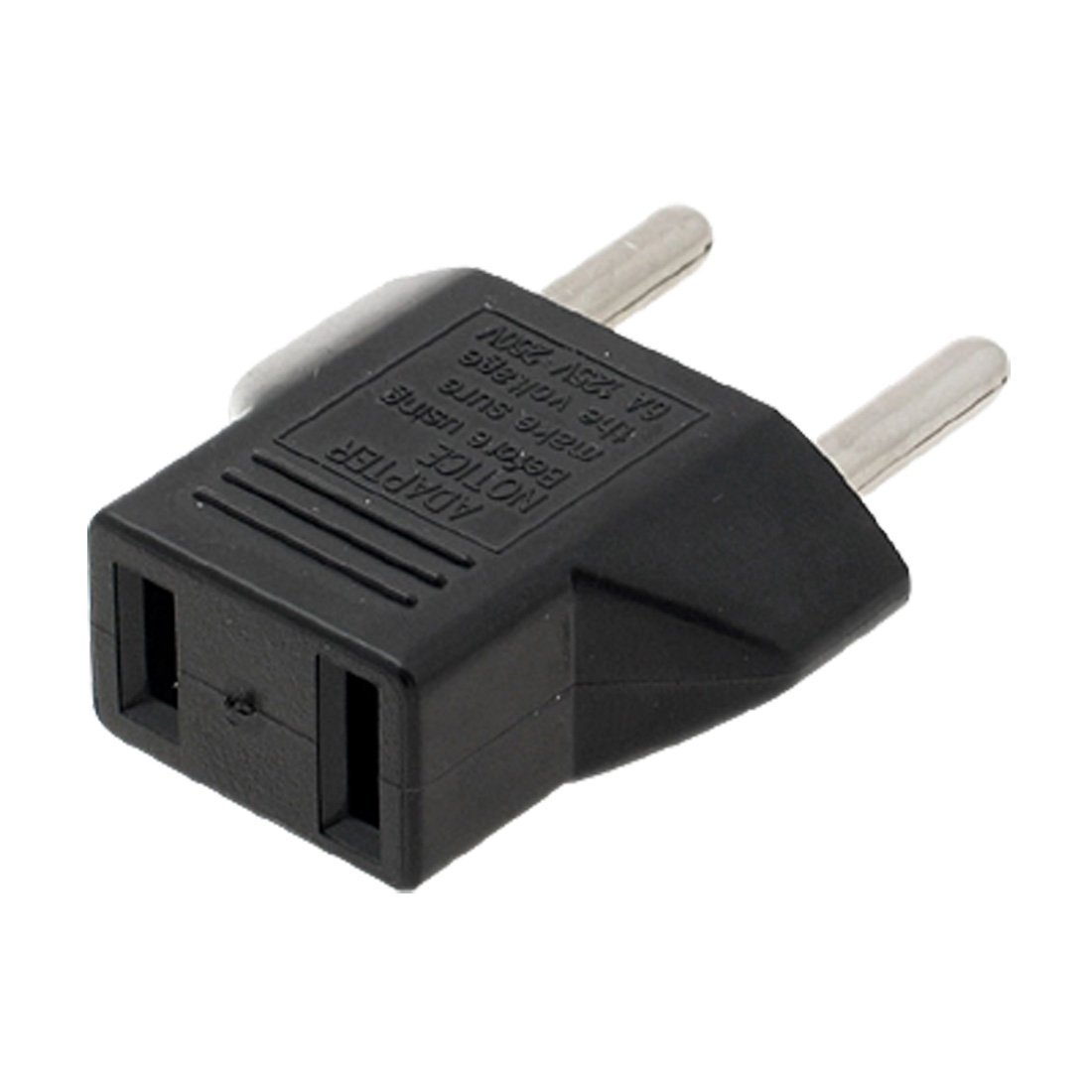

Something like this is all you need, unless you also want to get a surge protector. They're widely available. Just search for "power adapter europe"

All you need is a European plug adapter, or a new "duck head" which you can probably get from eBay for a couple of bucks - in fact, they're a buck each: http://www.ebay.com/itm/Apple-MacBo...=US_Audio_Cables_Adapters&hash=item3f1a649f61

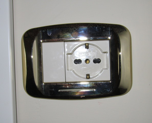

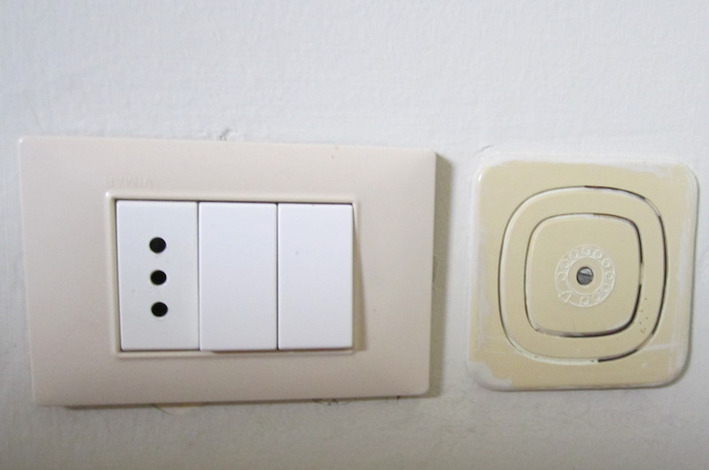

I'm American and I have family in Italy. Every few years I try to go back. Somehow despite being American I seem to blend in since when I'm out people come up to me and try to start a conversation in Italian.
Having said that, Italy has three different plugs. One is compatible with the EuroPlug, the other two are only found in Italy.
If you look at my attached pictures, the first one (white with brass) is designed to take all three. My hotel was very modern, and the maids looked like models (Yes I got their FaceBooks).
Receptacle 2 accepts both 2-prong EuroPlug and the weird Italian 3-prong plug.
Receptacle 3 accepts ONLY the Italian 2 & 3-prong plug.
The problem is, the holes on the Euro and Italian plugs are of different sizes so you can't force a EuroPlug into an Italian receptacle. By far, the Italian plug was the biggest hemorrhoid. I was unaware of the above differences and had only one adapter that happened to fit. So we had to share.
