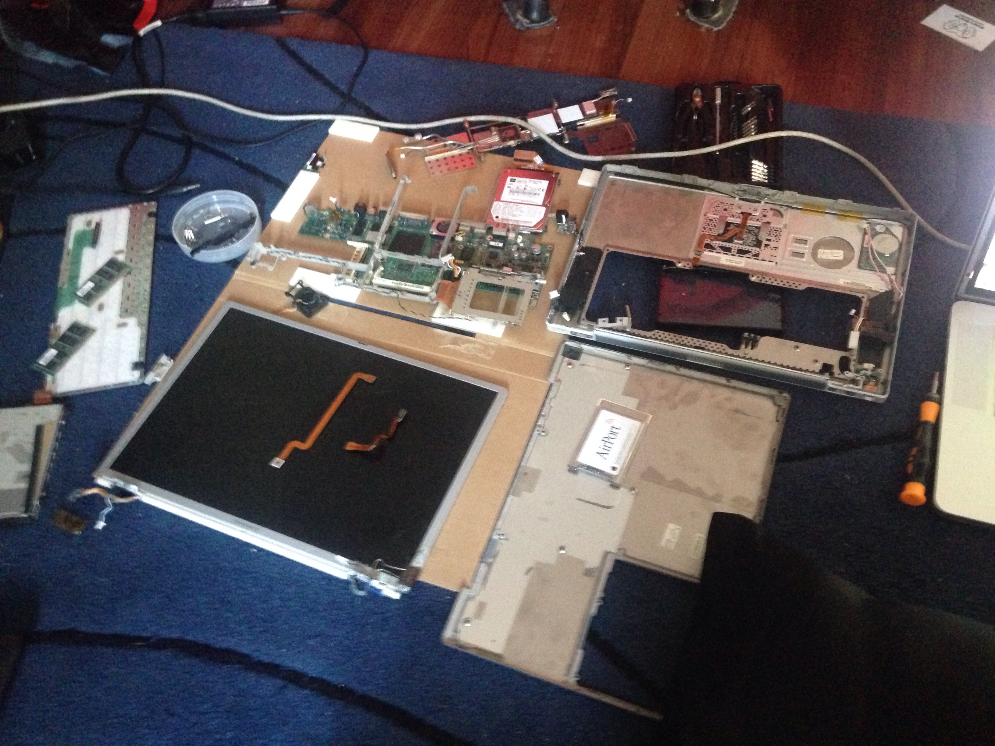

Excellent thank you so much for the help, i can't wait to have my Powerbook back!, That scary part is removing the screen display cable from the casing getting it at the right angle to pull it through (sheesh apple didn't make that fun)
Waiting on the replacement laptop now for parts, Ive got both the cables, as long as i used the lower res cable it should be fine i hope...
Some Apple tech tried to tell me it works but will fry the board, I said shouldn't it just run at lower res? he goes yes, i go so that would be less effort for the gpu so explain to me the frying?...
He had nothing,
Glad some one else has tried it, its my classic os machine and early os x machine mainly for x-wing and old school games from when i was young in the early 90's.
Well 😀
I followed the directions on ifixit.com.
Essentially if you follow those directions, you will end up dissassembling the entire computer. The logicboard comes out which lets you get to the connector.
It wasn't a big issue for me because I've replaced the logicboard on TiBooks twice.
followed the same one just a bit nervous.
No worries. Just take it slowly and proceed at your own pace. It's not hard.
If you find a connector that's really hard to get off, try a dental pick or some sort of object that can get between edges and work the edges until it comes out of the connector.
The TiBooks are fairly easy when compared to the others. It's just involved.
Some people put the screws and parts in bags according to the steps they follow, some have a mat they use and some put them in little cups. I tend to group things in my layout area based on the step and approximately where the screw or part would be located relative to the Mac.
Whatever is easiest for you. Just take your time.
