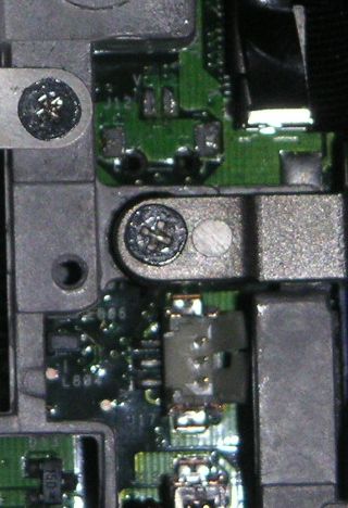

can you post a picture of what is broken?
Yep, although the pictures might not be too clear. On the photo of the board, the three-wired microphone socket I'd have preferred to break is in the bottom half, and the place where the power socket should be is the two black holes in the top half.

Just solder it back on. I bet if you took it to Apple or an authorised repairer they would hit you for a new logic board - they have no interest in fiddling around to save you money.
You'll need to use a small soldering iron, and maybe even file the tip down to a size suitable for the job.
It looks as though one of the pins has slid backwards in the plastic terminal block - you need to reposition it.
Don't use an acid-based flux, just a resin cored solder. Clean the ends of the pins (a nail file or emery board will do if you haven't anything more suitable).
And don't hold the soldering iron on for too long in case you overheat anything.
Good luck. On second thoughts you don't need luck, just common sense.
