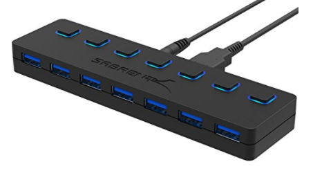

Something like these I'd guess.

I just googled these and found what I needed, exactly what I am looking for, thanks!
