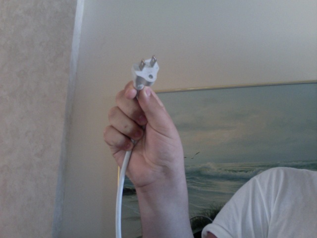

I don't know how it happened, but the power cord extension cable's circular part of the plug has come off! Can I still use it? 😱

Yes you can, but it might not be safe. The top plug is the Earthed/Ground port- so if any voltage is leaking out to the surface of your computer, you might get a shock.
I think you ought to be able to stick the pin back in- they are usually removable.
Now that's a bad idea. Moulded plus like these are never designed to be removable. You guarantee a bad connection inside the plug, and if it is ever asked to carry current, it ill generate heat. Best case melt the plug. Worst case start a fire.
Rule: Any damaged AC cabling or plugs must be replaced immediately and not used. These are like $1.99 for a generic one at any computer or electronics store (won't be white, but it will work). OR if you know what you are doing (contrary to present evidence) then cutting off the damaged plug and installing a three-prong, UL-approved replacement plug would work as well.
That is a good idea. I have seen several Earthed pins that are designed to be removable, so that they can be used in 2-pin sockets. I am not sure about the design of the port that user has.
Ofcourse now, if it was never designed to be removable, then it is a bad idea to put it back in and trying to make a connection.
Yes you can, but it might not be safe. The top plug is the Earthed/Ground port- so if any voltage is leaking out to the surface of your computer, you might get a shock..
Crazy New York...the ground plug is on the bottom everywhere I've been besides Cornell. 😛
