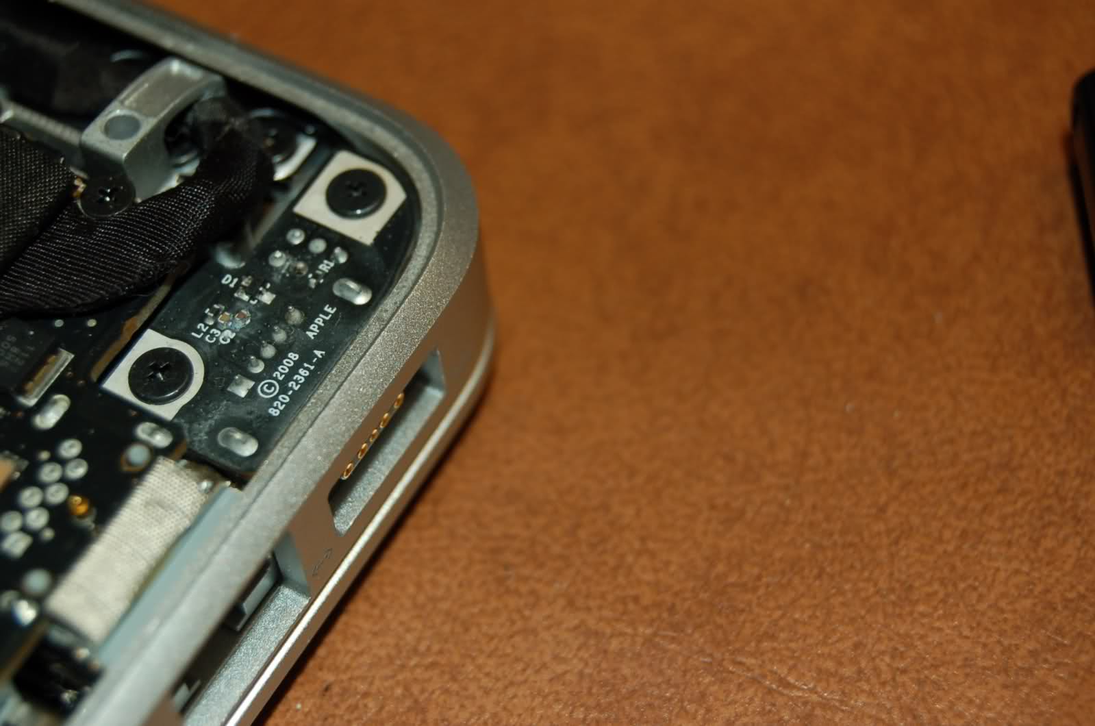

Yup, that board's toast. 😀
C2 was just about fried completely off. 😱 😛
Just make arrangements, and get it in, as they'll just swap out the board. 🙂
No, there's no water sensors, but there is residue on the board, mostly around the capacitor C2. That around the power connector is a clue though. Fortunately, the service techs probably won't have the time to make an issue of it, be in too much of a hurry to get it completed, and won't be able to tell the difference of it's origin anyway. 😀

I was thinking you got the computer wet, given water's been mentioned, and it managed to make contact with the Power board. Was this the case? Something else? 😕
BTW, water isn't necessary. PSU's can go out due to power fluctuations on the wall. Brown outs and surges can cause damage. Unfortunately, when this causes a failure, it can take other parts of the system out with it. 😱 Whether it's a tower system PSU or AC brick to a laptop, anything down line, is in danger. 🙁
yes water did spill but when i opened it up there was barely any water, a few drops that i got with my towel. and after i thought i had gotten it dry, it wouldnt charge, no sparks untill the next morning after i had left it open through the night
It doesn't take much though. 🙁
Send it in anyway. Apple will likely take care of it at no charge. Worse case, if they figure it out as user damage, the repair cost is likely not going to be that bad. Certainly not enough to justify replacing the system. 😉
hows this 🙁
kinda looks like its smoking... its not
That's normal; looks like resin from the solder.
If it's flux, that was a very poor cleaning job. 😉 😛 C2 definitely blew though. The solid gray residue (electrolyte cloud) is rather visible. 😉 Not to mention the damaged solder joints for it. 😛

If the whole thing is toast, that would make sense. But that particular board shouldn't exceed ~$50USD at Apple's repair parts cost. It's simple as heck... 😛 Then add in labor, it still should be around ~$250USD max. (Figuring $50 part, and 2hrs labor @ $100/hr).

This is normal, and if they went through the hassle of installing a sensor, that would be it's purpose. A bit more $ to make the board, but it pays for itself (and much more) in reduced warranty work. And turn a loss into a profit from the repairs. 😱 😛
I just hadn't seen the sensors on the boards or any mention of them either. But given the prospect of eliminating warranty work, to be expected. Other manufacturers will likely follow suit if they haven't already. 🙄

Probably not, but I can't be sure, as I'm unable to see. They're really simple though. Just a plastic block, with some crimp pins inserted. 😉
Do you have any Torx bits to remove the screws and look for yourself?
You'd need them anyway to do the repair, and worst case, post a pic of the other side of the board and connectors if you can't tell. 😉
