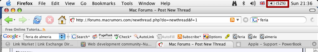

Well my problem is with my battery, I have a powerbok g4 at 12 inch, the problem which I have with the battery is that is not charging more than 52 %, stays there but if I want to unplug the AC adaptor my mac shut down but on the tot of my status is show me that is on the battery not on the ac adaptor. I will add a pictures to see how is it.

I have try the same thing but nothing, later it was stopping at 82% but I could use the battery without ce Ac, then it stop at 64 % and now at 52 % which in the end like I say if I will remove the Ac adaptor my mac shuts down.

about the calibrating thing I cannot do it, because if I will remove the AC adaptor my mac shuts down, he doesn't use the battery any more , even if is telling me that is on battery. I cannot recall a new battery because the battery was good, It has about 2 years and half and I didnt have any problems untyl now.
no the battery drop at 51 % and still I have the AC adaptor plug in. Very wired thing.
