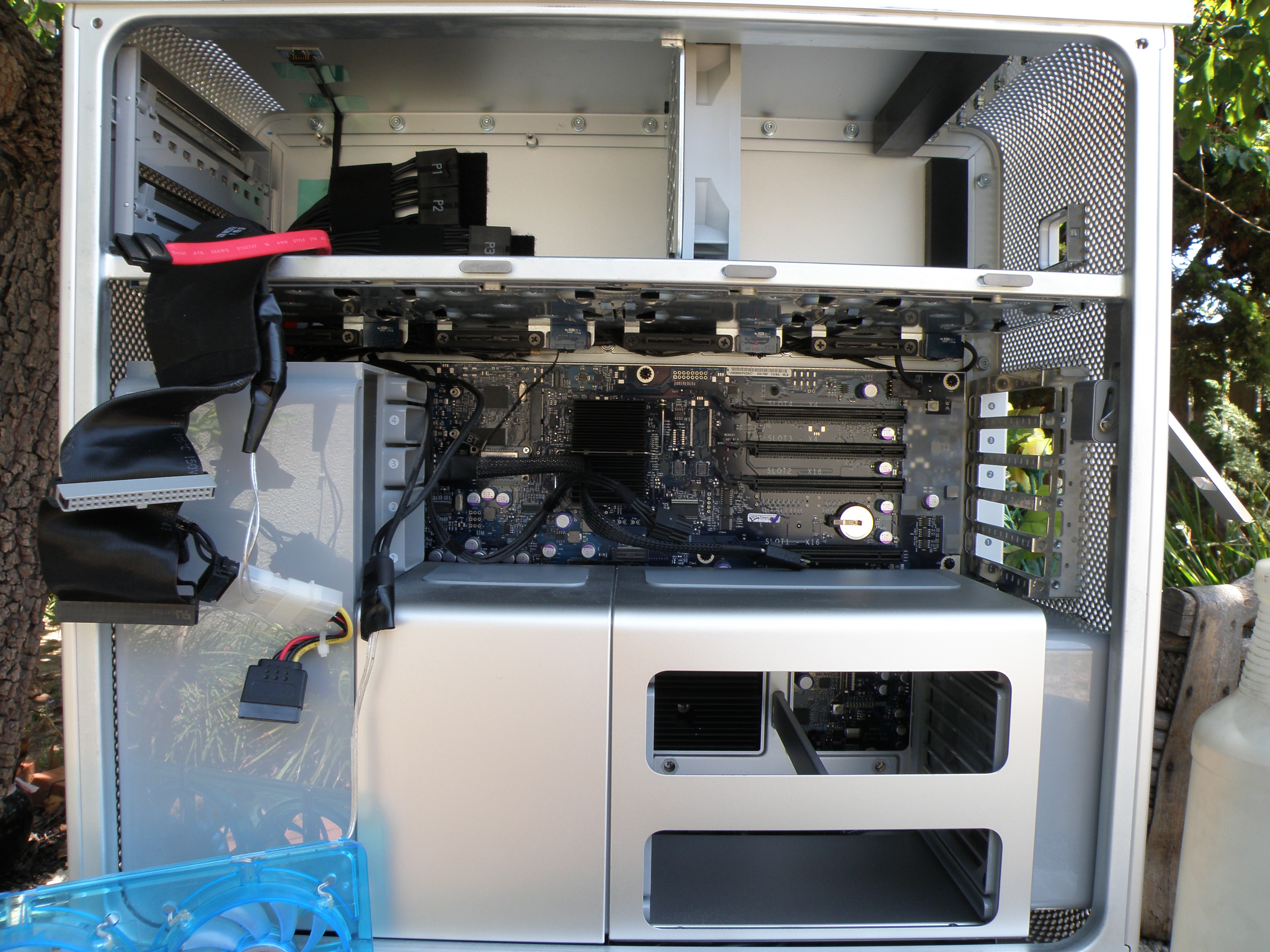

Take the Pwr Supply out and give it a good cleaning!😎
