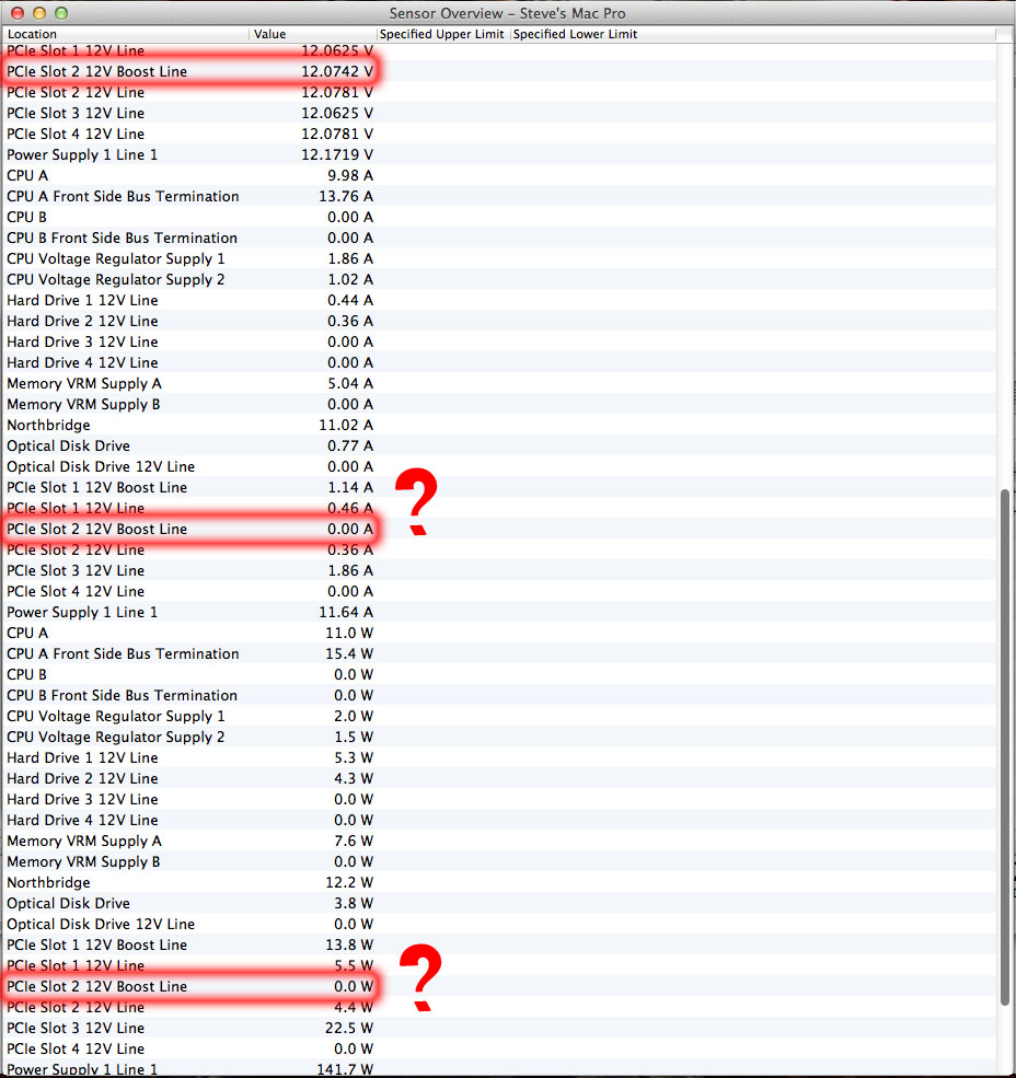

I've recently been having issues with my system, and I've narrowed it down to being the graphics card, I currently have 2 graphics cards installed in my rig, an ATI Radeon HD 2600, and a NVIDIA GeForce GTX 570. The issues are now coming from the Nvidia card (Lockups/Freeze's with graphical Intensive games). I have the card setup with the required 2 6-pin cables. So I've been assuming its an issue with the card, but I was doing some tests with Hardware Monitor, and my results make me think that maybe the issue is with one of my PCIe boost lines? I've run these tests while stress testing my machine and 'PCIe Slot 2 12V Boost line' never changes in the amperage and wattage?. Is this an issue?

That app ("Hardware Monitor") is seriously screwed up.
I tried running it and got all kinds of irrelevant and incorrect information from the hardware sensors (which I know to be incorrect). Hell, it seemed to think I had a 5th disk drive and wouldn't even list the 12V booster rails.
I did try another app (iStat Menus) which seemed to work fine. It listed the booster rails at 12.15 and 12.16V (both A and B), drawing approximately 0.29 and 0.34A. This seems about on par with a 680 GTX idling at the desktop. If I enabled iTunes Visualizer, those values jumped up to 0.79 and 0.84A.
So you should be seeing something from those sensors (they certainly work fine over here). Whether or not Hardware Monitor is actually capable of displaying those values, I dunno- I certainly couldn't get it to work.
-SC

Hardware Monitor in mine shows amperage and wattage on PCIe lines +/- accurately. Verified it with HWSensors and readings are about match.

In his case, the reading of PCIe boost line 1 is actually the reading of the PCIe slot 1. And the slot 1 and 2's reading should belongs to the aux cable 1 and 2. That's why he was confused.
It seems that he has the 570 in slot 1, the 2600 in slot 3, and no other card in slot 2 and 4. HW Monitor able to get all the reading correctly indeed, but the naming may be wrong.
No matter is there any loading or not, the 12V supply is always there. That is correct as well. If the current is zero, the overall power consumption is still zero. It means, there is no loading in slot 2, which HW Monitor call it the boost line 2.
