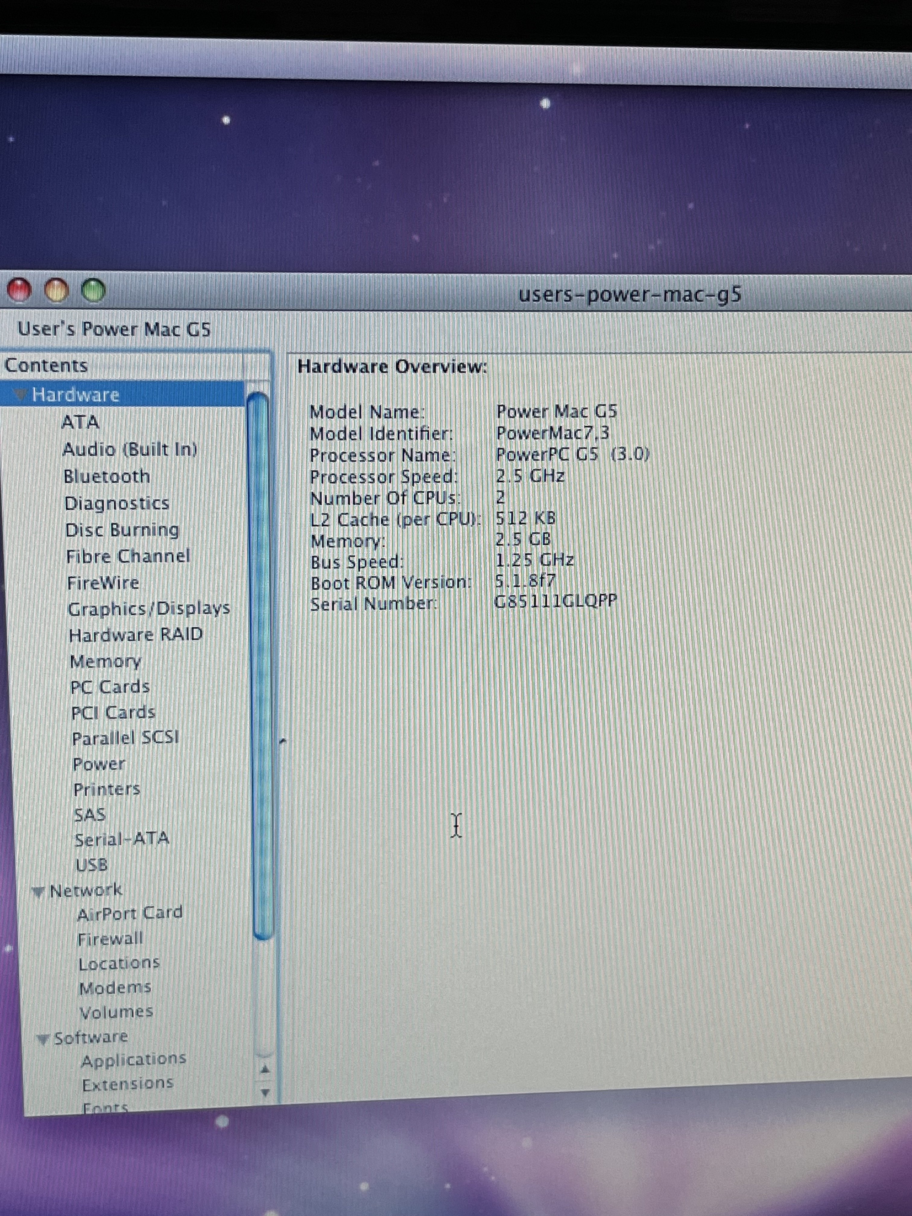

Hello, I am having my third power Mac, a 2.5dp lcs and I believe that something is missing… it’s my first g5 with lcs and I am not sure about the missing parts.

Thank you 🙏 for the quick answer, i borrowed fans (one in front of the CPU’s and one with the speaker attached) I use a molex splitter and a molex to sata power and the g5 came back to life…low noise fan, no problem at all, I will disassemble the CPU’s to see the lcs unit.
