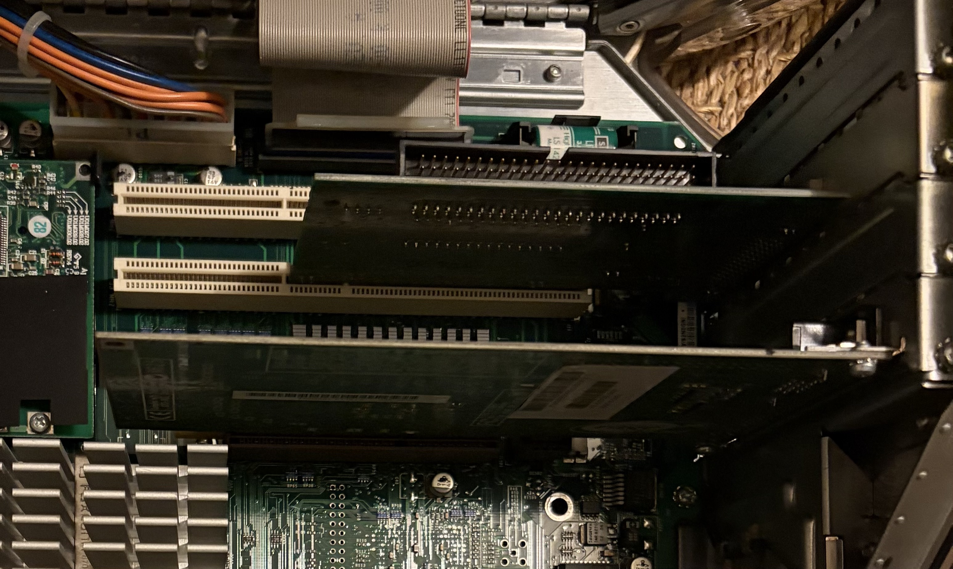

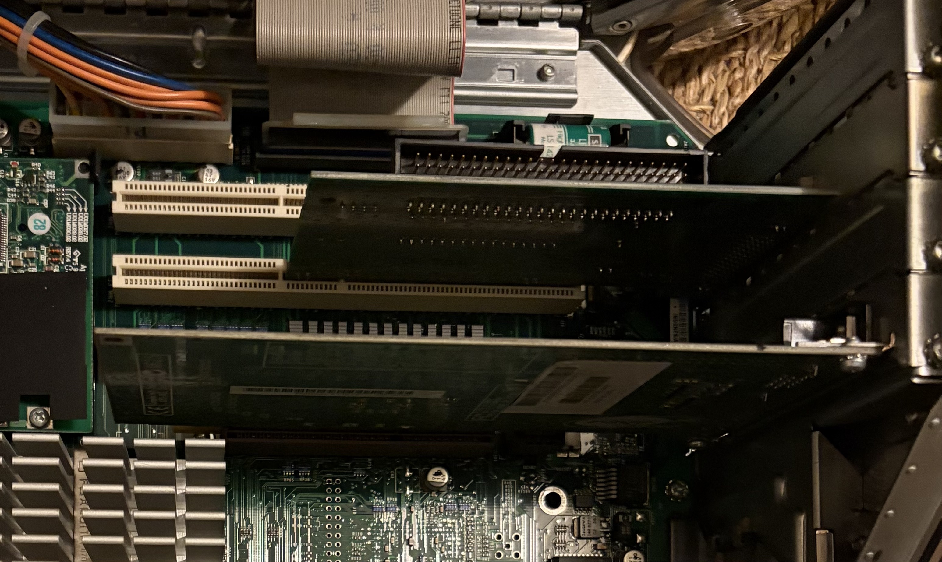

inside ! 3 PCI + one X2 AGP for graphic card

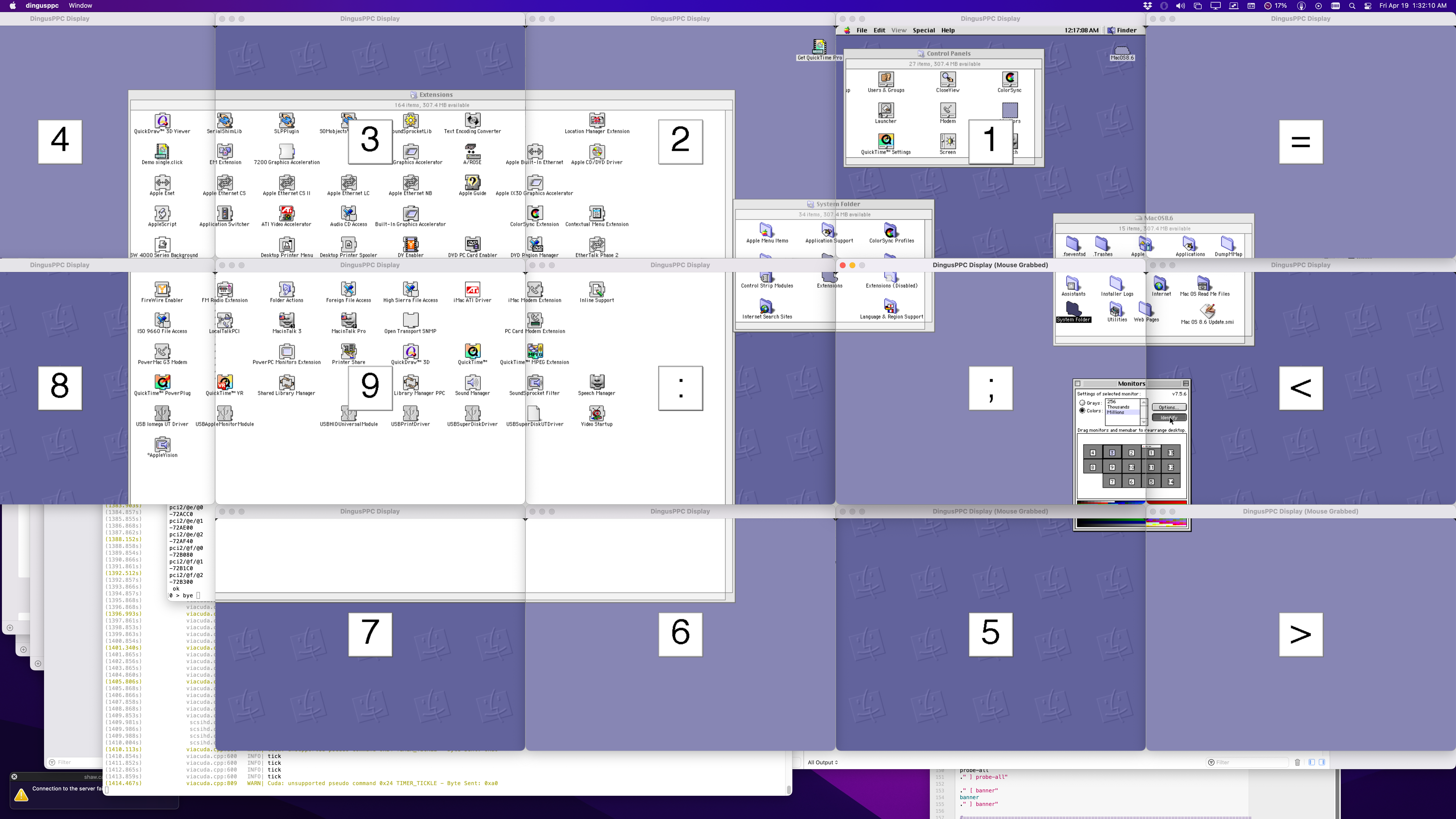

In the DingusPPC emulator, I added 14 PCI graphics cards to an emulated Power Mac 9500. PCI bridges were added to add more slots for the extra GPUs. The GPUs were 2 MiB ATI graphics cards. PowerPC Macs only have < 2 GiB of PCI address space so you can probably connect 3 or fewer GPUs with 512 MiB BARs. Double that number for GPUs with 256 MiB BARs.
