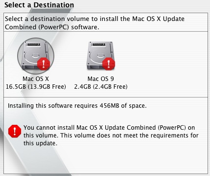

Today I hooked up my old Power Mac G4 from the basement. It's a Power Mac G4 (AGP) 400mhz. I put in an old 20GB Hard Drive I got at a flea market and it had Mac OS X 10.4 installed (Build 8A425) and oddly enough the Hard Drive name was named "G4 450mhz HD" lucky eh? So I go to use Software Update and the only updates I see are for QuickTime, iTunes, and iPod. So I manually downloaded the 10.4.7 PPC Combo Update. When I launch the Updater it says I can not install and that "This volume does not meet the requirements for this update." I have included a screenshot of this attached below.
I even tried to repair permissions but, still no luck. My only guess is that maybe this installation of Mac OS X found on this Hard Drive was a beta or pre-release version. If this is the case I'll just re-install from the Mac OS X 10.4 retail disc I have but, I just wanted to make sure before I do so. 😀

iDuck said:
What version does About This Mac show?
It says Mac OS X 10.4 - it does not say Pre-Release or anything like that. So the version of Mac OS X is 10.4.0 which is why I wanted to update.
Odd, it installed fine on my 350mhz AGP. Does your machine meet the minimum 512mb requirement? Perhaps Apple finally made that requirement *real* as opposed to just a suggestion.
Also, what is the file format of the hard drive? Is it a SCSI or SATA drive on a card of some sort?
That is wierd. You could try and look for one of the older combo updates and work from there. I would think it would mention so if it were a pre-release version.........
Maybe you need to download the earlier versions as someone has said above.
Also, it took three attempts to get 4.7 (from 4.6) to work on my 400MHz Gigabit AGP G4. It just refused to download the first two times.
I fixed it! A fresh install of Mac OS X 10.4 from the retail disc fixed it. The build number on the machine is different now, so I'm almost sure that it was some kind of beta version or earlier build than what was released. That would explain why iChat wouldn't launch. Thanks anyway guys 😀
