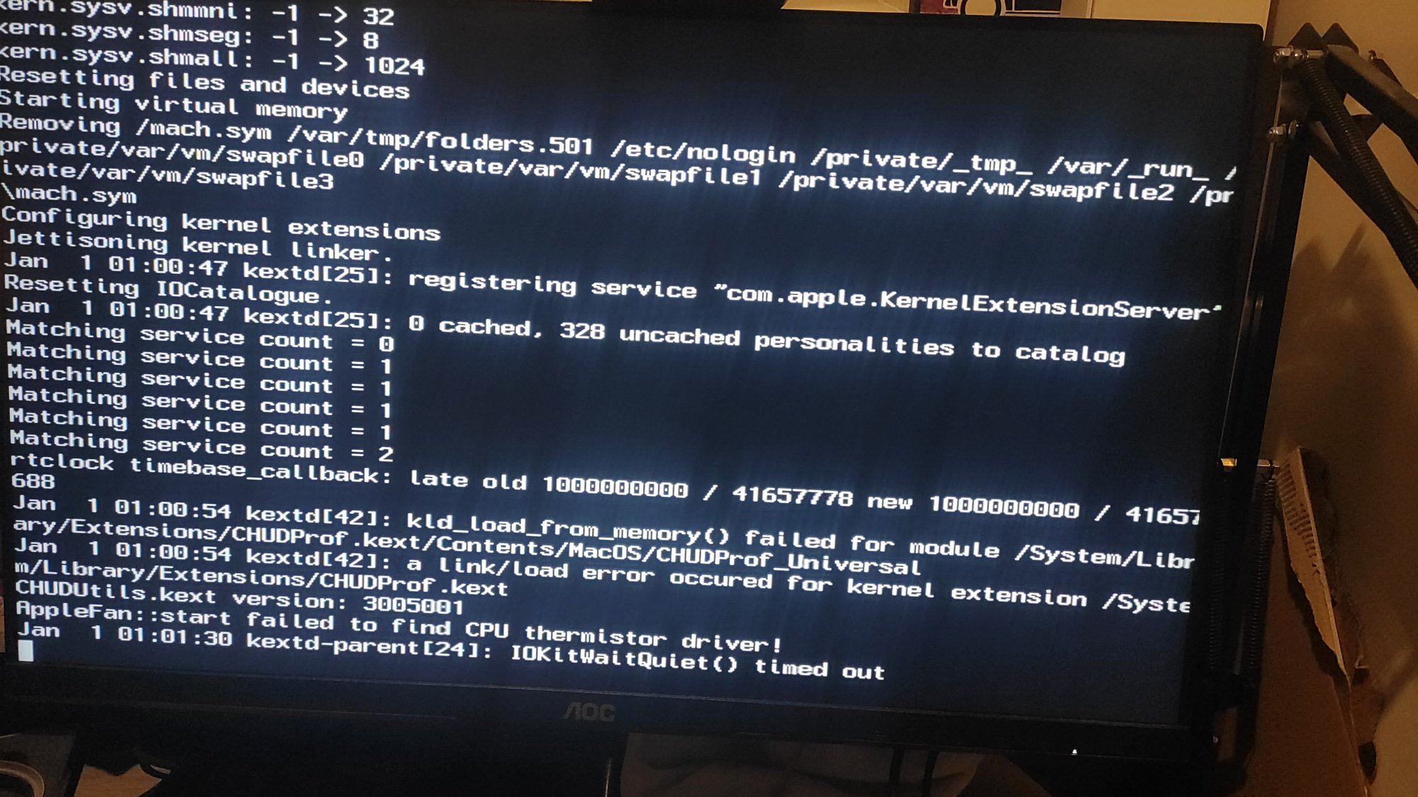

But, since a few days, it more often than not either completely locks up at boot (either showing "still waiting for root device" endlessly), or gets stuck around this stage:

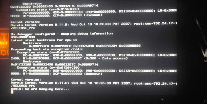

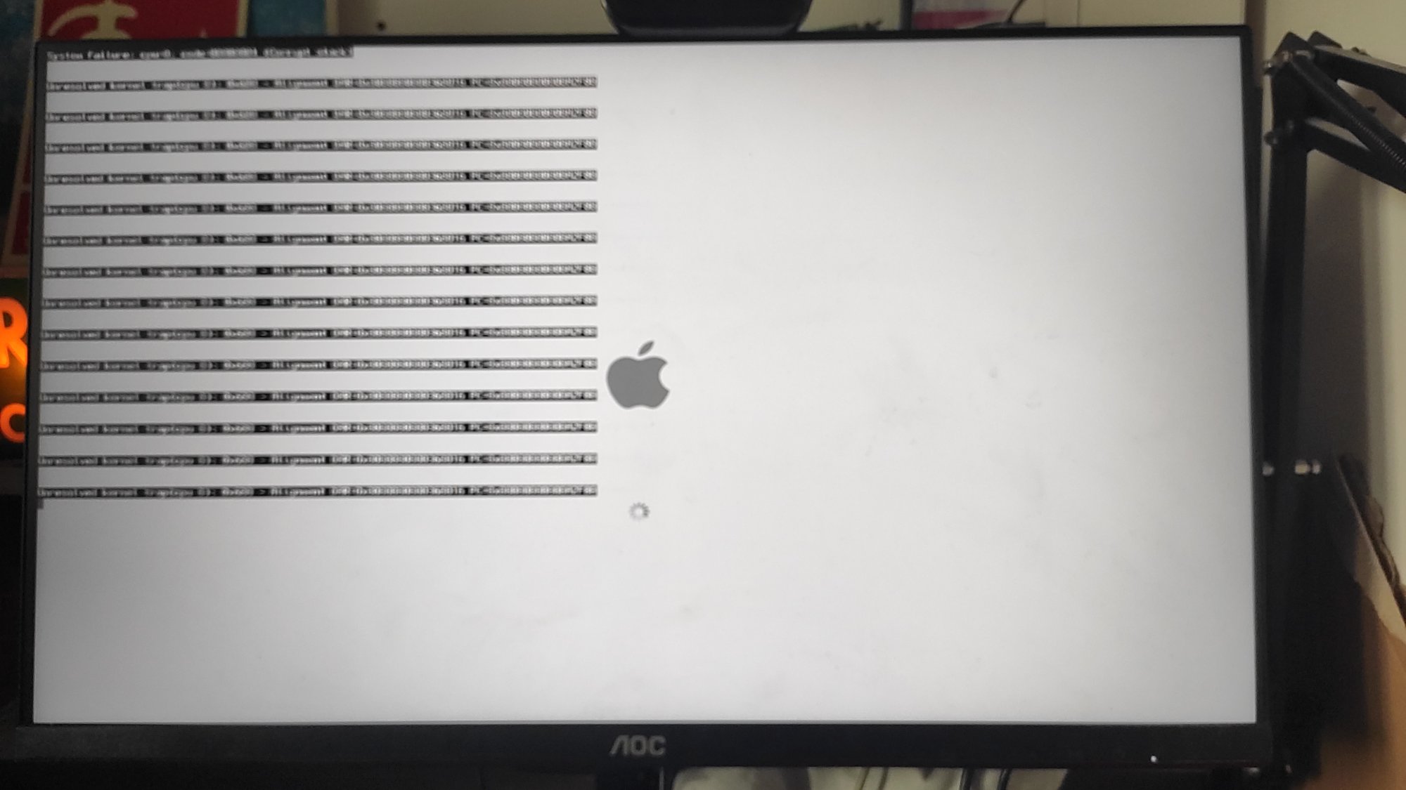

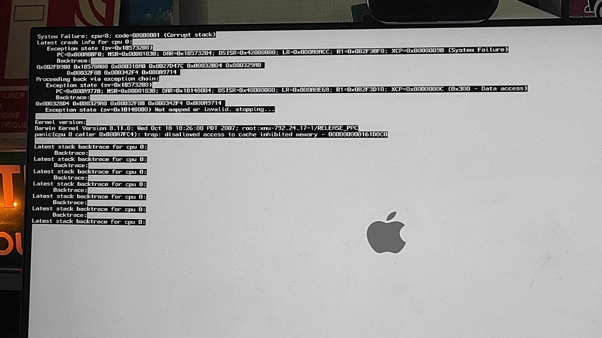

And now it's gotten worse, it hands out kernel panics like free candy, every time it's a different error message:

Hmm, it seems to point to your hdd as the ASD disk booted and ran fine from the CD-ROM. Here are some things to check (not necessarily in this order).
Since you repasted the d card, check to see if a pin bent or if there is a piece of lint/debris stuck and reseat it.
Try a different pata cable to rule out a wonky donky cable.
Remove all but one stick of known good ram.
Reset PRAM
Run firstaid in DU from a boot disk inserted into your CD-ROM.
Try yet another HDD with fresh OSX install.

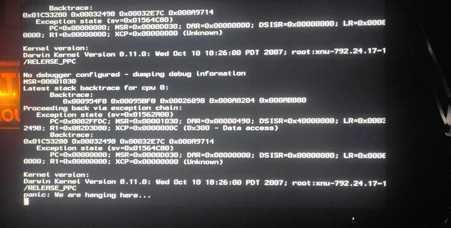

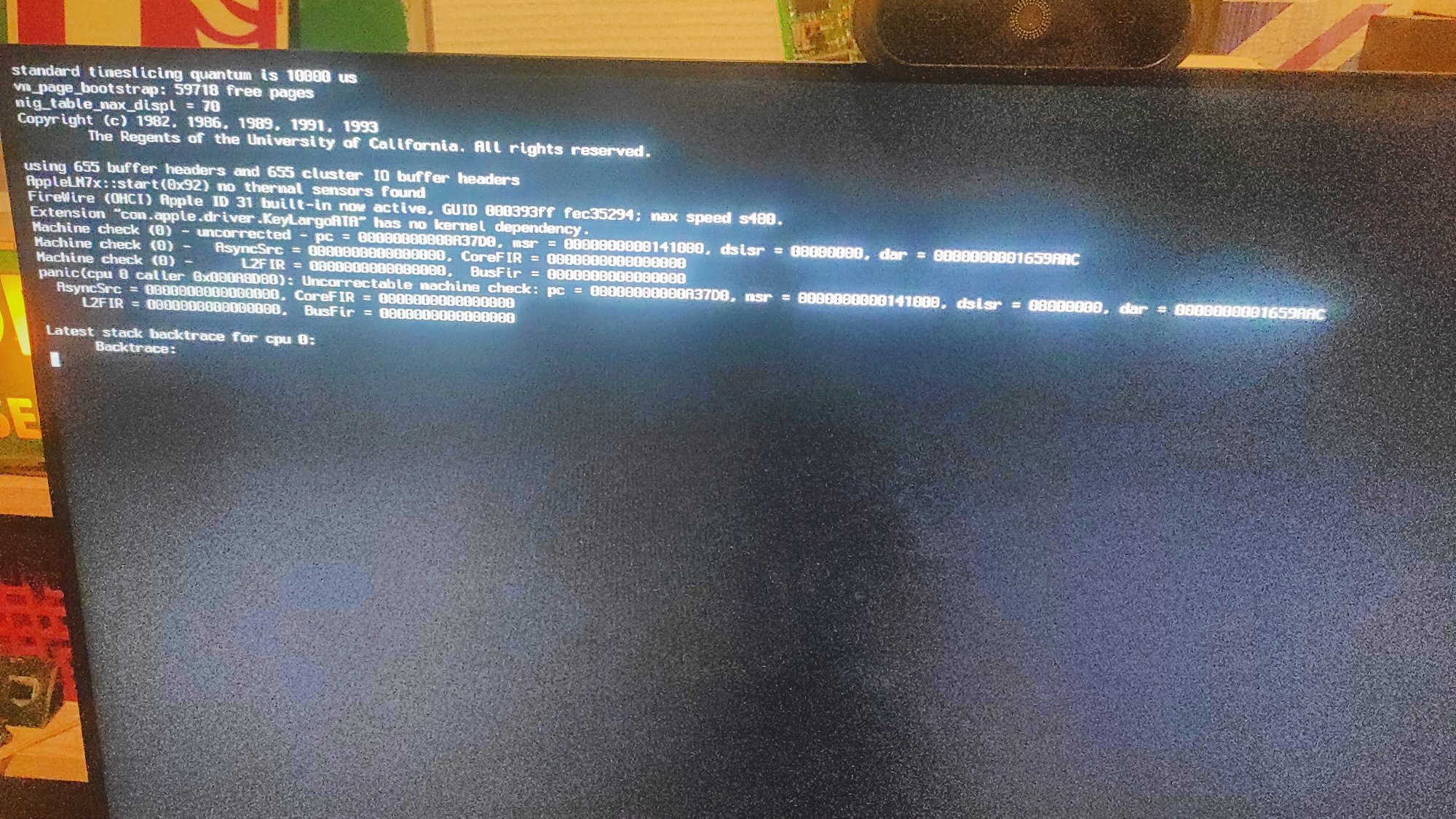

I'm trying to get it to boot, but now it's throwing this error (pardon my awful photography skills):
This is with a new IDE cable and just a DVD drive attached (trying to boot off a 10.4 disk I just burned), only one stick of RAM fitted (PC-2700 DDR1 256MB).
I don't get it, it booted fine for a week or two, then it suddenly degraded like that all out of the blue.

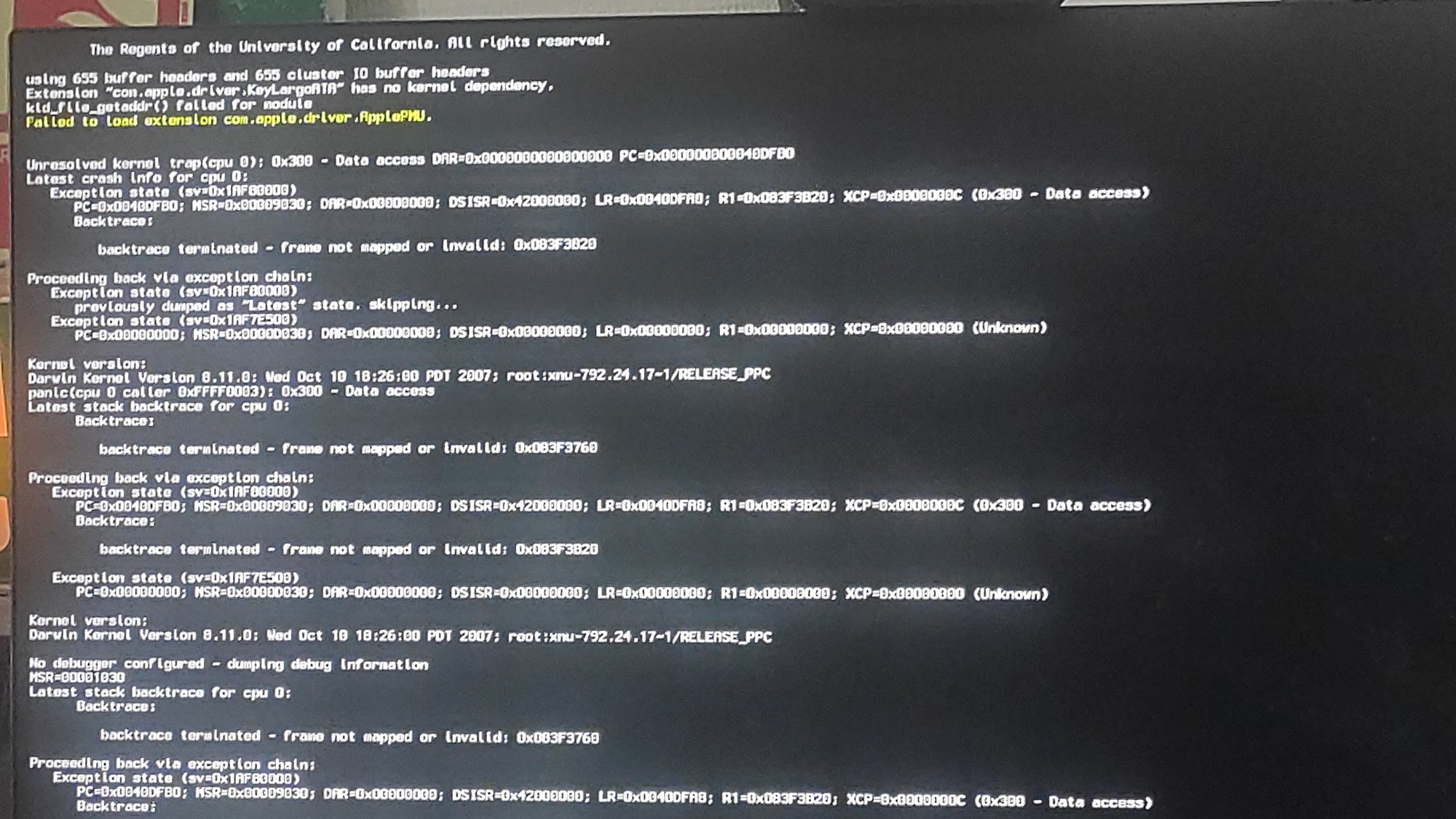

That is odd. If that is the case, I suspect the drive. Even replacements fail. I’ve got a few that have bit the dust with bad sectors as well and are unreliable.
Yeah I'm starting to think that the hard drive also is suspicious, as I saw it would hang on a extension related to ATA (KeyLargoATA) a couple of times or throw a kernel panic right after it loaded.

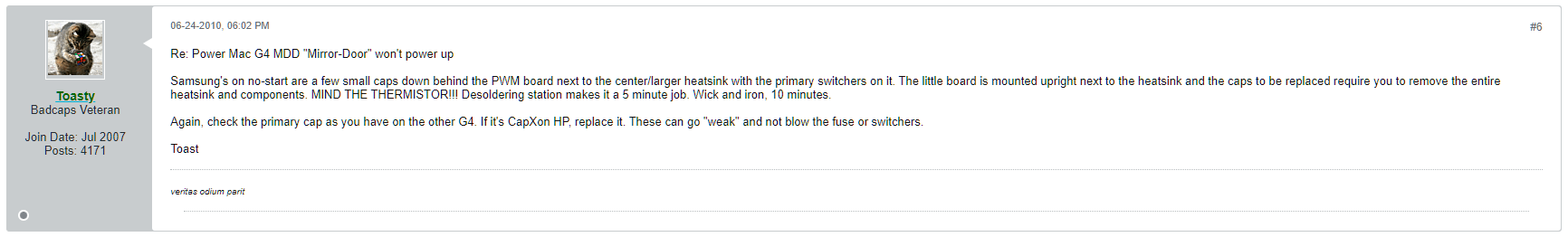

The second one (what I call the "non-starter" failure), where the power button glows when held in but slowly dims out when released.. This is the failure mode that mine seems to be suffering from, there is a lengthy thread on the BadCaps forum (I don't know if I can put a link to it. Can I?) discussing it. Of interest, a post in particular caught my attention:

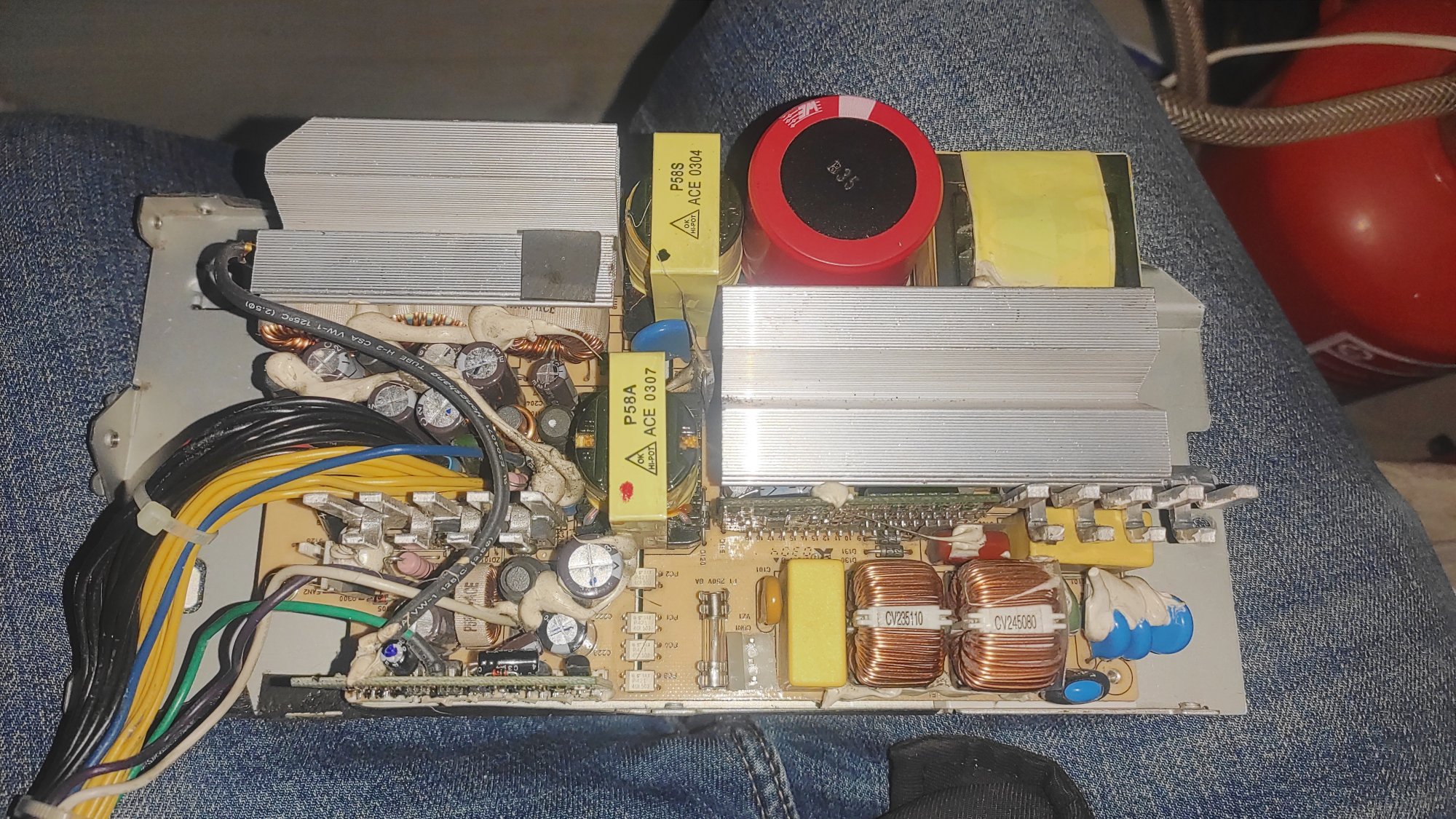

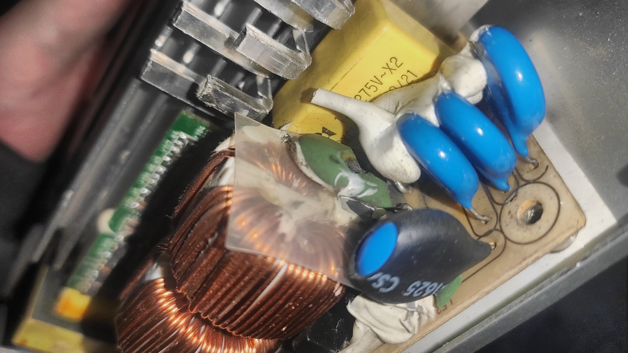

Well, I have a couple of good news and bad news.
The good news is that A) the Samsung PSUs are indeed easier to take apart compared to the AcBels (see picture one, there's headers everywhere), and B) if needed you just need to undo a couple of screws and the whole PCB goes out of its sled.
The bad news, my PSU seems to also have blown its thermistor :(
It must've failed ages ago as I don't remember seeing it spew flames or make any funny noises (besides a tiny click)
Another thing I noticed is that on the few pictures of a Samsung PSU that I could find, they all had a big CapXon capacitor whereas on mine it's a Würth Elektronik cap. Perhaps mine had been serviced at some point??
There's defo some tiny CapXons hiding in the PSU's daughterboards, they don't look bad but you never know.. (if only I had a ESR meter!) the big scary Würth cap is gonna stay (I'll still order a replacement, just in case).

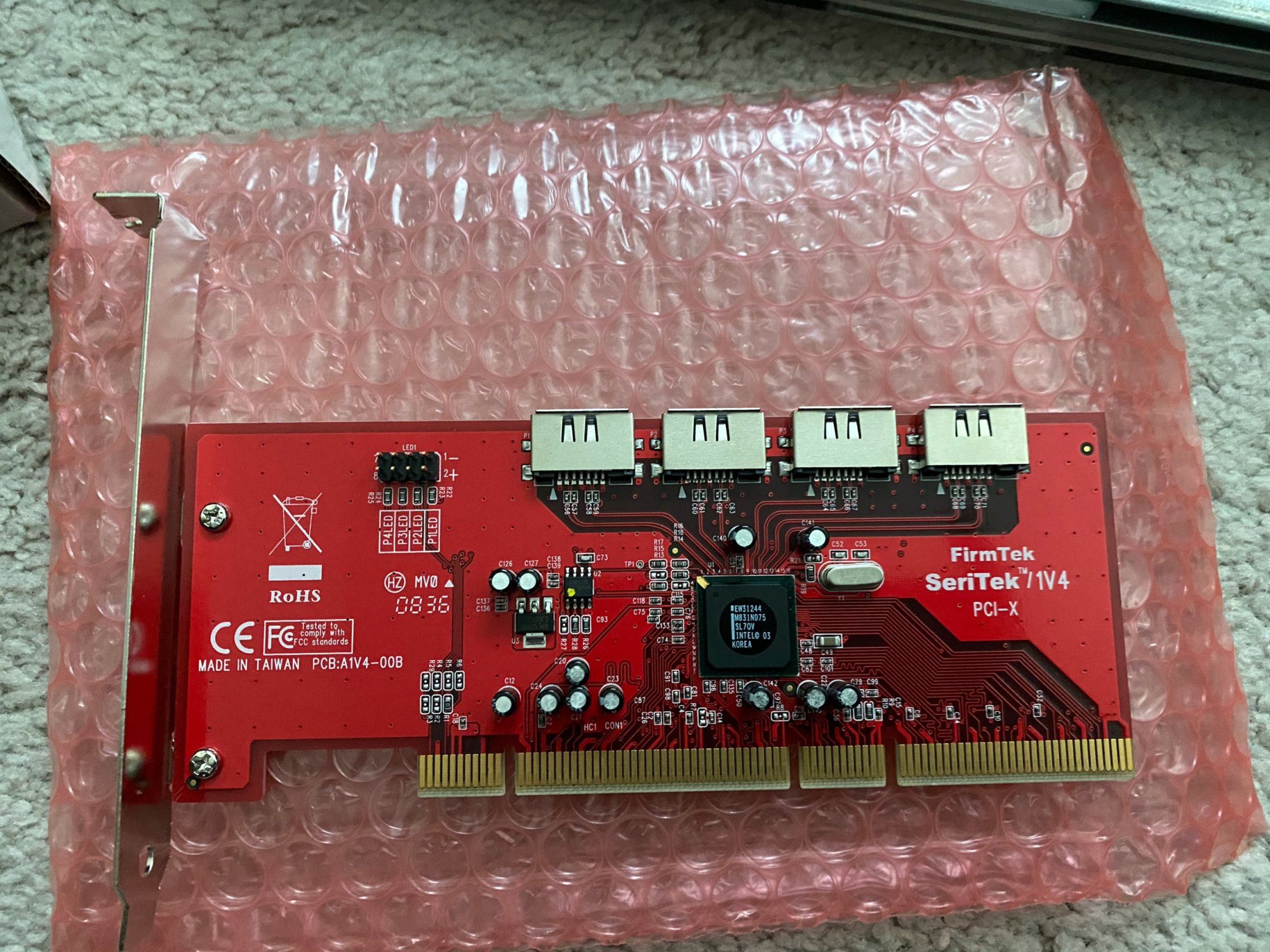

What are you planning to use for this? I mean which SATA card? (I'm personally prefer SAS from LSI, but seeking for PCI64 card was unsuccessful). It's hard to find something this type in second-hand market here in Russia.
I'm gonna use Startech adapters, until I can find a Seritek PCI-64 SATA HBA. Even where I live (rural France) finding one is easier said than done :(
If not, I'll just find one of those Silicon Image cards and flash it manually, those on the other hand I can find a few for relatively cheap
