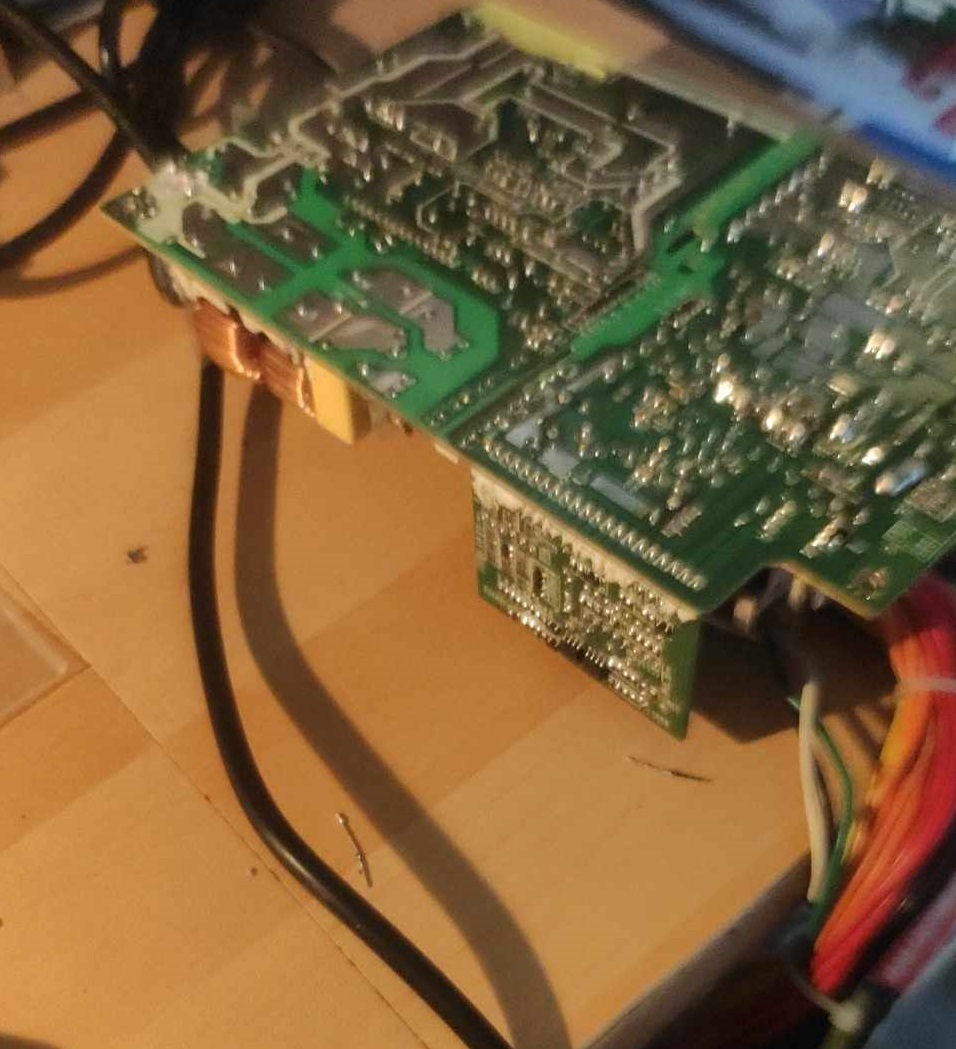

Okay, so I started recapping the PSU's main board, not without difficulties, for example, a trace lifted up, but there was a nearby unused pad that was on the same trace (before the break), so I just bent the new cap's leg and tacked it onto that other pad, there's a few caps I haven't done yet:
  • C208 (couldn't find where its solder pads are)
  • C236 (same as above)
  • C135
  • C141
  • C137
The last 3 are inaccessible without taking out the MOSFETs and the heatsink... and the soldering iron I have both is complete garbage (the tip is cracked) and doesn't have enough oomph to counter the traces absorbing heat away from the solder joints.
The daughterboards on the other hand the joints are so close together that I'm gonna need better tools to even get them off the main board, that reminds me that, I need to resolder the thermal sensor wire as it popped out of its pads too.
I'm not very confident in my soldering skills (and my pretty unreliable equipment overall), if this even powers up on the first try, I'll get the champagne out.

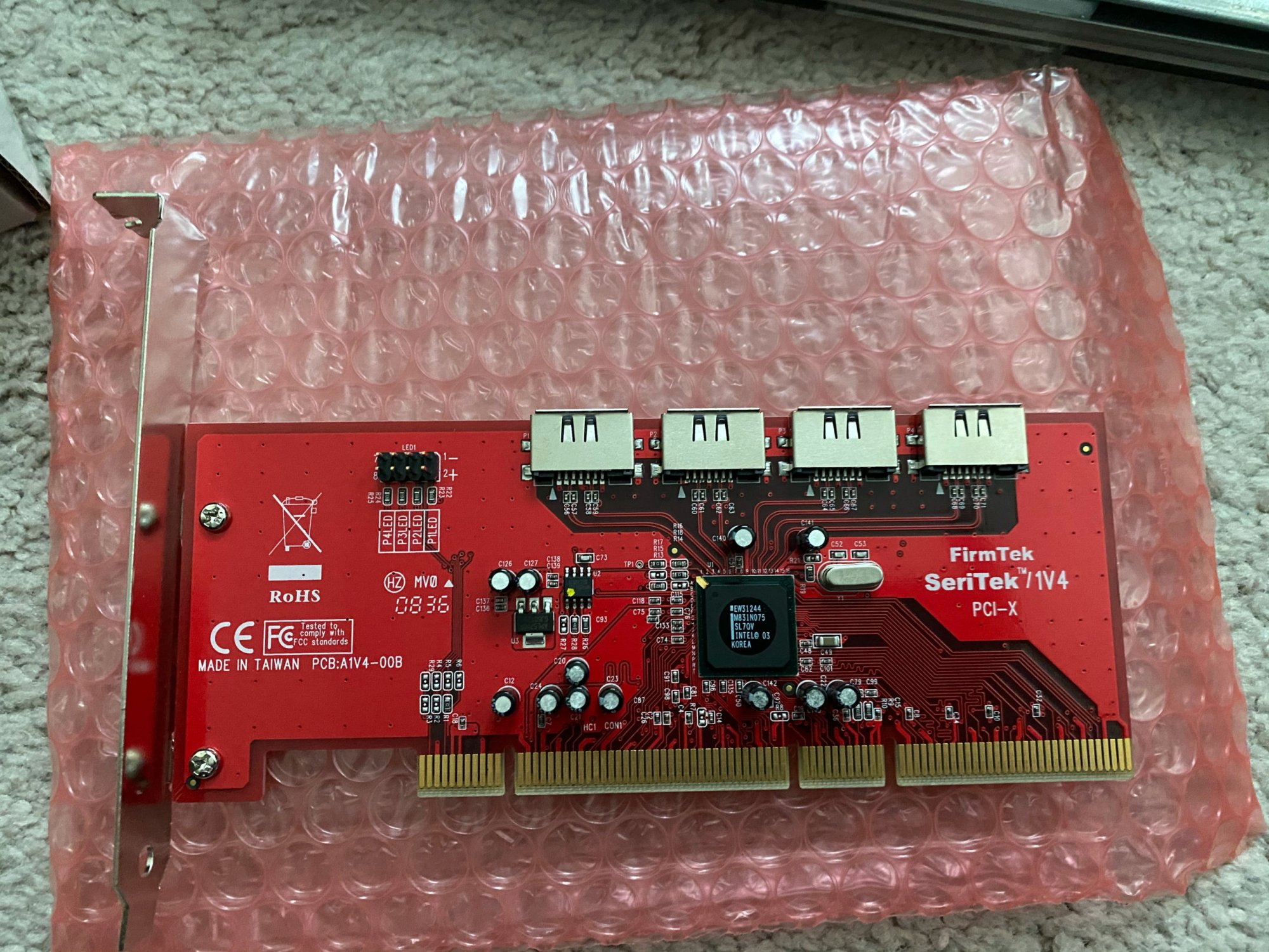

They do (did?) exist, AFAIK, they're probably the only bootable PCI-64 SATA cards (sorry I tend to mix them up with SAS HBAs) that I know of:
Apparently FirmTek still have a stockpile of these for sale but I haven't been able to find where they're actually sold
i have one of those in my mdd now. it would have been my second one but years back stupid me gave away my first one. great cards if you can get your hands on one. i was able to get mine through firmteks yahoo dodgy online store, if it is even up and running anymore
Tiny update, I received some desoldering wick... I haven't gave up on this MDD, I'm gonna order a better soldering iron as the piece o' junk of an iron that I used was a bit... questionable (not to mention the tip has a good chunk of it missing, this ain't gonna do).
Since I'll have to pull the MOSFETs, I don't want to risk using the iron I used previously.
Update:
I replaced the three caps under the MOSFET heatsink (and burned myself twice in the process) and those on the daughterboard right by said heatsink... Aaand I ran out of soldering tin.
I'd be damned if it works on first try, given how horrifying my solder joints are 🤣

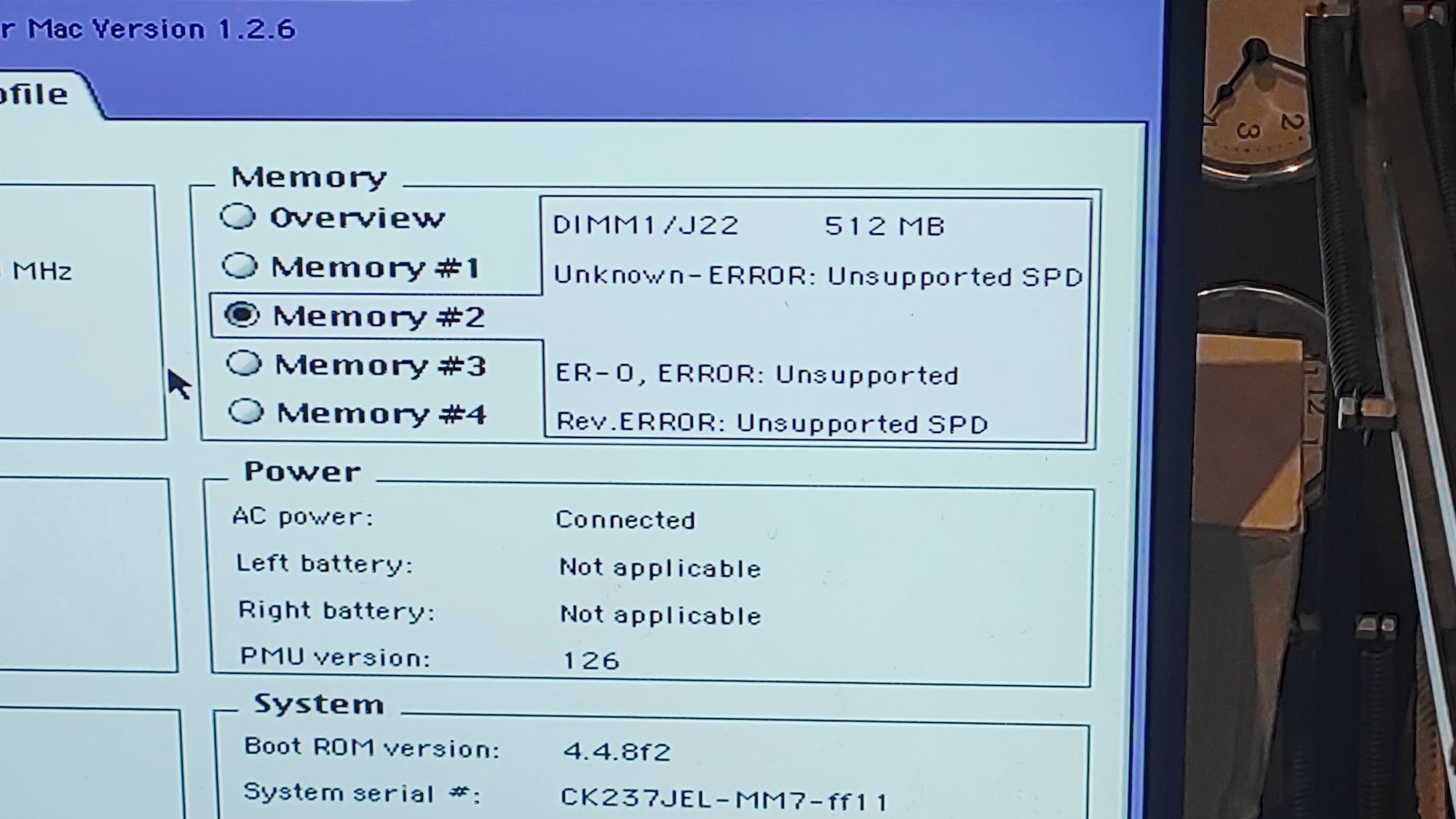

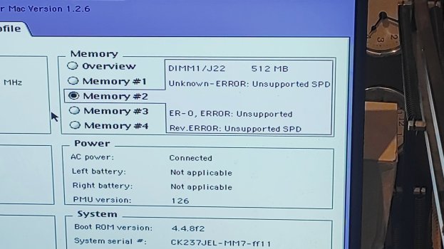

I received the ACX G4 adapter that I had ordered, aaand we're back to square one, the mobo (erm, sorry logic board... Force of habit) fires up, but won't boot off a 10.4 or OS9 disk.
Yet AHT reports no issues other than the memory DIMMs having an "Unsupported SPD".

I'm going to try this, though I only have 512MB DIMMs, besides that, do you think that would change anything?

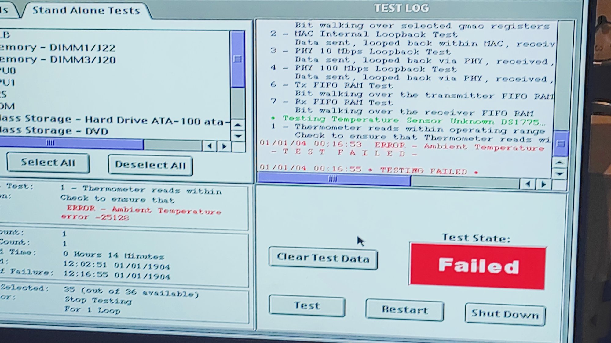

I also got a different error in Apple Service Diagnostics:

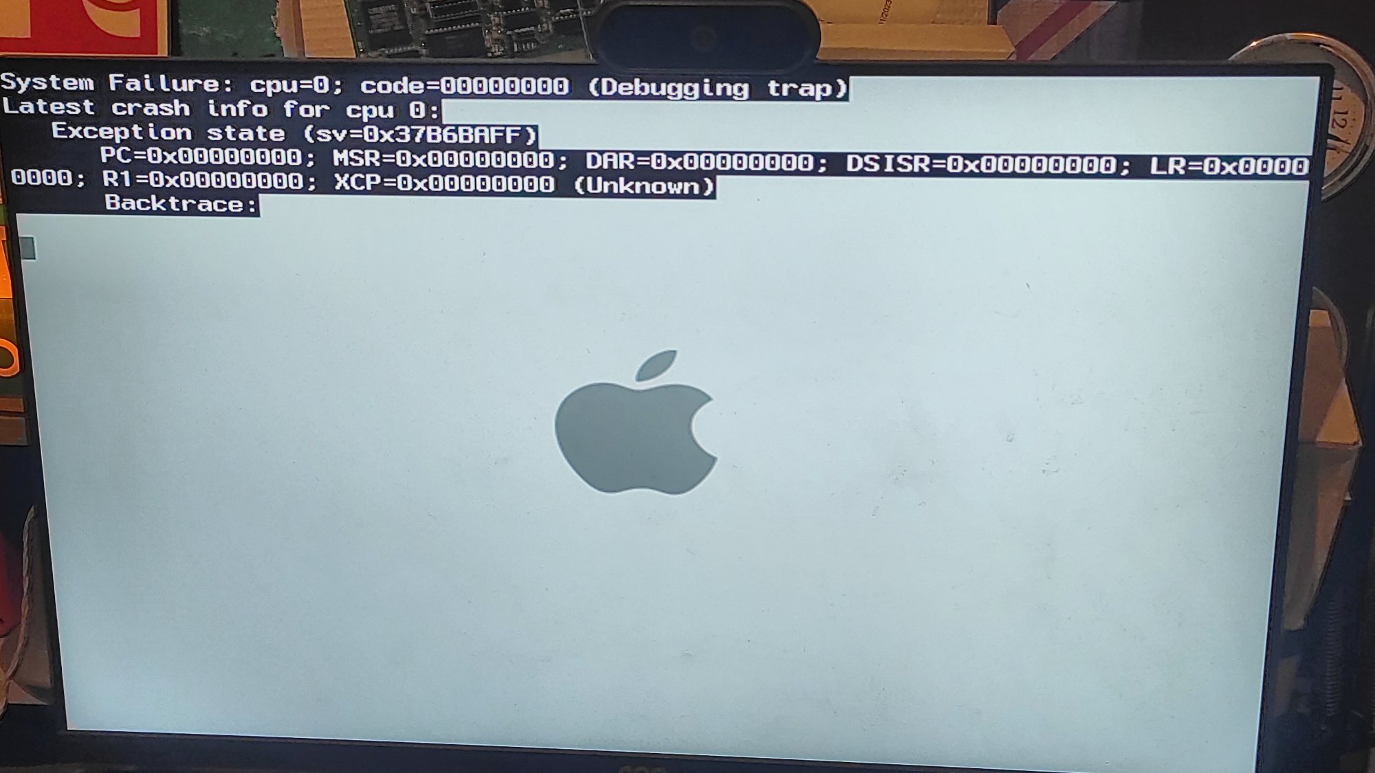

I've put the main fan directly on the heatsink so it directly circulates the air between the fins.
I got it to the point where it still KPs once in a while, but at least after a couple of reboots it fires up reliably.

I got it to consistantly (99% of the times) boot 10.4 using two 512MB modules, but when I tried OS9, it just froze at the loading bar screen.
I could get a 100% boot rate with the original Samsung 256MB module. If I add any other module (two ProMOS, one Elexir and a 1GB Kingston) -> crash.
Right now I have a 512MB Elexir module and a 512MB ProMOS module.. Seems to be running very stable, only OS9 doesn't seem to work for some reason.
The Kingston module is definitely bad as when I put it in any of the RAM slots, it either starts heating up to the point where I can't keep my finger on it for more than five seconds, or it's just not recognized.
This Power Mac never ceases to surprise me..
check the ram slots for debris, and even though it sounds weird, take a white eraser and erase the pins on the ram on both sides. sounds odd but will take the oxidation off the pins. then see if that helps in os9
also, make sure you are running the right ram speeds. a 133 cpu will take either ddr 2100, 2700 or 3300 ram. if its a 167 cpu, then ddr 2700 or higher will only work
