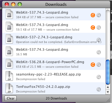

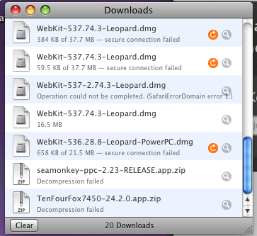

I am also getting lots of crashes in Safari, and some kernel panics, and when I try to install the various add-ons for Safari (see previous posts, nothing downloads correctly, with a wide range of different error messages.
When I was running OS 10.5.8 on a MacBook, I remember lots of Flash-based content not working, but not causing crashes. Is this just because of the PPC processor? I could try reinstalling the OS, but wondered if you all might have some insight. Thanks.

Update: I looked inside and noticed one of the RAM modules looked slightly out of place, pushed it in and this seems to have stopped the crashes and kernel panics, for the moment. The download failures are still as before, though.
