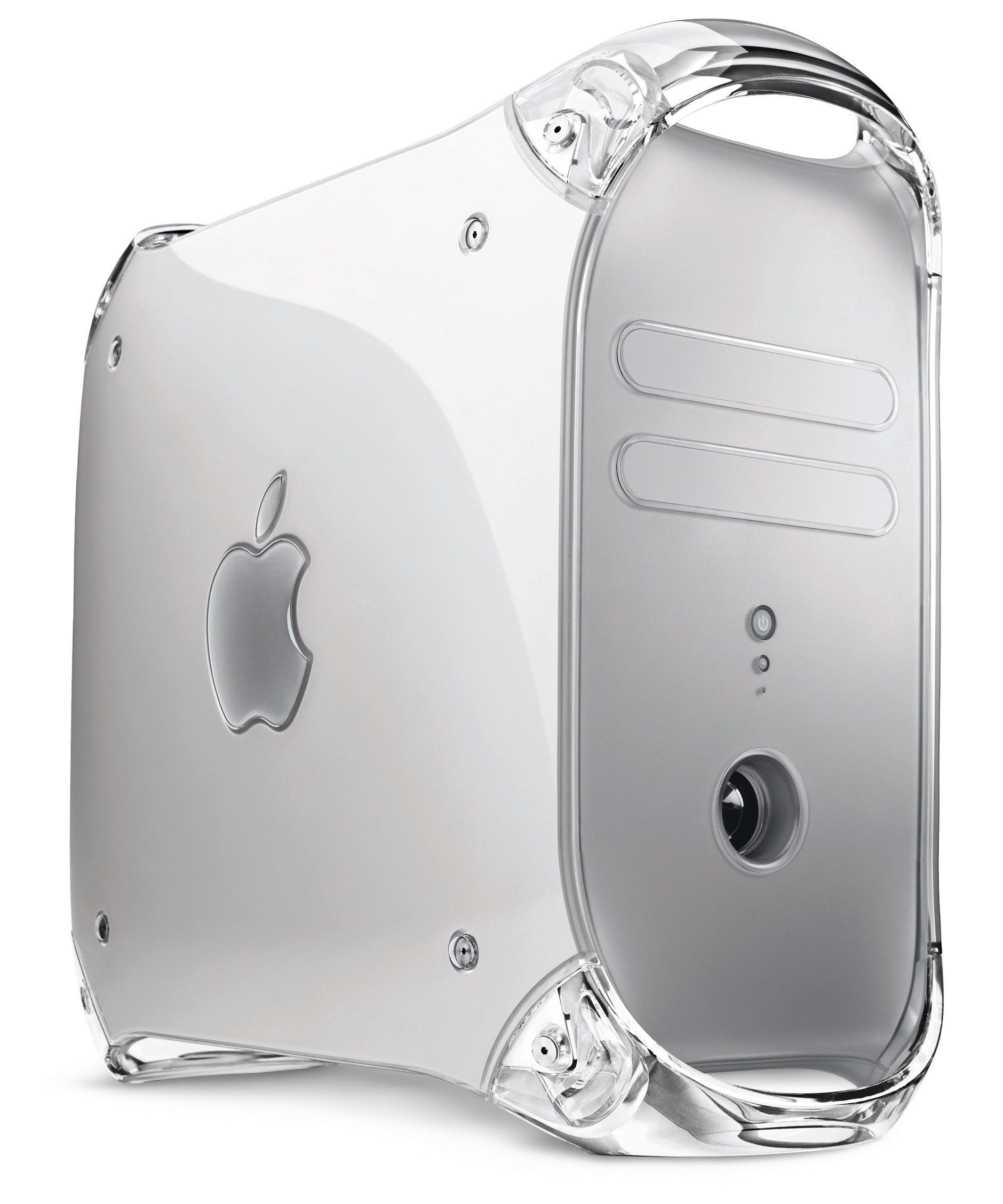

You've got a Quicksilver.
You're limited to 1.5GB ram. As far as an SSD, like I said earlier you need either a Mac PCI-SATA card or one that can be flashed.
If you are going to go all out, I might suggest an ATX power supply conversion. This is something I never did to my own QS and the demands I put on the system ended up with it burning out PCI cards on a consistent basis.
Not sure how this Mac would take to Linux, you'd have to ask the more experienced around here about that. But that's the only way you're going to get modern web browsing at any kind of modern speeds.
We can cheat on OS X by using TenFourFox, and I have a thread on optimizing that browser. But there are still limitations just because of the CPU.
As far as video, you just have to be willing to get creative if you keep OS X. @Dronecatcher does this routinely and just follow his suggestions and advice.
That might be the best and coolest designed computer ever made. Too bad Apple abandoned the design.
Yeah, I agree.
Of all the PowerMac G4s the Quicksilver is the only G4 system that I ever wanted. With apologies to all G4 owners here, the QS is the only system that looks good. All the other G4 systems are just ugly to me.
Unfortunately, I discovered that the Quicksilver's beauty is only skin deep. Apple has a very poor thermal design inside the case and while you can load it out, it cannot take the heat or the power draw. Of course, Apple never anticipated a lot of the aftermarket upgrades or that anyone would actually max out every slot. However, to me, that shows poor forward thinking. But it is what it is and the QS is still a very beautiful looking G4.
Reactions: AphoticD
Yeah, I agree.
I'm sure Apple could reengineer that case design for todays technology. If they could architect the new Mac Pro out of the old tower design they would have a beast of a super computer. But is that something Jony Ive wants to do, admit that the best designs came from the past.
Oh they could, you're absolutely right there.
As to Jony, I'd say no. He seems to always be focused on other things. It's at a point now for me that my idea of good design is nothing like his. Ive hasn't designed any Mac I've been interested in since 2008.
Ive wants look over function. "Look what we can do" Not, "Look at how great this works"

Great info guys. About the PCI slots. I just received the PCIX card it fits its entire cardbus into the motherboard without overhang and the pc boots without issue. However, at time of writing, I haven't tried installing anything like drivers or disks about it. It has a BIOS.

I just looked at my other ppc its a mirror door G4 more powerful but i have to get the PSU repaired.
The wiring to both systems motherboards from the PSU is different the mirror door has to get professionally repaird because if i did a mod to it no more firewire.
Found this info to fix up an ATX PSU but somehow I think 6Amp rectifer diodes would be more appealing considering my gigawatt PSU .... later.
http://www.atxg4.com/quicksilver.html
The only SSD I have is an mSATA and that's inside my 17" PowerBook G4.
All the drives I ever used with my Quicksilver were standard hard drives.
As far as your 1000W PSU and motherboard compatibility, the answer is no. That's why I said you might want to look into ATX conversion.
This site: http://atxg4.com/ explains things. The owner of the site also sells cables (he does the work for you). The problem is finding an ATX PSU that will fit inside the case with the same mounting.
